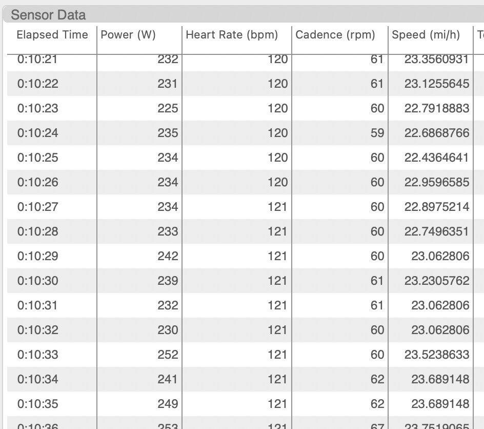

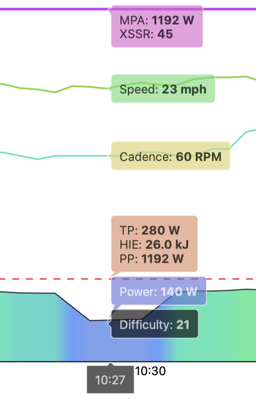

I have had this problem before and again it happened today.The xert user should never have to wonder if the data shown in xert matches what is in the fit file. I have yet another file where xert imagines power numbers that do not exist in the fit file.
Data fidelity is important. The 5-10 seconds of weird data is not significant. What is significant is the feeling that xert is messing with data that was written to the fit file.
Attached is a screenshot from wko5 showing the values, and the view from xert.
Leave the data as is, if the data is really suspect, flag the file and ask the user to look at it. I have a zillion files in Xert as do others, do you want people wondering what else has been changed?

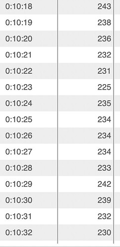

It’s from a powertap on a bike on rollers recorded directly to the garmin, not from zwift. 4 seconds of the same power number, 5 seconds at same cadence does not seem to be implausible at all. For 20 seconds here the cadence is within 1 or 2 rpm I’m pretty sure my outside rides are not like this but indoors why would this be flagged as bad data? I’m just trying to understand the logic here, not complaining.

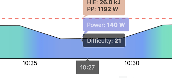

It wasn’t flagged per se. The 3 repeating power/cadence values tripped the sticky-power logic and that last one was set to 0/0. The chart shows a rolling average, hence the dip. We’d have to thihk further about how the data would indicate it wasn’t sticky power.
