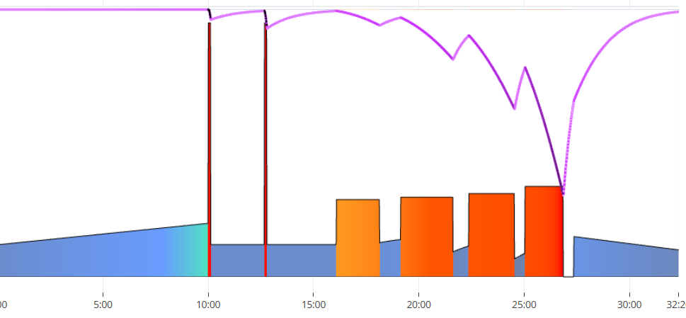

While Version 3 mentions riding under ERG control (AUTO in EBC) this assumes your signature is reasonably close to dialed in. That ensures you fail on the two intervals designed for that purpose where MPA intersects your power output and flatlines.
This one – Version3IntervalFail1 and later this one – Version3IntervalFail2
Since your signature is likely close go ahead and try it. You should fail at those points. :smiley:
Other “fitness test” workouts are best performed in Slope mode so you can purposely ride to points of failure by exceeding target watts and/or duration.
You can also accomplish the same thing by riding a similar pattern outdoors.
E.g. here’s the standard test –
Outdoors you would warm up, execute two max 7-10 sec sprints with full recovery between, then four escalating intervals with minimal recoveries and a final effort to failure.
This demonstrates why you don’t need to perform traditional FTP tests with Xert.
These type efforts can occur organically on a lively group ride, cresting a climb, charging up a steep slope, etc.
Once your signature is dialed in future BTs can be few and far between. Your signature will rise and fall accordingly based on TL changes alone (volume and intensity).
