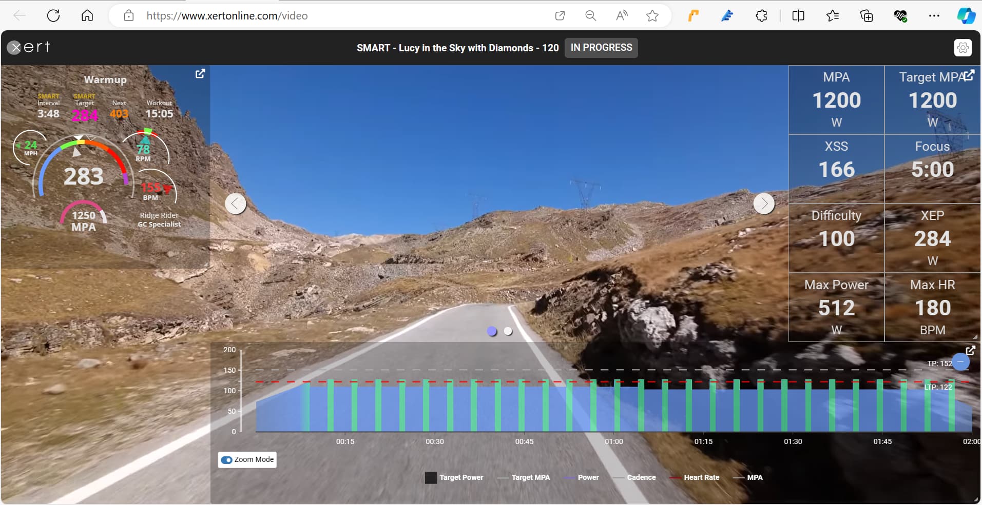

Workouts with Bike the World videos are meant to be ridden using EBC on your phone to control the workout while you watch the video on a laptop/tablet using the Session Player.
Examples:

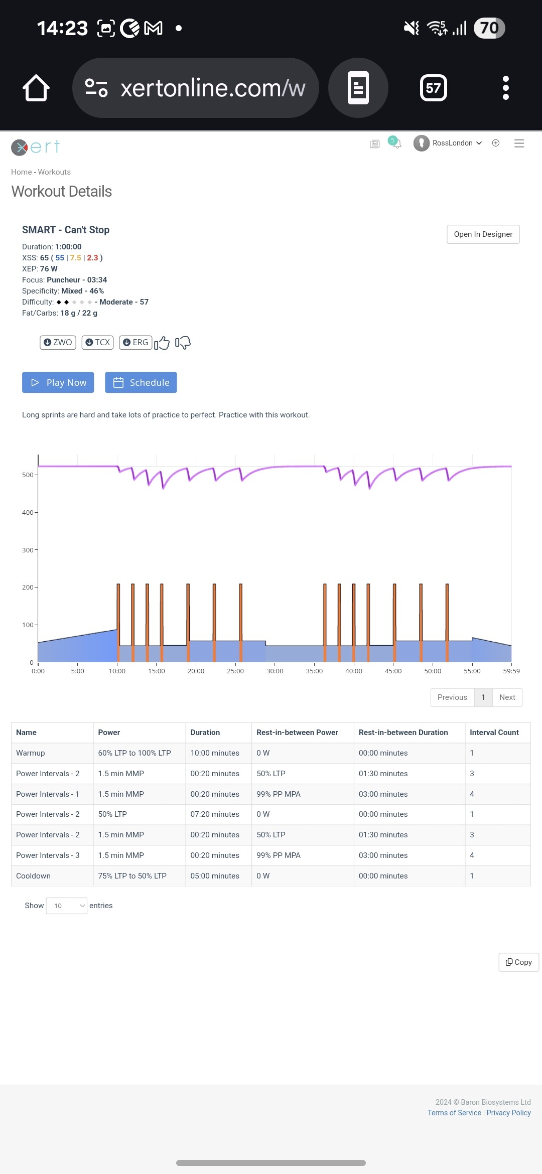

I’m finding it quite frustrating to understand which Workouts are MIXEDMODE and which are not. Many workouts do not have # in the description. Nor anywhere else I can see, so the advice given by Xert “workouts tagged MIXEDMODE work better on the EBC" I just don’t know which are MIXEDMODE and which are not.
I presume all SMART workouts are better on the EBC, but sometimes you just want to ride on Rouvy, and then having the added annoyance of Rouvy and Xert EBC not being in sync is just annoying.
Is there any plans for Xert adaptive MIXEDMODE or SMART workouts to be able to be run on Rouvy/Zwift, or will it always be the case that you’ve got to use the XERT EBC?
Thanks
Example of no description to say if it it MIXEDMODE and this seems to be the norm

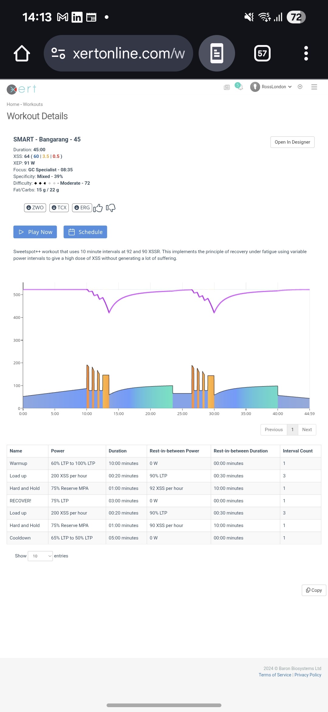

SMART intervals include a number of types not anchored on %FTP.
The dynamic type (power or duration) can often be discerned on thumbnail charts as curvilinear entries (work or rest interval). Look for XSSR or % Reserve MPA as the interval definition.
Example:
SMART Closer 200

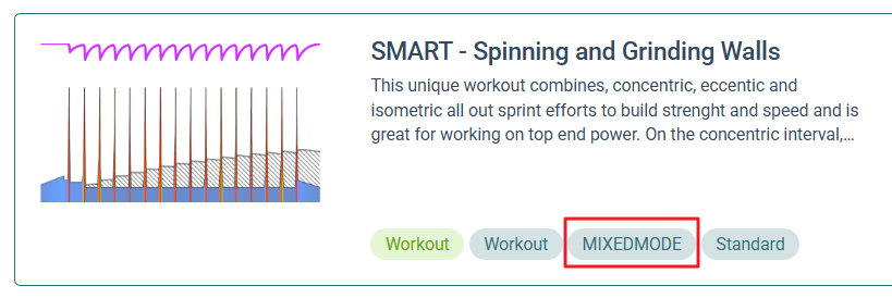

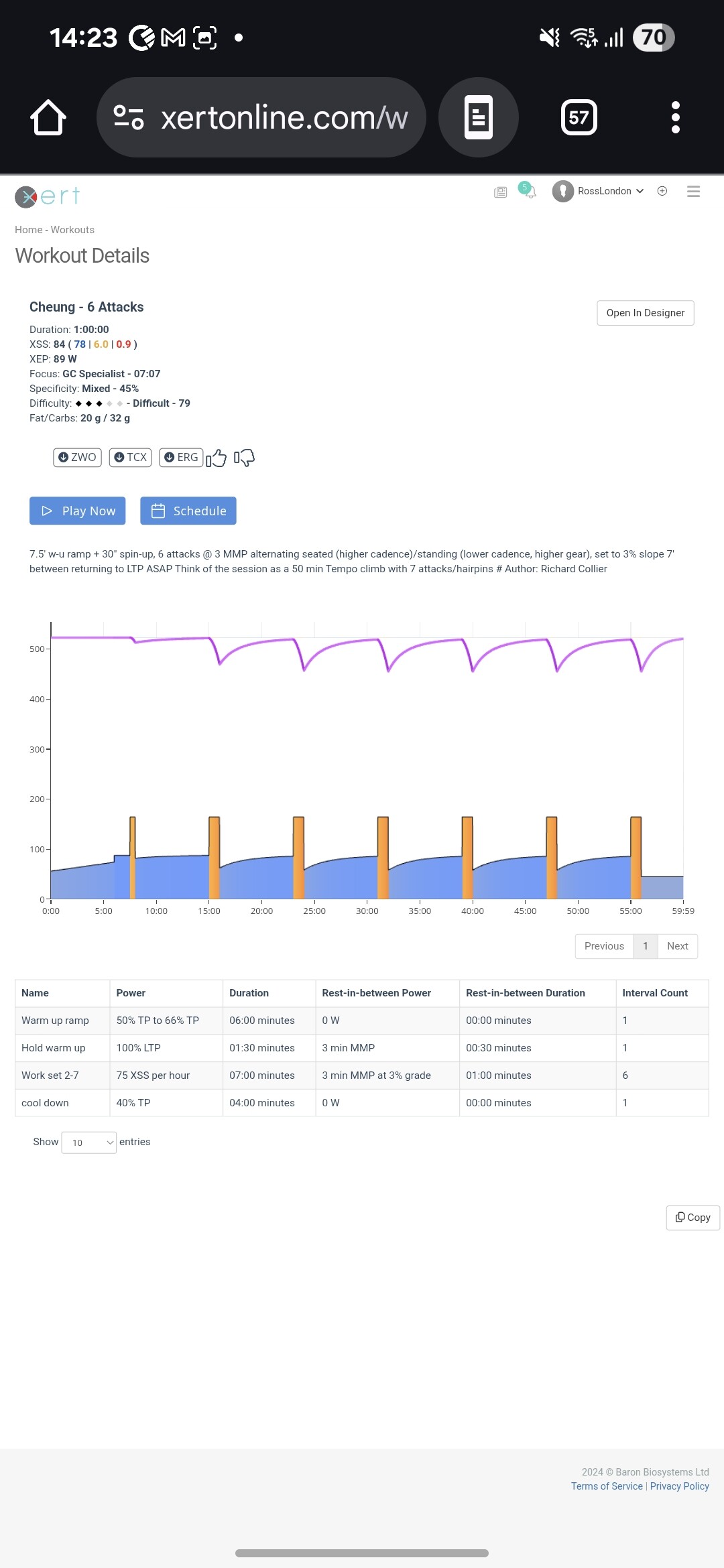

MIXEDMODE is tagged on the thumbnail view and refers to intervals that switch to Slope mode where you would use gears/cadence to hit targets. Look for % Grade in the interval defiinition.
Example:
