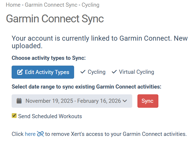

Recently, I’ve been having the following problem: When I start a workout via “Play now,” it appears in Garmin Connect, but the Workout Player starts an older one. I’ve already re-established the sync with Garmin, reinstalled the Workout Player on the Edge, and repeatedly synced the Edge with Garmin Connect, but that hasn’t helped.

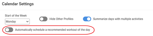

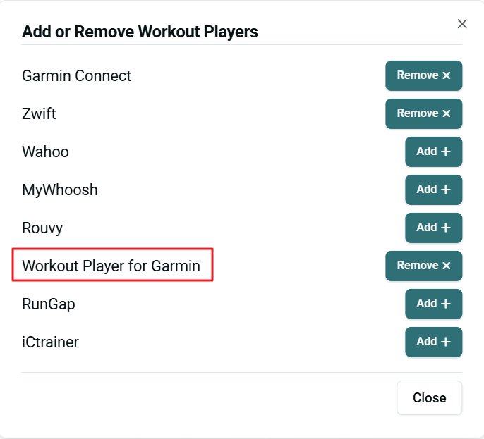

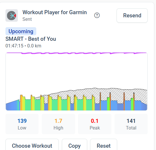

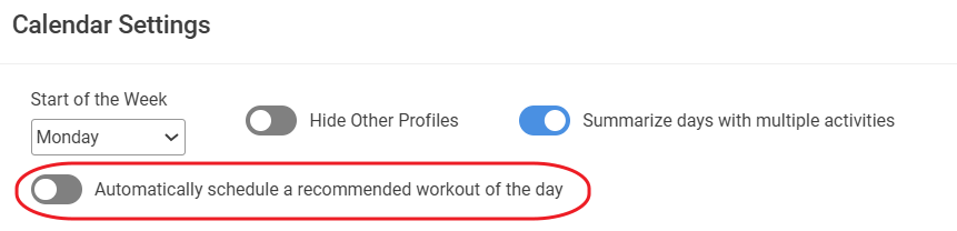

Once enabled you should be able to send a workout manually if one hasn’t been added to Planner automatically after midnight. Or add to Planner directly with [+] and it should show up under the Workout Player for Garmin box.

I enabled Automatic for testing. I will let you know tomorrow if it works for me.
Since today, I have a training suggestion in Planner again. I have no idea what caused it. I can only test whether it also works with sending to the Garmin workout player this weekend. Thanks for the quick help.
I’ve left Automatic enabled and noticed today the WOTD is listed under Today | Planned, but the workout does not show up under Workout Players for EBC or Workout Player for Garmin. However, it is listed under Garmin Connect and Zwift.
