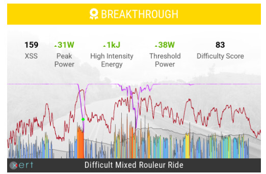

This is the activity breakthrough in question
This wasn’t the case
I disagree on this point, all you have to do is too look a the power curve generated by Xert. On the fatigue issue, it’s possible to surprise yourself with a bit of taper, but 25 watts is too much.
