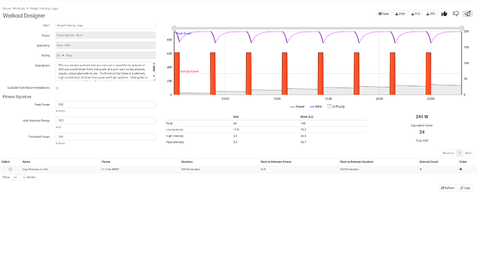

I have lifted between once and three times a week, currently twice a week. A normal session might be something like 5x3 Squat, 3x10 Deadlift, 3x15 Accessory.
What I was hoping by including this workout is that XERT would rearrange when I do intensity on the bike, but it seems to think that this work replaces intensity.
Similarly when XERT reads my garmin track of the workout, it just gives me 30 endurance XSS, which isn’t really what I’m getting either.
What I want is some consideration of the work in my overall load, but not sure whether to keep the garmin 30xss or delete it an add this for 15ish xss.
So far my choice has been to leave it at 30XSS and just let XERT reduce my daily bike workout by half an hour so I do 60mins of endurance vice 90mins of endurance.
Wondering what you ever did with this. Your option would not make you yellow the next day…
Makes sense. Keeping it at 30 XSS and letting XERT adjust your bike sessions sounds like a reasonable way to account for the lifting without overloading.

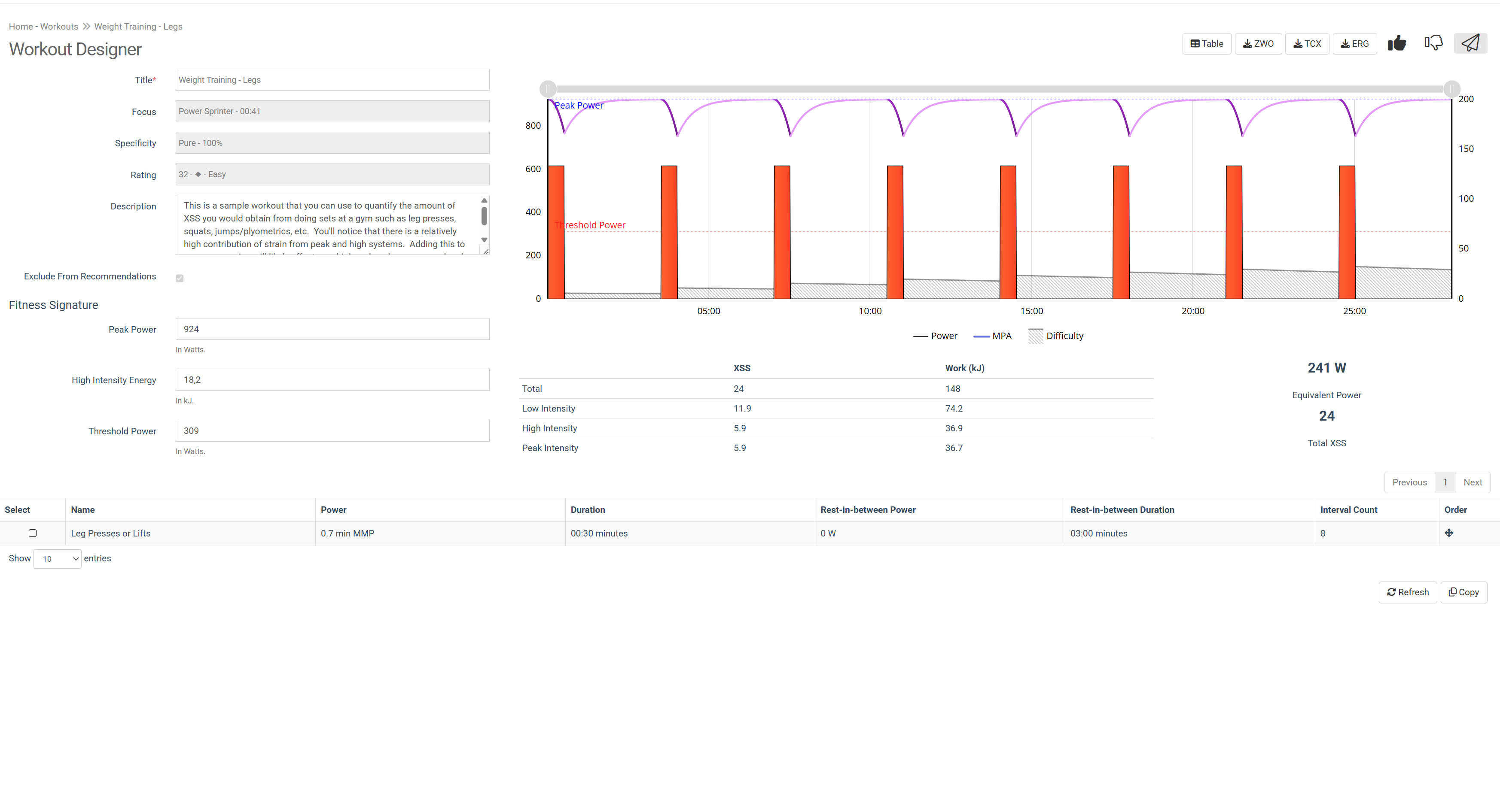

Maybe this is a dumb question, but how can I save this modified workout? I’ve modified to 8x10sets.
Answer: Copy and Save

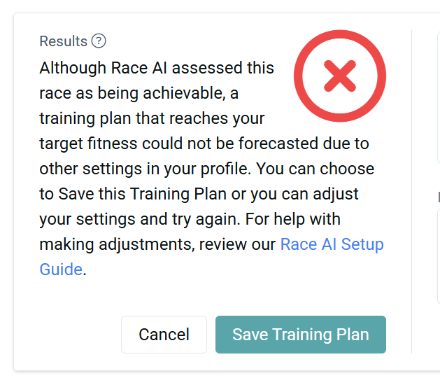

After applying this modified workout to past weightlifting workouts, the Race AI stopped working. Any ideas why? (Target is in May and was previously achievable… even if i lower the readiness to 5 I receive the same error)
