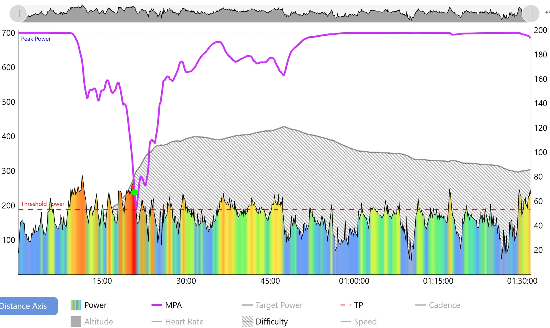

Sounds like you had everything set up correctly to me. Technically speaking, all you need configured in the Xert EBC app is a Power Source. Small differences are very normal. But the difference you’re describing is significant. Perhaps you left out more information? Can you share an MPA chart from the ride?

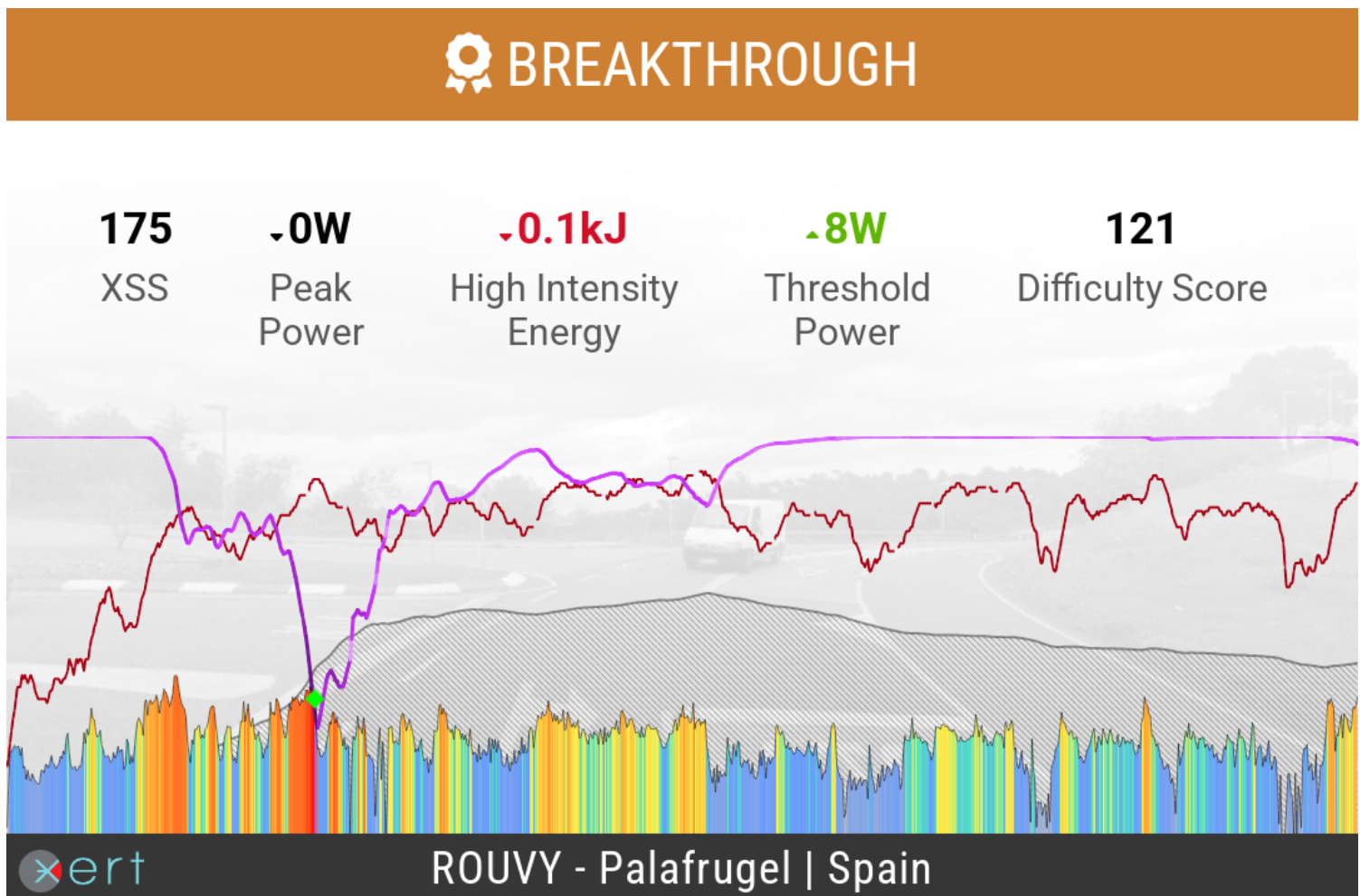

Was the ride a breakthrough activity? When you get a Breakthrough or a Near-Breakthrough, Xert recalculates all the data from the ride (MPA, XSS, Difficulty, etc.) using your *new, updated signature.
See our latest Q&A video for an answer to a similar question :slight_smile: I linked ahead to the relevant question: https://youtu.be/_qmigG8TapU?si=fW_X7ACs-bKhyBhr&t=1378
Ok. That makes sense. There was a breakthrough of +8 W TP on the ride.

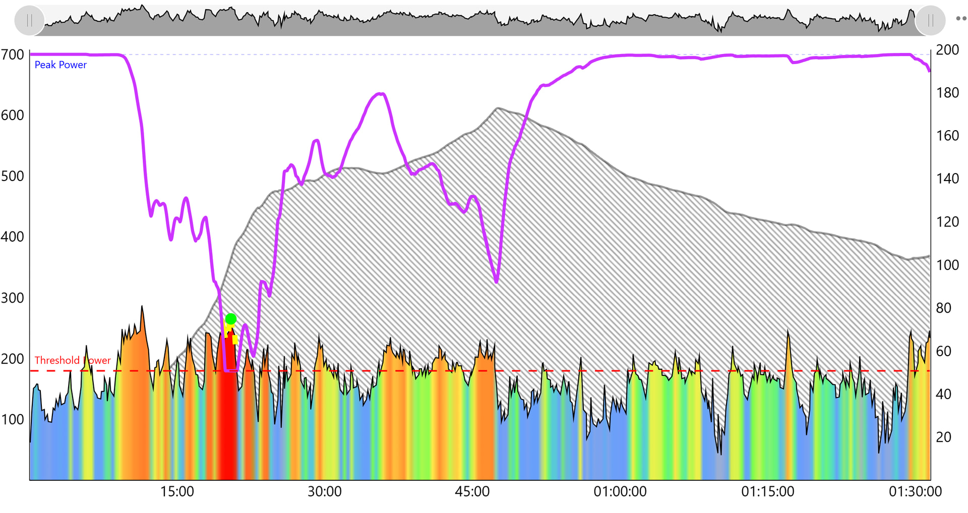

Also I didn’t know about the option to view the chart using the previous fitness signature. Thanks!
(chart using pre-breakthrough fitness signature)
