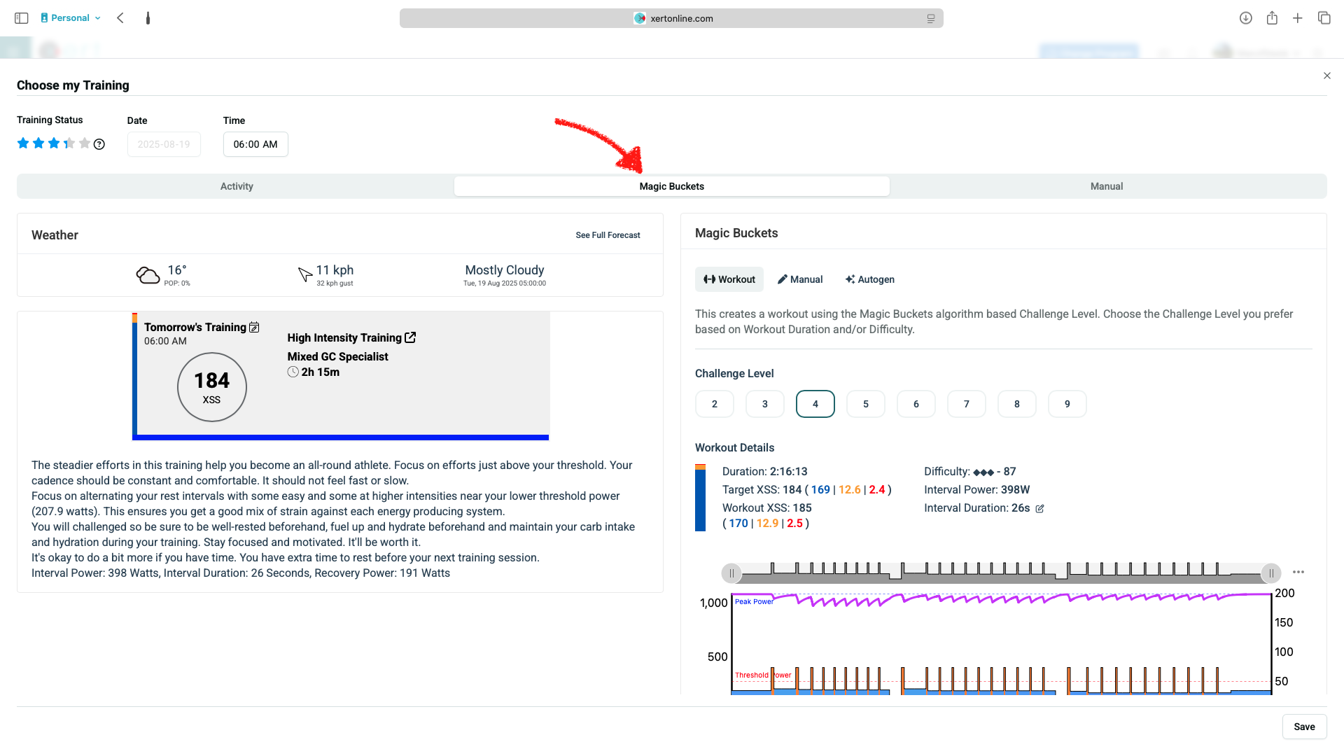

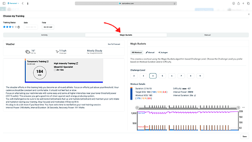

  1. Go to your Fitness Planner on Xert
  2. Open the Magic Buckets tab from the Recommended Training modal:
  • If you’re using XFAI: Click the ‘Magic Buckets’ button on the forecast placeholder
  • If you’re using XATA: Click the “+” button on a day, then select the ‘Magic Buckets’ tab

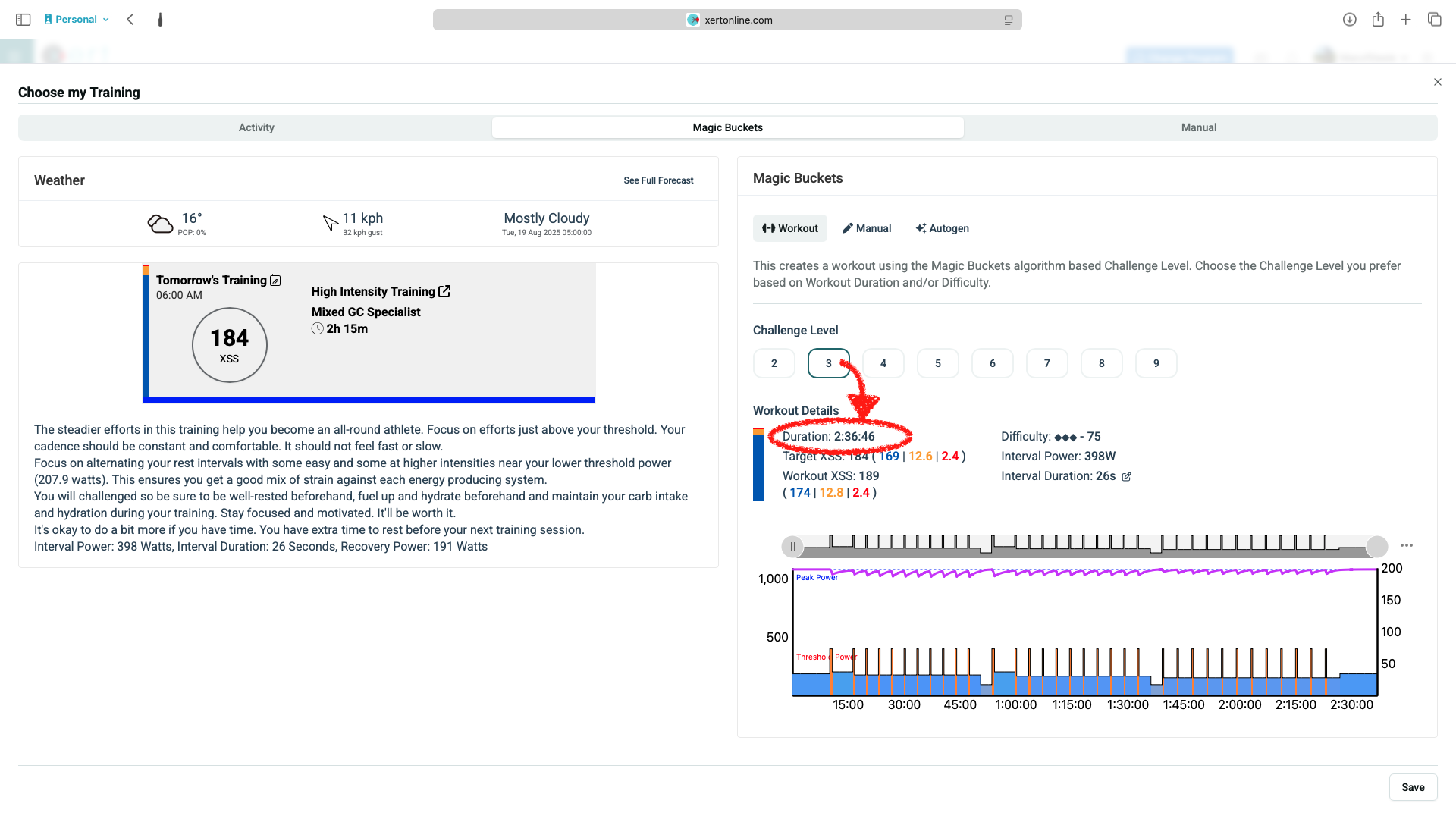

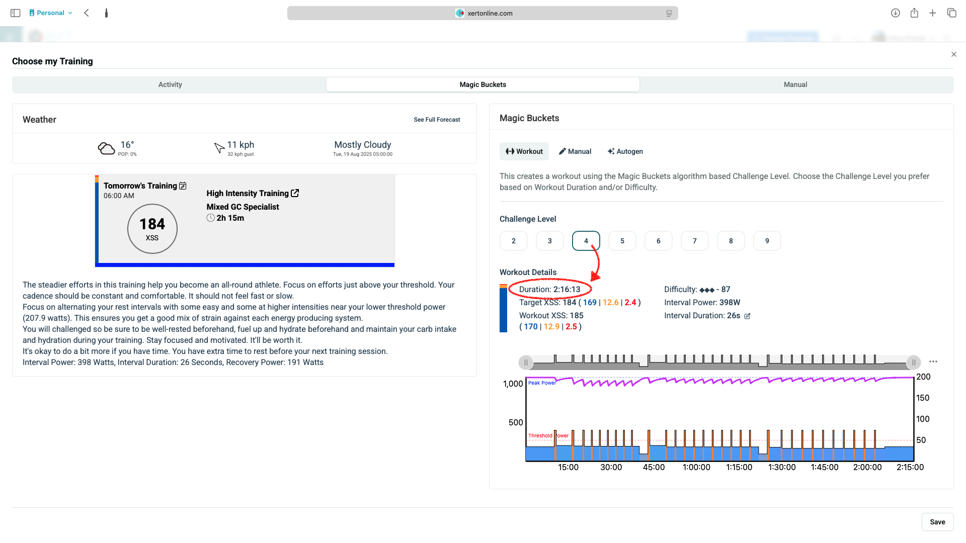

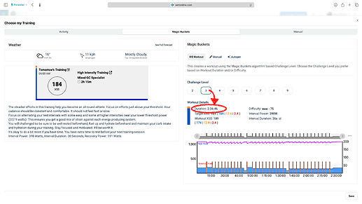

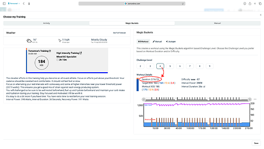

  1. From there, you’ll be able to:
    1. Preview your training duration
    2. See the estimated difficulty rating
    3. Adjust the interval duration or max Challenge Level to see how it affects ride time and difficulty
:magnifying_glass_tilted_right: Tip: If you’ve got a large Low XSS target (like on a “Polar” specificity day), lower CL intervals are fine - you’ll accumulate plenty of XSS during the recovery segments.
For Mixed or Pure specificity, you’ll often find that higher CLs are more efficient.
  1. Since I’ll be using the Magic Buckets data field on my Edge 840 (or Xert EBC app on Android/Karoo), I don’t need to save the workout — just previewing is enough!
:light_bulb: Why it’s helpful
You’re not going to perfectly follow this workout. Instead, you’re using it to answer:
“How long should I ride, and how hard should I go?”
Example:

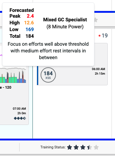

If my daily target is 169 | 12.6 | 2.4 XSS, the generated workout might tell me:
So now I know:
  • I should aim to select a 2.25-hour route (~65km/40mi for me)
  • Most of my efforts should be around CL 4–5
  • From there, I can fill my targets using Magic Buckets in real-time (on Android/Karoo or Garmin CIQ)
