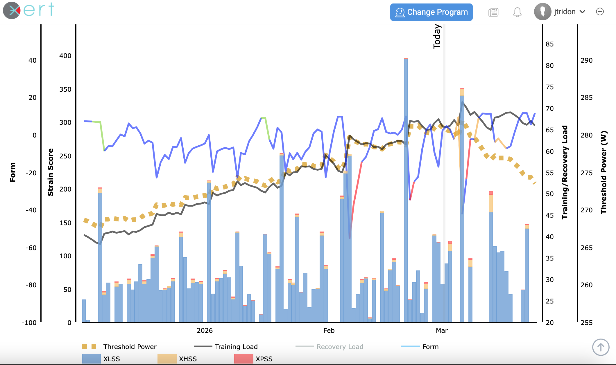

Hello,
I’m connecting tonight to check what’s on schedule/plan and I see my TP is set at 280W whereas it was at 247W this morning :face_with_raised_eyebrow:
I look at the activities, in table mode, and I can see there’s a normal progression last months.
I identify a breakup about 1 year ago:
What’s happening ???
I’m lost… thanks in advance for the help and sorry for my poor english writing.

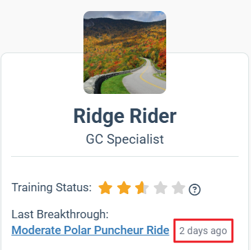

When was your last Breakthrough? (shown under your name on Today page)
For example, here’s mine –
long time ago !

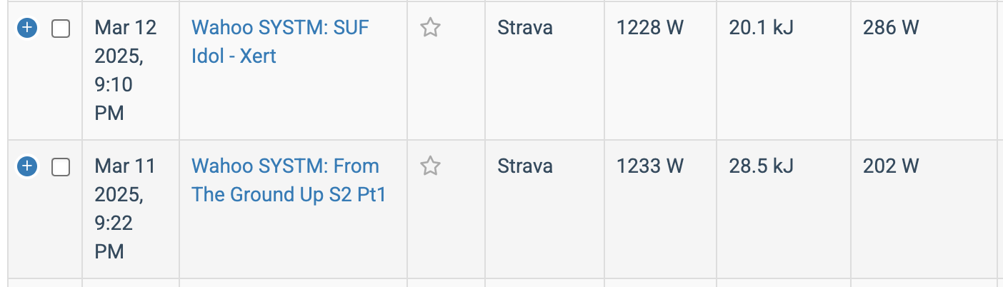

A “little” update. In the activities table, I found hidden activity that has been not impacted by the problem. Perhaps it could help…

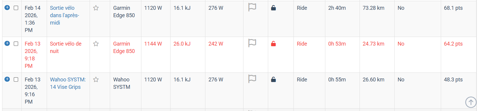

That looks like a dual recording on Feb 13. Same time, same date. One on your Garmin and the other on Wahoo System. You can delete one of them or the hidden feature applies (duplicate detected).
Do you have other duplicates like that on file?
