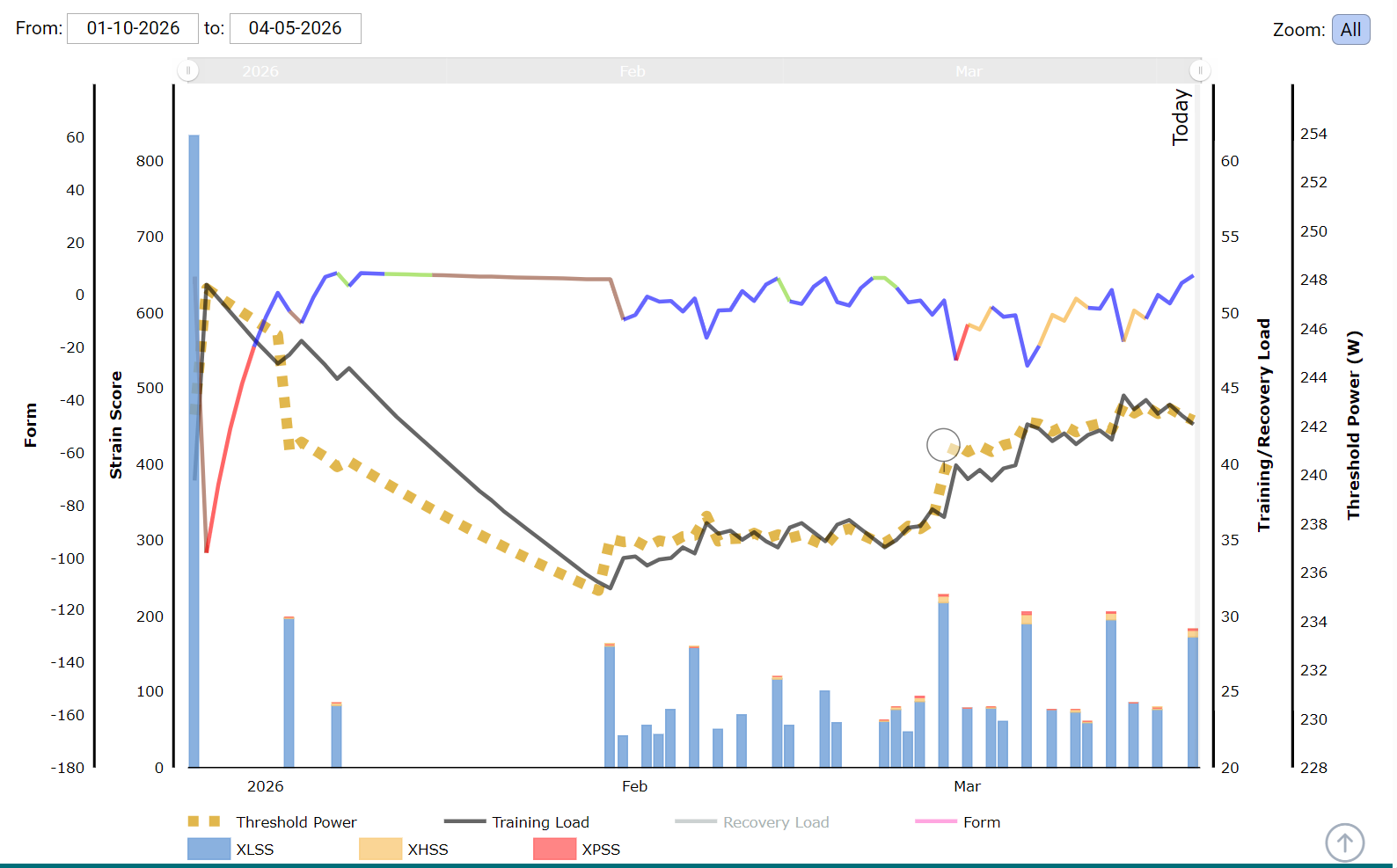

This is my current progress. I had some health issues and was able to resume training only in the beginning of February.

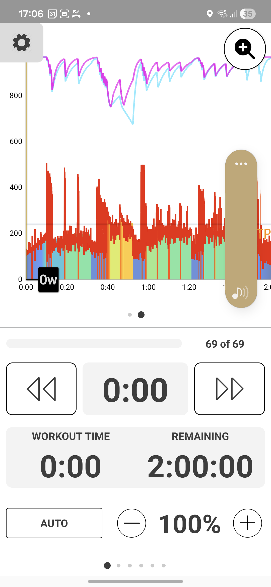

I have another question regarding the MPA.
Please take a look at the purple and cyan lines. Cyan shows the expected MPA and purple actual one. Why did the system think that I recovered much faster than I really did? Especially arounf 0:50.

Re your MPA question, first guess is that it’s when you reduced intensity to 93%? That, or you weren’t hitting the power targets (riding easier means faster MPA recovery)

Regarding the MPA: I reduced the load at very end. Near 1:45 mark. At 0:50 I was completing intervals perfectly (ERG mode).

Not sure re MPA lines as have never seen the cyan line before… when I look at the workout, for my signature at least, the purple line you have more closely follows the workout… it’s the cyan one that looks odd… or maybe when you reduced intensity, it retrospectively adjusted the MPA track of the whole workout… guess the screen shot was from the end of your workout

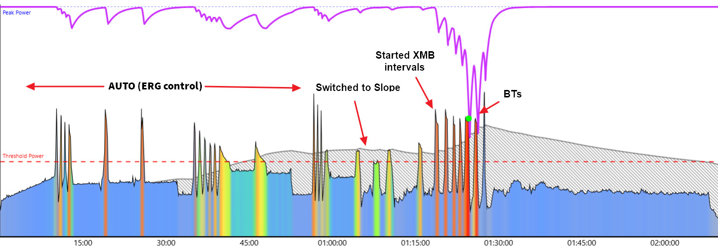

Here’s an example (Radar Love BTW) where I started the workout in AUTO, decided midway I had done enough structure and switched to Slope mode with XMB to fill the remaining buckets:
I even revved up Challenge Level after a few intervals and went for a BT. Then finished up at an easy pace to fill the Low bucket.
To do this on EBC Android, select Slope, swipe up, End Workout, Continue, swipe upper and lower screens to display the XMB rainbow gauge and intervals guidelines. Follow those guidelines to fill any remaining buckets.
Here’s another example (showing targets) where I began to fail intervals, so I bailed on the workout and switched to XMB. Problem solved. :smiley:

The power chart’s MPA cyan line (EBC Android feature) isn’t a target. It’s a predicted response. It’s not meant to match exactly during intervals and wouldn’t be “correct” if you happen to achieve a BT during the activity.
At a glance the MPA line lets you know what you’re in for and when.
Your XPMC shows a promising progression.
