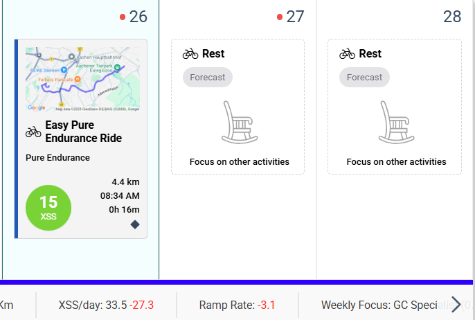

Once I do a commute with about 10XSS it automatically schedules Rest days for the next two days even though the planned XSS before was >100XSS. The result is a decrease in the weekly XSS and hours. According to the planner I am always fresh.
It really is frustrating that the training planner is just recommending me to rest every day. Meanwhile the Mobile App is showing me a training deficit of 399XSS.

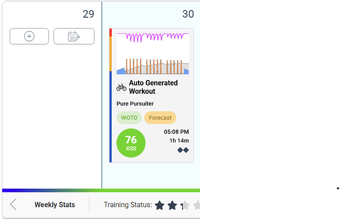

I will in 3 days, once I am allowed to train again. For now it looks like this.

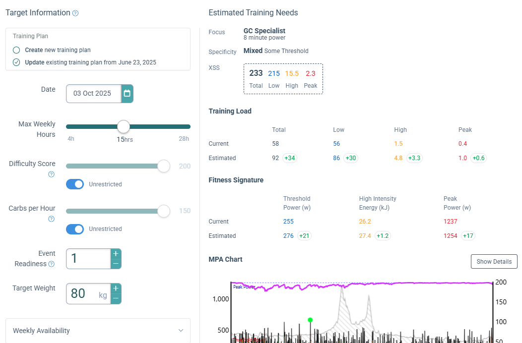

What are your current Program settings and XFAI target date?
What is your current status stars count?
iOS app deficit/surplus currently reflects XATA (fixed ramp rate) rather than XFAI (variable ramp rate). Refer to XO (xertonline.com) Training page for daily advice when using XFAI. A pending update to the iOS app will resolve this issue.
Since you are just starting out, I’d recommend XATA Continuous set to GC Specialist and Moderate-1 Improvement Rate while you learn more about how Xert works. That means the calendar will be blank but there is “plan logic” running in background.

That is beforde commute ride:

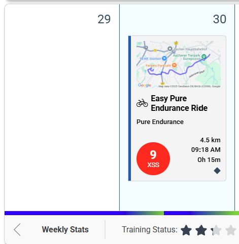

Next message is with the picture after the commute (for new users it is not allowed to send more than one picture at the same time)
That is after the commute:
I assume that the training planner just breaks, if a single activity is uploaded (at least when using XFAI).
Is it correct that the training planner should not be used, but only the training tab?
