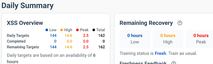

I just switched over to a continuous training program (slow weekly improvement), and have a question about what is showing on the Today page. I usually use a target event / goal so I’m not that familiar with the other program types.

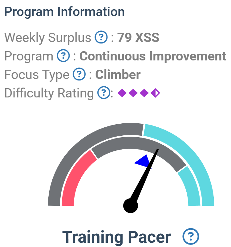

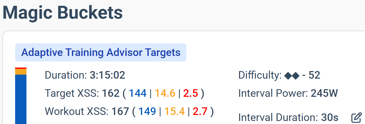

The Training Pacer says I have a weekly surplus of 79 XSS, and XSS Overview says I have a daily target of 162 XSS. Recovery status is Fresh (although I did a silver breakthrough on my ride yesterday and can feel it a little bit today but am generally energetic - mostly fresh with light muscle fatigue). Magic Buckets says I should ride for 3:15 & 162 XSS (I don’t use MB), and there are some difficult workouts recommended.

Is there a weekly target and how can I see it? I don’t really understand what I should be doing (today & in general) based on this current information. If the training pacer was balanced at zero over/under, would my daily XSS target be 246? If I don’t ride today, will I have a deficit tomorrow of 88 XSS (or more)? If I have a weekly surplus of XSS and rode yesterday, shouldn’t I NOT be recommended to be doing a 3 hour ride today? I’m not sure if I’m just not understanding the info presented, the continuous program methodology, or if there is something from the old Training page that didn’t make it to the Today page (again not really familiar with the continuous program).
TL;DR Training Pacer tracks weighted moving average XSS over a rolling 7-day window.
There isn’t a weekly target per se but a relative position on the gauge.
A deficit/surplus does not carry over from one week to the next.
You can be down at the beginning of a week and up by the end or vice versa.
If the needle hovers around 11am-1pm position week to week, you’re doing fine to achieve the Improvement Rate currently set.

The MB entry likely reflects what you’ve done recently on same-day-of-the-week. If you have the time, it’s a “mild” HIT workout. I.e. 30 sec Climber focus intervals spread over 3+ hours. No way I’m riding that long indoors on purpose. :smiley: I could, however, shorten that time by free riding with XMB and raising the Difficulty from 2-diamonds by doubling the interval duration. Or select from that recommended list of more difficult workouts.
OTOH if I had a surplus and wasn’t feeling fresh enough for 3.5 diamond HIT today, I’d scale back the Difficulty level or consider LIT for the day.

Ah, OK. I think I got it. All the talk of weeks got me thinking there something targeted at the end of each week in the program, or it was looking forward some number of days. But “week” in this context just refers to the last 7 days, and the pacer is just tracking improvement rate over that time.
I think the reason it recommended so much XSS for me is that I only had one activity (with high XSS) so far since starting the program and my 7 day window was really only 1 day.

Daily deficit/surplus value is in relation to the Noon position on the gauge.
I’m floating in Continuous mode at the moment with no goal or progression in mind. I’m currently “in the red” as I didn’t ride at all a week ago (head cold). Now that I’ve resumed training I’ll start to push the needle back up.
It takes a week+ of “recent activity” to compare to, so I’m not concerned about my current deficit.
