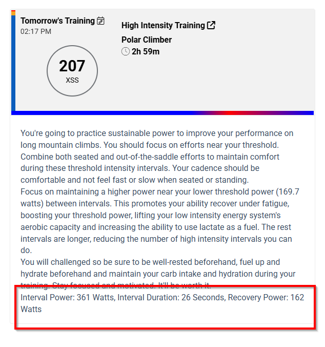

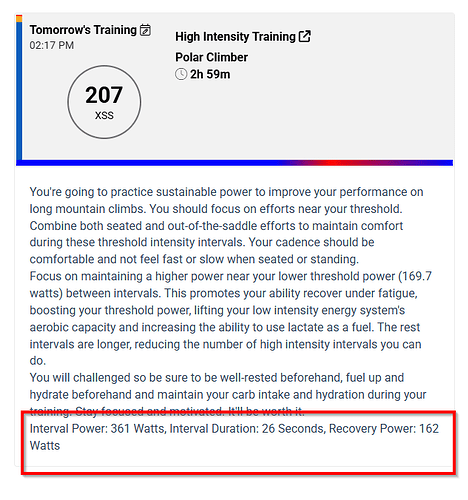

When going to the ‘Choose my training’ overlay, Xert gives a target Interval Power that seems way too high for the focus of the training. For example, I have a training sessions with ‘Polar Climber’ focus (10 minute power’) and a target Interval Power of 361 Watts (interval duration: 26 seconds). Howerver, my 10 minute power right now is only 269 Watts. This does not seem to make sense?

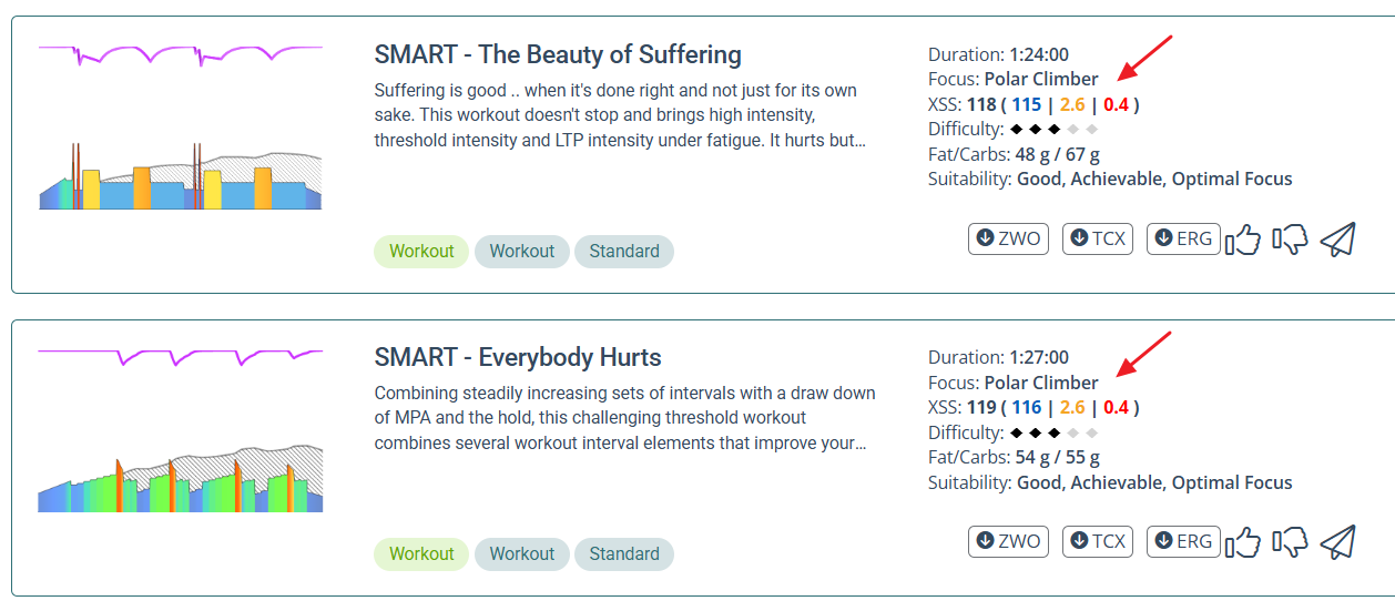

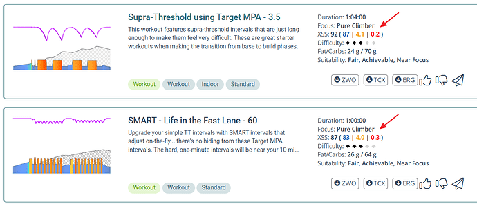

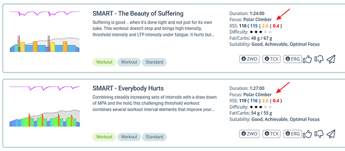

Go to Workouts Library, select Filter, Polar, Climber.
All of those indoors workouts achieve that target Focus and Specificity.

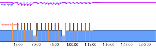

Example of two 90-minute workouts at 3 diamond Difficulty –

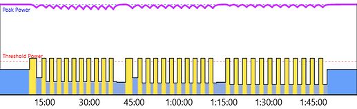

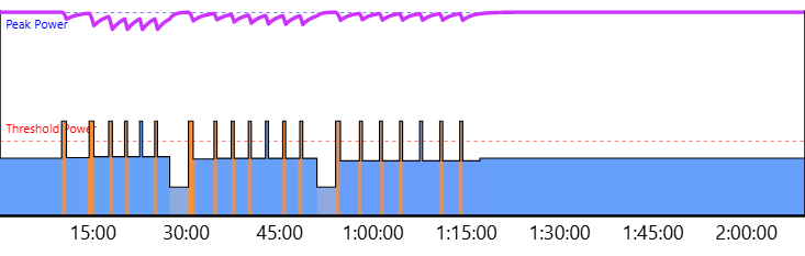

Now select the Magic Buckets Generator (MBG) tab and you’ll notice matching interval numbers from the advice for the day.
The MBG micro-interval format also meets the target Focus and Specificity for the day.

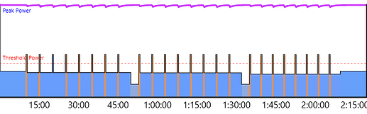

Example ~2.25 hour Polar Climber –

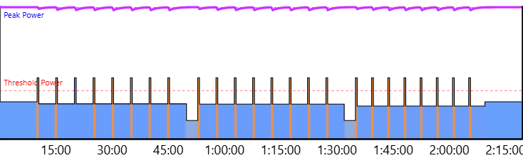

CL2 (detault) –

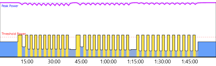

Bumped to CL4 –
CL4 with interval duration doubled (higher Difficulty) –
Compare those to a Pure Climber workout where’d you’d spend the majority of time at or close to your 10-minute power.
Example 1 hour workouts –
