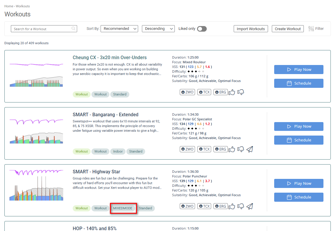

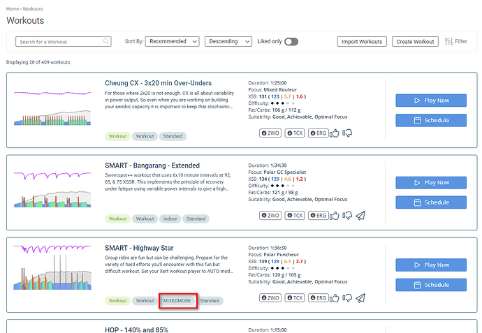

First is, when you say avoid “Mixed Mode” workouts, do you mean: ‘Specificity = Mixed’?
I cannot see anyway to search for a workout that avoids “Mixed mode" as I cannot see it as an option. I also rarely see a hash-tagged reference in any workout notes.
Where are the hash tags**?**.

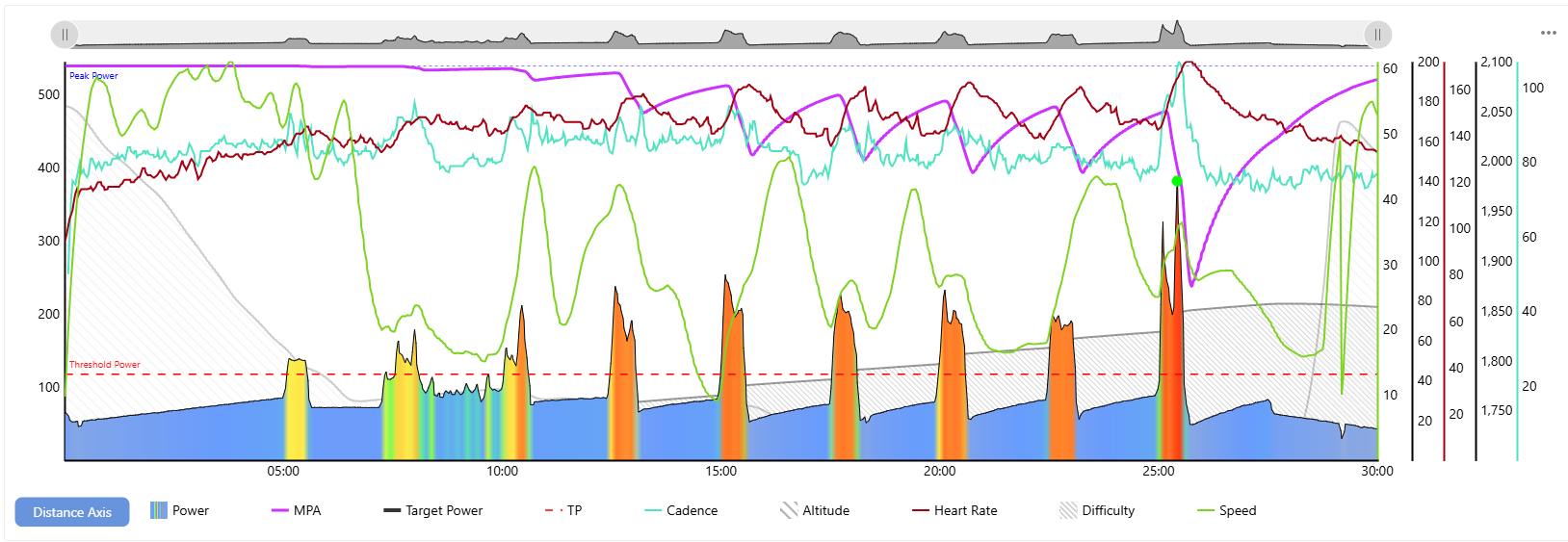

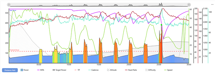

Today I used Android EBC for the first time. I did “Smart Higher 30”. I kept the EBC on AUTO, however, it was exactly like when I load a workout into Rouvy. For the first difficult interval I could not surpass the Wattage requirement, as the ERG just adapts to my peddling.
So I switched to SLOPE mode 5 seconds before each interval, with a 1 degree slop. The result was i was actually able to demonstrate what power I could put out. I then got a breakthrough.
So did I do the right thing or the wrong thing by switching to SLOPE**?
Here is SMART Higher 30 run using EBC with each Interval (except the first) in SLOPE mode.

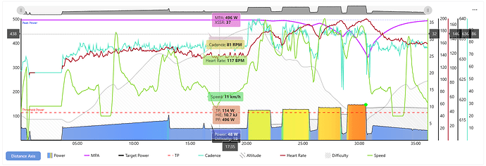

Here is my Previous Workout - Xert Test for Breakthrough, this workout was loaded into and run only from Rouvy. I could not achieve a breakthrough, as peddling hard in ERG mode just resulted in the trainer adapting to my peddling and maintaining the same power output.
I would be grateful for your thoughts.

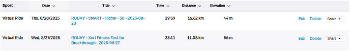

I ran the workout on both my Android EBC and Rouvy. It looks like STRAVA has only recorded my Rouvy information.
Is this the correct thing to do run the workout in both Rouvy and EBC (with EBC as the only controller**?**
Note, STAVA doesn’t show a duplicate, Xert Activities doesn’t show a duplicate, though in my Xert Planner it does show a duplicate - shall I just leave it**?**
Strava:
Xert Activities Tab:
Xert Planner:
Is this ok?

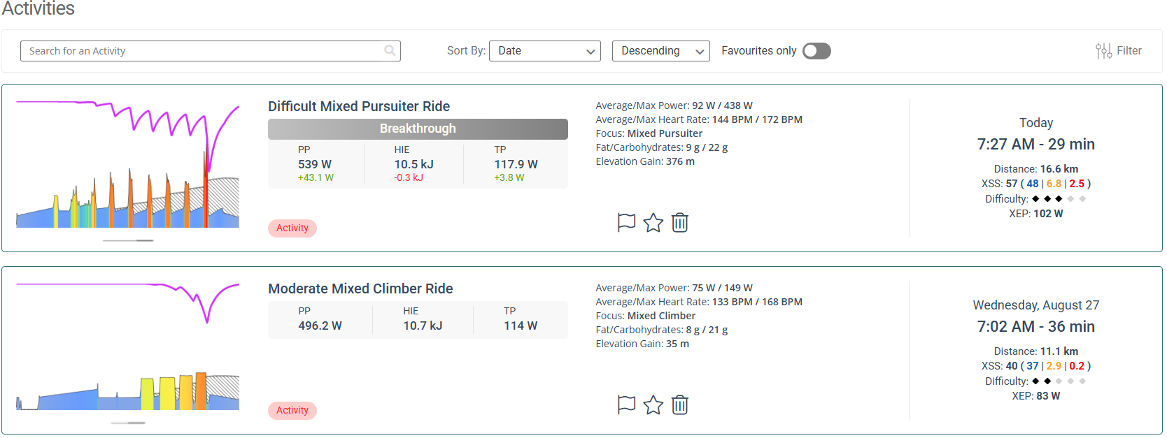

Why does Xert rename the training session? See the STRAVE information above. STRAVA records the actual workout name “SMART - Higher - 30” whereas Xert renames it to “Difficult Mixed Pursuiter Ride”?

My understanding from this is that slope means you control the slope and mixed mode means the workout controls the slope. What Trainer Modes Are Available in Xert’s Workout Players? – Xert
Specificity relates to how you do the work. Specificity Rating – Xert
Mixed Mode workouts is not the same thing as Mixed Specificity.
You cannot search specifically for workouts without a Mixed Mode tag, but in the list of workouts you can see which workouts have this tag.
Your experience with ERG is exactly how it’s designed to work. The trainer is keeping the resistance at a fixed power regardless how fast you peddle. It’s not possible to get a breakthrough unless the workout is designed to generate a breakthrough.
In SLOPE mode it’s up to you to keep the power in the same range as the workout is prescribing. This is done with the combination of gear selection, cadence and the incline of the slope.
In AUTO the EBC app automatically changes between ERG and SLOPE according to the steps in the workout. Workouts that automatically changes between ERG and SLOPE is tagged with Mixed Mode.
If you select a workout without Mixed Mode tag and keep the EBC on AUTO the workout will usually use ERG mode.
TL;DR; If you want to follow the workouts prescribed wattage to a T you should select AUTO/ERG. If you want to surpass the workouts wattage to i.e. get a breakthrough select SLOPE.

STRAVA
Strava:
image1224×180 17.5 KB
image1668×627 102 KB
Xert Planner:
image447×482 45.5 KB
Is this ok?

Strava detects duplicates - whichever file was received by Strava first will be the only file kept there. FWIW, when I dual-record my rides, I’ll only actually save one of the rides & discard the other. For example, discard the EBC version and keep the Rouvy version to get the virtual elevation and speed/distance from Rouvy. This generally helps me avoid issues with duplicate files for the same activity.
Yes, that’s the way I prefer to run all my workouts - I let Xert EBC control my trainer and whatever virtual app I’m using will only passively ‘listen’ to the power data from my power meter.
The planned workout will expire at the end of the day, so you can leave it if you want, or you can choose to delete the Planned workout yourself once you’ve finished it. We have some improvements planned to make it easier to match planned to completed workouts.
We default to using the Strava title (if syncing from Strava) or the workout title if the activity is saved from the Xert EBC app. Other activities imported to Xert will be assigned a name based on the Difficulty Rating, Specificity, & Focus Rating (e.g. Difficult Polar Rouleur).
IIRC, some Wahoo devices can rebroadcast ANT+ HR data in the data stream with the trainer, which might explain how HR is in both places. You’d need to look closely at the file saved from EBC & the file saved from Rouvy to determine if both have the data.

Naming of Training Sessions: Strava has retained the original Workout Name, yet Xert gives it a new name.
STRAVA
XERT
These are the same workouts, Strava has the original workout name, yet Xert saves it with a new name.
