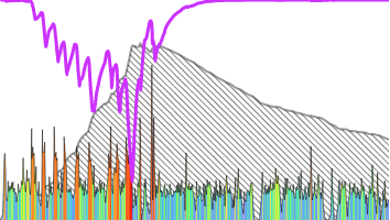

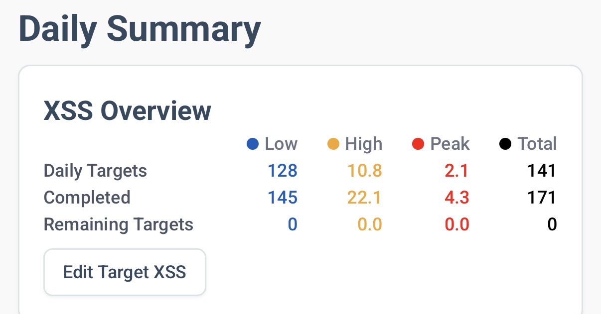

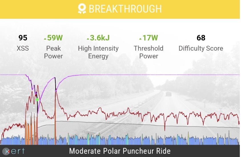

Now today I had another strange behavior of my karoos or rather when transferring to Xert. I had filled my buckets almost exactly. I didn’t take a picture now, but I was at about 124 low xss, 12 high xss and 3 peak xss. After the transfer, I now have the following result in Xert:
To be rated Hard the Difficulty Score needs to exceed 150.
That would mean an effort near or at total collapse. I assume that wasn’t the case.
Is it possible a recent Karoo update affects the FIT file, the transfer of the file, or a 4iiii meter in particular?
Is the original FIT file available on the Karoo platform to compare to?
I suggest you file a support ticket with support@xertonline.com.

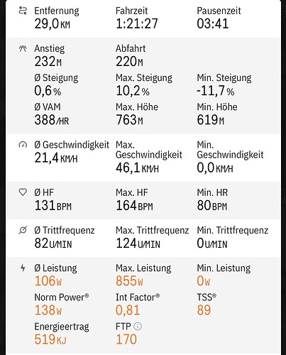

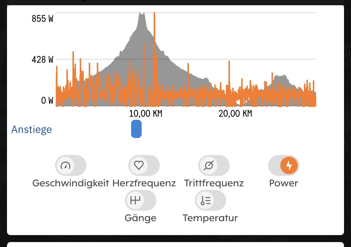

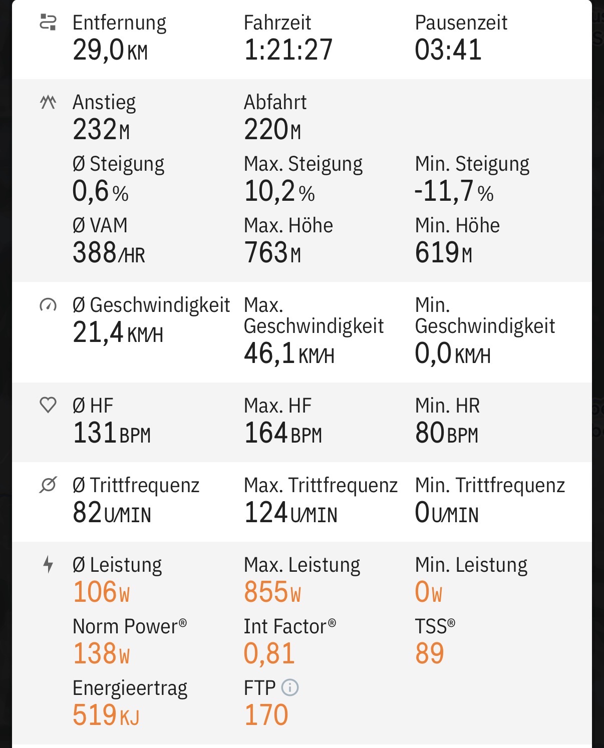

I don’t have the wherewithal to analyze the FIT file, but some obvious discrepancies are 126 DS (Difficulty Score) shown on Xert chart doesn’t match the rating. Plus a 855-watt spike detected which was likely filtered out by the server (not shown on chart). Do you remember putting in a sprint effort like that?
Is that screenshot from Hammerhead’s dashboard?

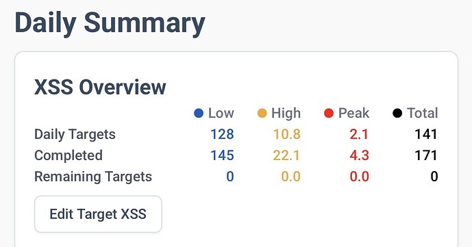

Ah ok, I still have to get used to these adjustments during a workout. If everything is in order, I am satisfied. I was just surprised by this XSS jump, which also remained the same when I flagged the ride. But thanks for the answer and explanation.
Yours is a bit of an edge case because the Breakthrough increased your Peak Power, but partially dropped your TP a few watts. This happens from time to time — I’ve personally had this happen many times the past couple of months from max efforts during racing where I’m not watching any of my Xert data.
You might find it a bit easier to push hard & generate a breakthrough on your next hard ride that brings your threshold right back up to where it was before, or raises it even higher!
