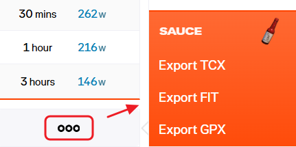

Question; how do I use a file from someone else in RACE AI? I only see the option to download it as a GPX file, not a FIT file since it is not my activity.
Install: Sauce for Strava™ - A browser extension for Strava
SauceForStrava
