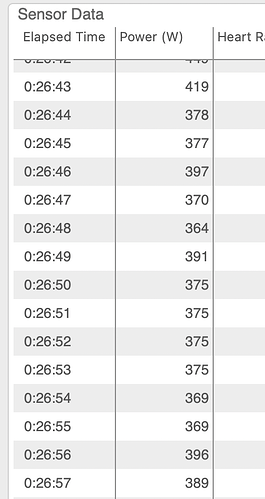

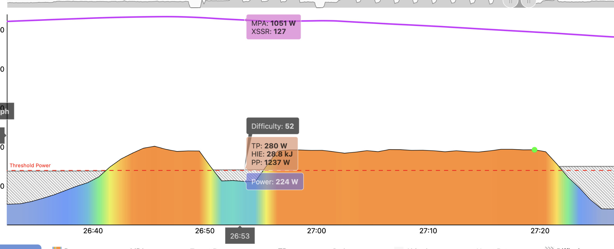

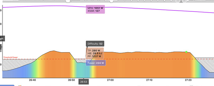

Xert showed a 10 second or so dip in a 40 second interval today, which was strange because I knew the effort was consistent.
I looked at the raw data in WKO5, and the numbers shown in Xert do not match the actual raw data in the fit file

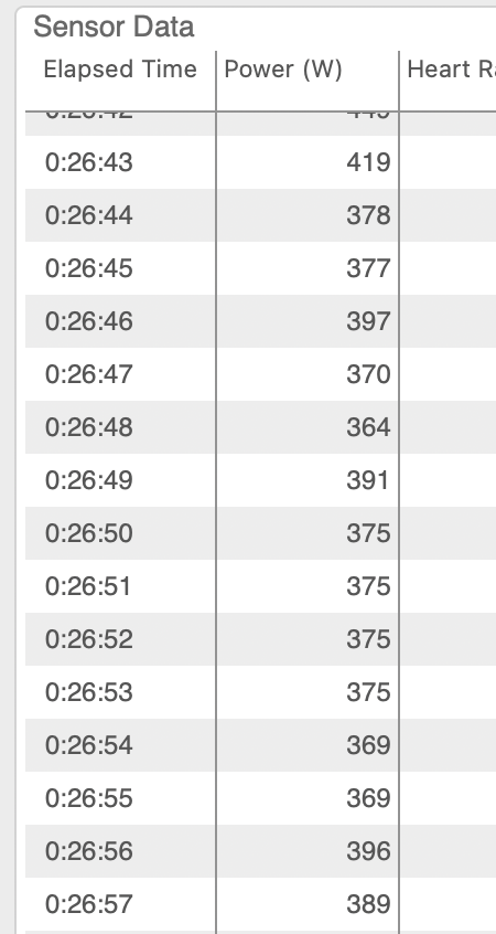

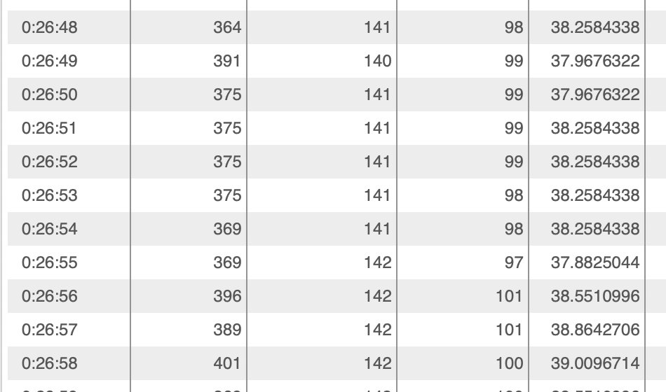

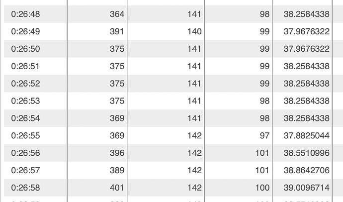

Here are 2 screenshots showing only 4 seconds of the same exact watts. This sounds unlikely to have 4 in a row exactly same power, but on rollers and you’re at about what you can do and that’s it, I can see it happening especially if you’re unable to raise cadence higher. I know in the grand scheme of things these missing 6 seconds are absolutely nothing, but you don’t want users to say hey I see the data in WKO5, I ran it through dcrainmaker analyzer, I can see the exact numbers, and xert changed them? How many other rides have been massaged without me knowing? Having confidence that the data is the data as it is shown is important to people.
I get what you’re saying about bad data affecting the signature, in this case Xert mistakenly made a change and now I’m left wondering what else it has done (probably still not a big deal).

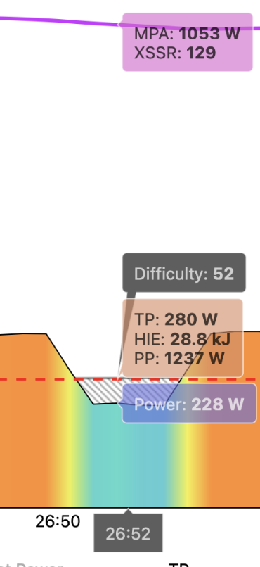

One other thing: Why would it choose an arbitrary wattage number? If it was concerned about 4 seconds in a row at 375w, how did it come up with a solution of 280w? The context around the 375 does not suggest 280w.

It appears that sticky watts are assumed 0 and smoothing causes the seemingly arbitrary value.
