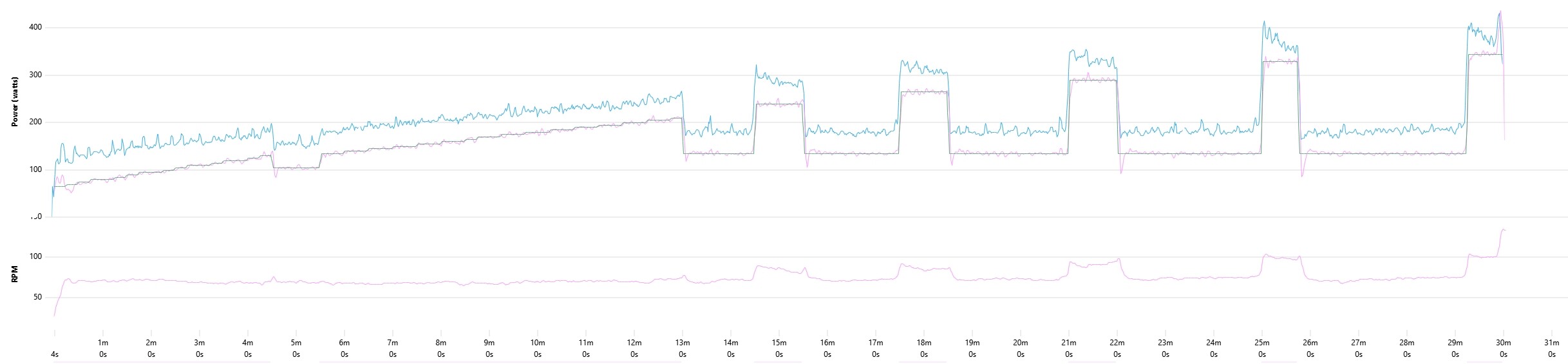

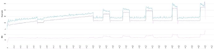

Here’s another graph comparing the same power meter that started this thread with my new trainer. At first it looks mostly like a zero calibration issue but that’s not it. The Stages power meter (left arm only) was zeroed before this test and applying a simple offset to the data doesn’t quite get them to where they should be.
My left leg is considerably stronger than my right so that might be causing some problems with this comparison (Stages PM being left side crank-based). There are also the drivetrain losses but those are small compared to the leg imbalance. The difference here is HUGE!
Unfortunately, there is no way for me to apply a correction to the zero calibration or change the slope with the Stages power meter. A simple offset would help a lot but the remaining slope difference is still too much IMO. Again, definitely not the 1.5% accuracy you may think you’re paying for and obviously a BIG problem if you’re mixing power data from both meters into a training plan.
I’ve got an older version of the Xert player on my Ipad where there is a facility to offset the power on the trainer. I’m careful never to update it incase it looses the functionality as its not on the newer versions.
