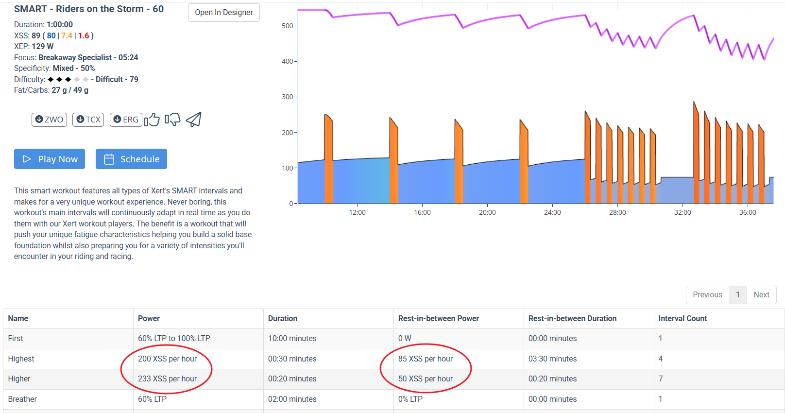

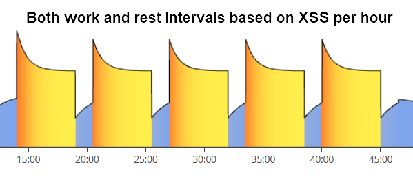

You can identify SMART workouts that won’t translate well by viewing details.
Look for XSSR and %MPA based intervals.
Another clue is the thumbnail chart. Look for ramps or curvilinear intervals.
Examples:
Riders on the Storm details –
I obviously had no idea what SMART workouts were. I see now that since they are “changing” as you go, there’s no way they can be send to the Fenix and expect to be SMART still.
