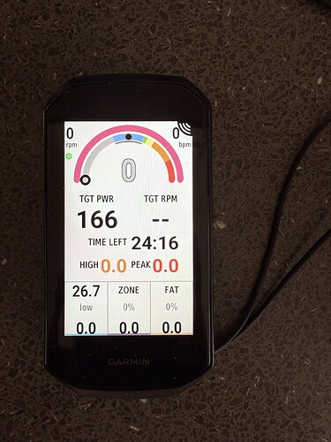

Hi again,
Just checked my Garmin. There is no automatically load to magic buckets.
It shows still the screen from days before:
Any further ideas on this issue?
Magic Buckets will get the numbers from your recommended training for today (low, high and peak). You don’t need to do anything.
Unless you are on a rest day or red (tired), in which case, as I understand it, it will show you 27 low XSS.
So what does your ‘Training’ tab and MB look like today?
