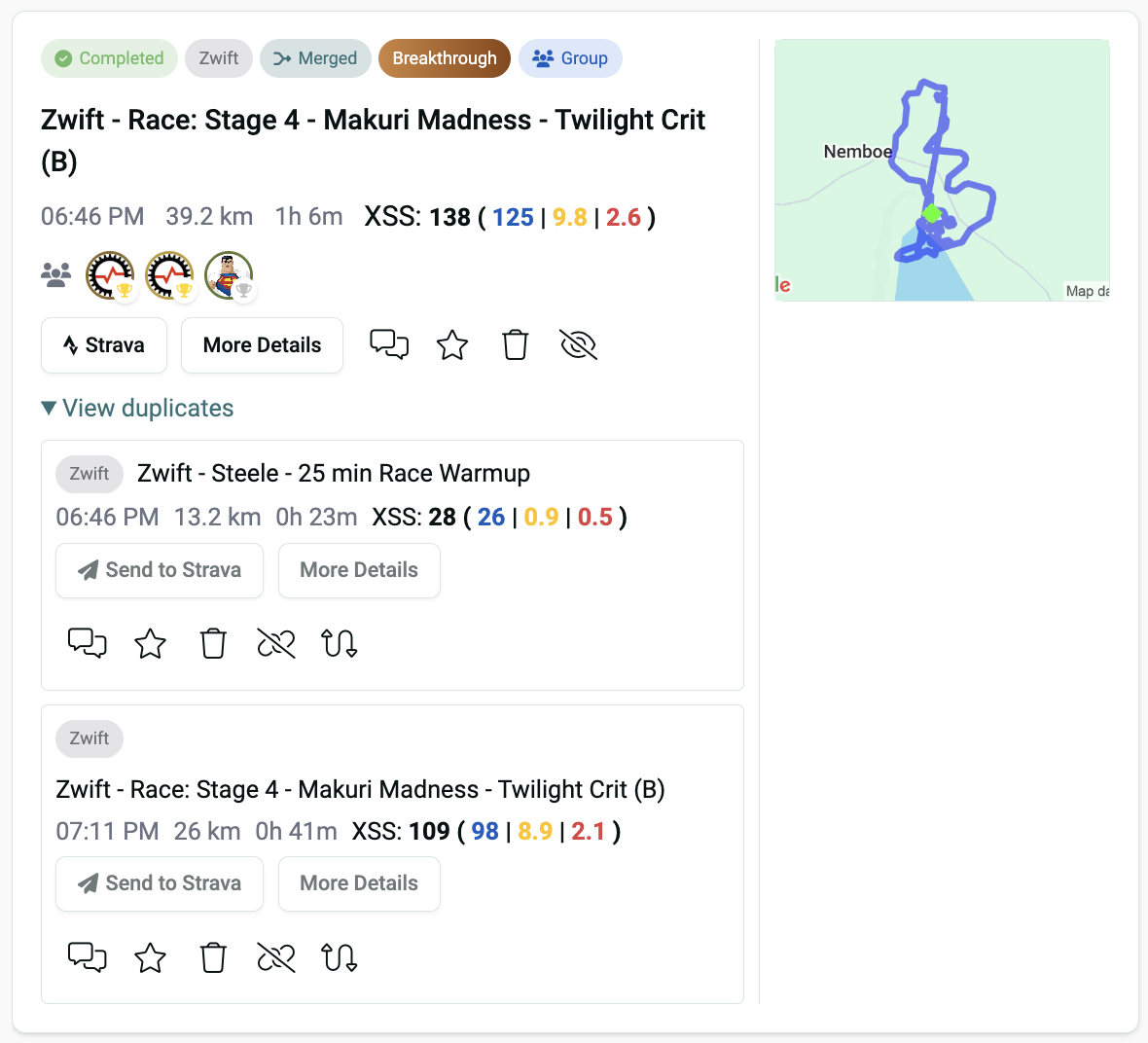

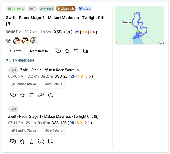

Hmm… I use the merge feature all the time for my Zwift races - I merge my warmup with the actual race.
Total distance should be equal to the smaller rides… I checked several of mine and that was the case for me:
Changes in elevation probably depend on where the start/end elevation of each ride is. (although TBH, I don’t really care too much about those :man_shrugging: - they’re indoor rides, so it’s all kinda made up anyways. For Xert’s sake, I just care about the XSS, MPA, etc.)
In my case, I feel that merging is worth it. I just send the merged file to Strava afterwards. Then I don’t clutter up my strava feed with 3 separate activities every day. I have one file that is my warmup, race, & potentially cool-down all merged & sent to Strava as one ride. YMMV.

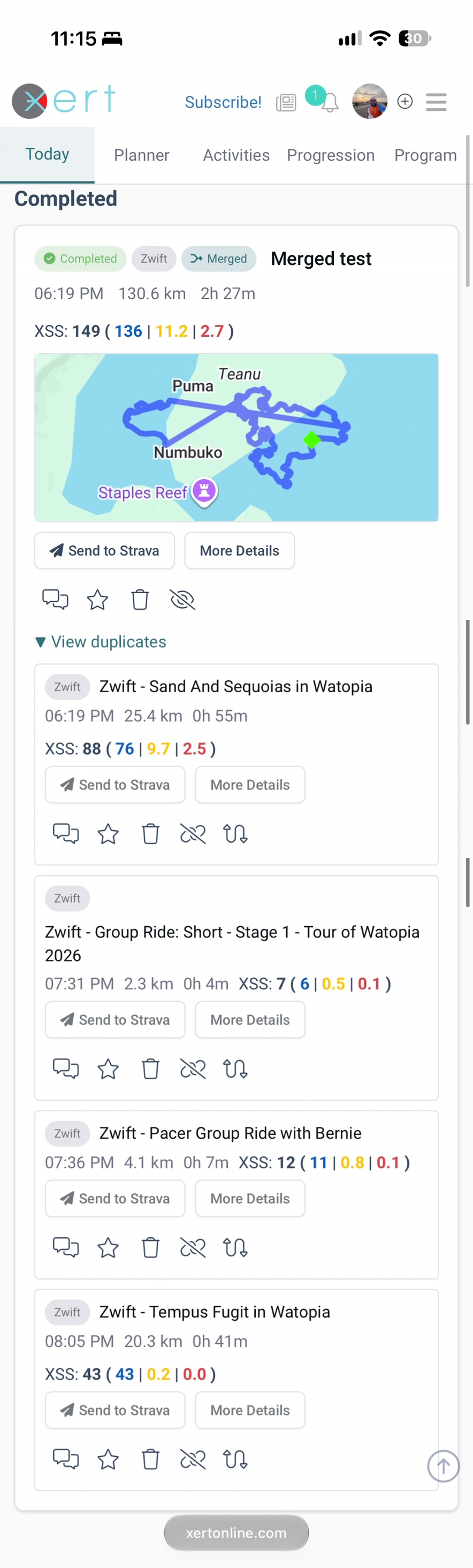

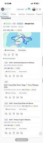

I am sharing my today’s merged rides. I did total ~52KM riding across 4 activities. However Xert says 130.60 KM for the merged file.
We can take a look. Thanks!
Hi, I build https://thesplit.fit, a free browser tool for merging/concatenating FIT files.
If you want to try it on your four rides: it can join back-to-back activities into one file and continues the distance across each join instead of adding each ride’s counter on top.
I’ve only tested this on my Garmin and TPVirtual files, not Zwift ones, so I’d like to know if your total comes out near your real ~52 km.
Try to merge online (you will have to merge A+B and the result with C) and see if it works. If it it doesn’t, if you can share the FIT files I’m happy to look at why Xert’s total is off (email them to thesplit at britemind dot io)
