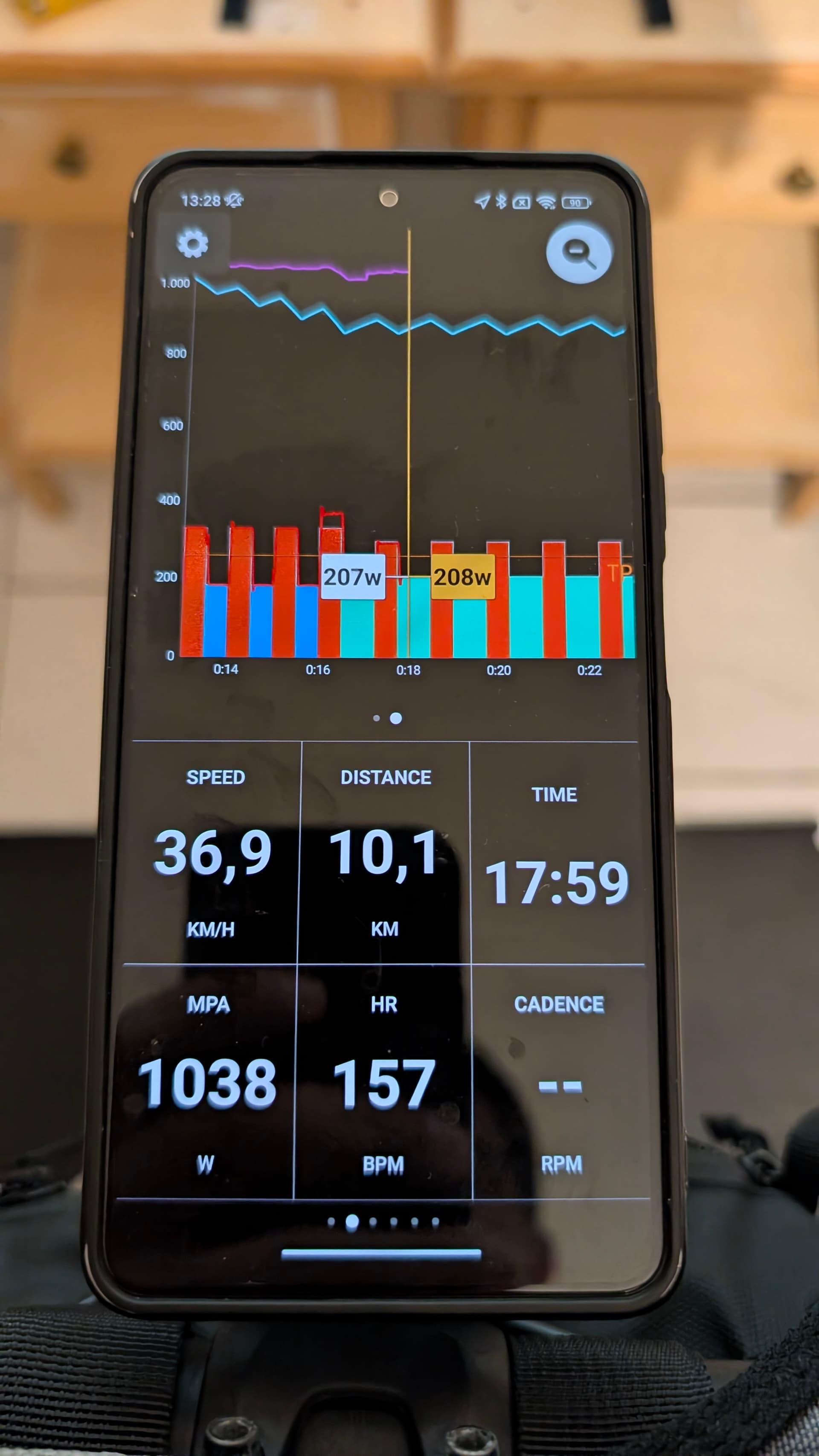

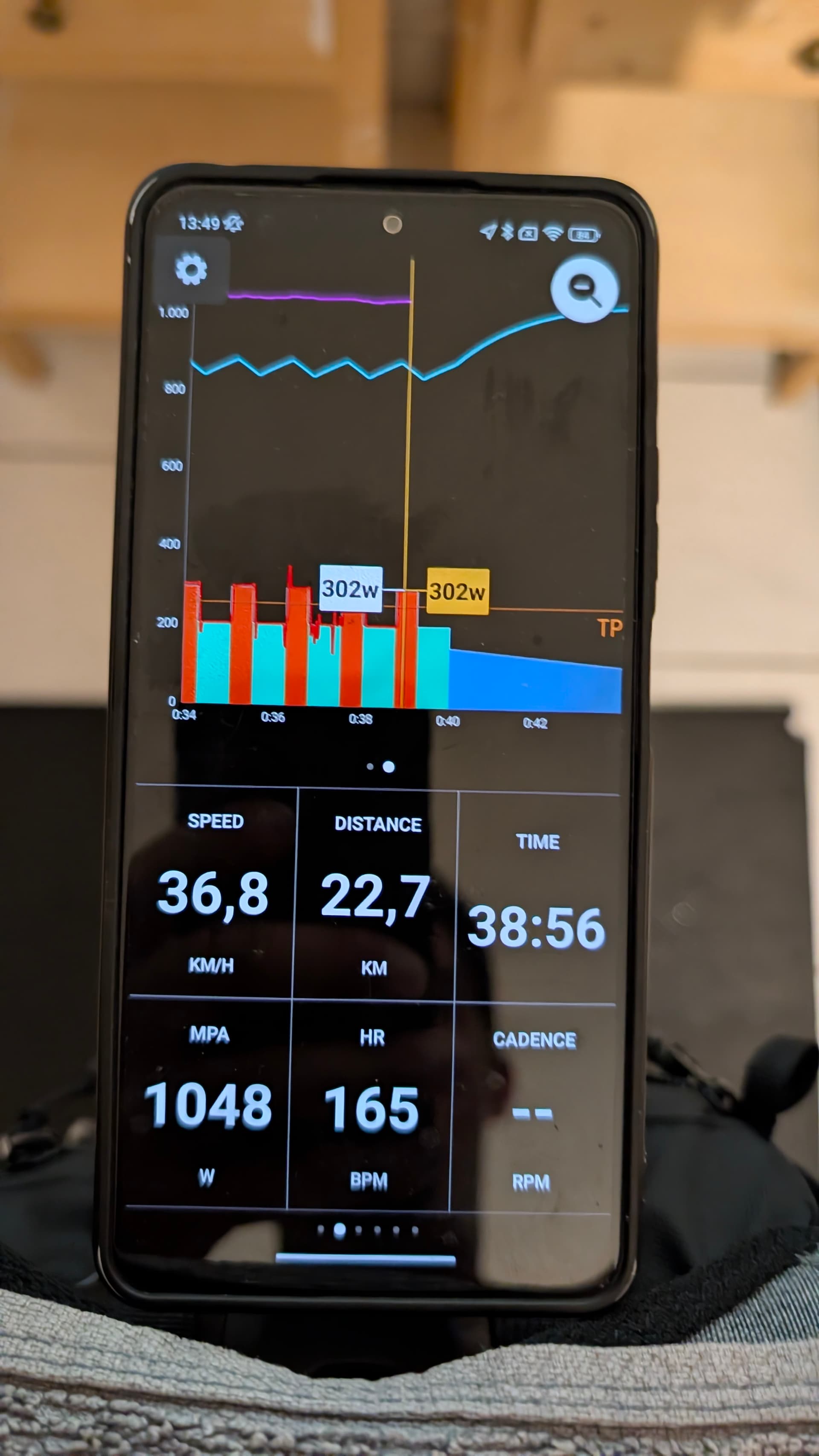

Quick question here. I’ve got a couple of trainers (Elite Suito T and Van Rysel D100) in 2 different cities with 2 different bikes on them, with which I use EBC Android app. Everything working seamlessly from a sensor and workout perspective, but the Van Rysel one is bugging my head off.
Basically in every workout the MPA value is descending very very slowly compared to what it is supposed to.

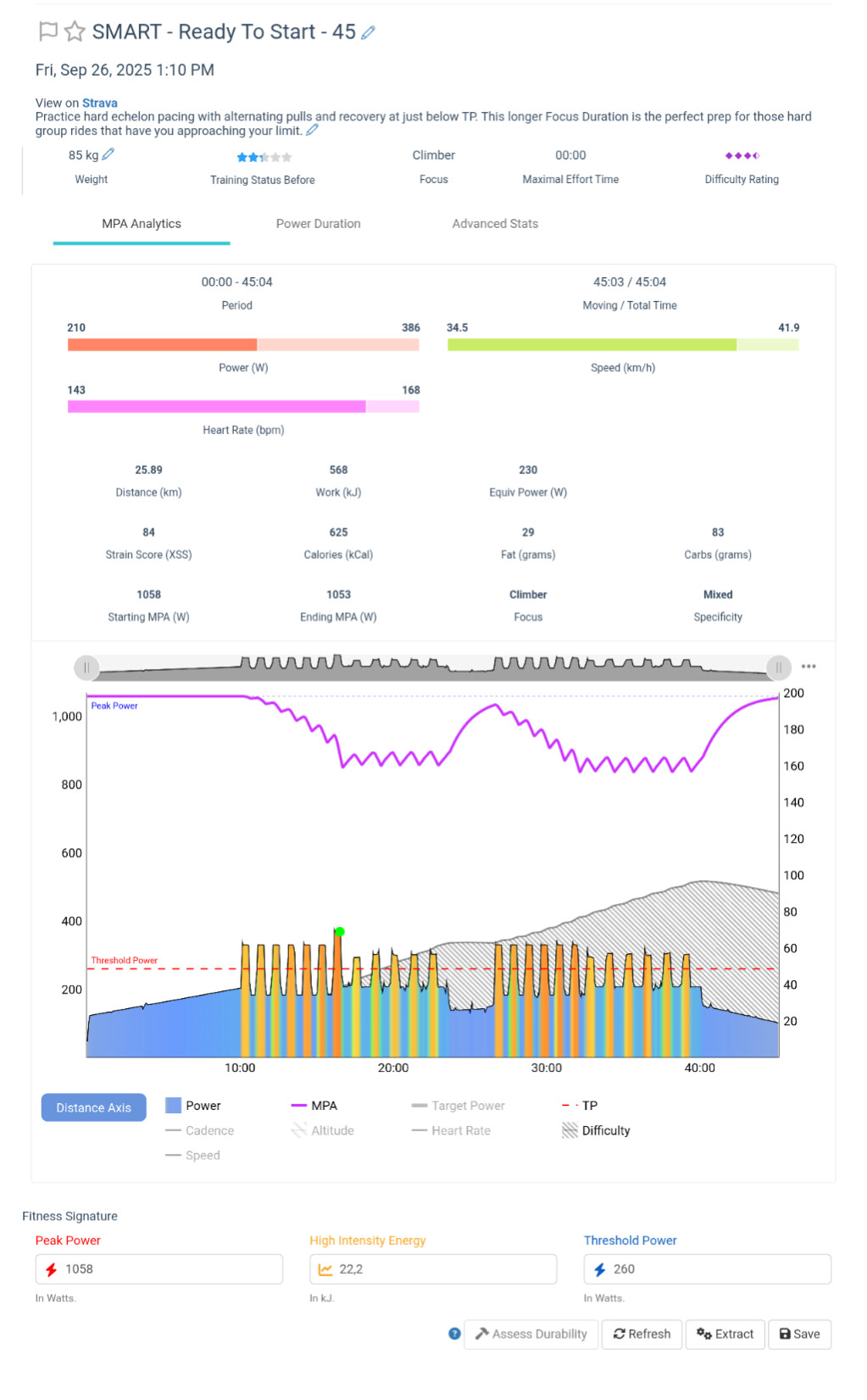

You can see in the attached pictures that after some 30-30’s the MPA is not as low as it should have been; in the aftermath online analysis everything seems correct since it seems the server has sorted that out.
Any suggestions on this? Could it be a power smoothing problem? Van Rysel trainer seems to do it every single time while the Elite is not and with that trainer everything MPA related is ok.

Seems like something is stuck power reporting-wise on the Van Rysel.
I assume the rainbow gauge shows the same problem since MPA isn’t dropping in line with the effort.

Looks to be a visual bug. Can you include some of these screenshots in a message to our support team via email so we can take a closer look?

The main issue is that the SMART workouts are very hard to complete, because since the MPA is not dropping as it should be the EBC app keeps rising the power to stellar levels and I can not cope with that.
Any other ideas are well accepted, do you think the cadence could be the culprit? :sweat_smile:
