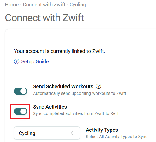

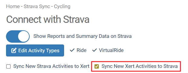

If Zwift is configured under Connections to send completed activities to Strava, disable that connection.
Xert Sync should look like this –

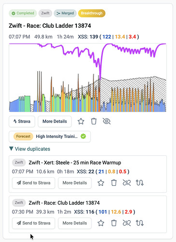

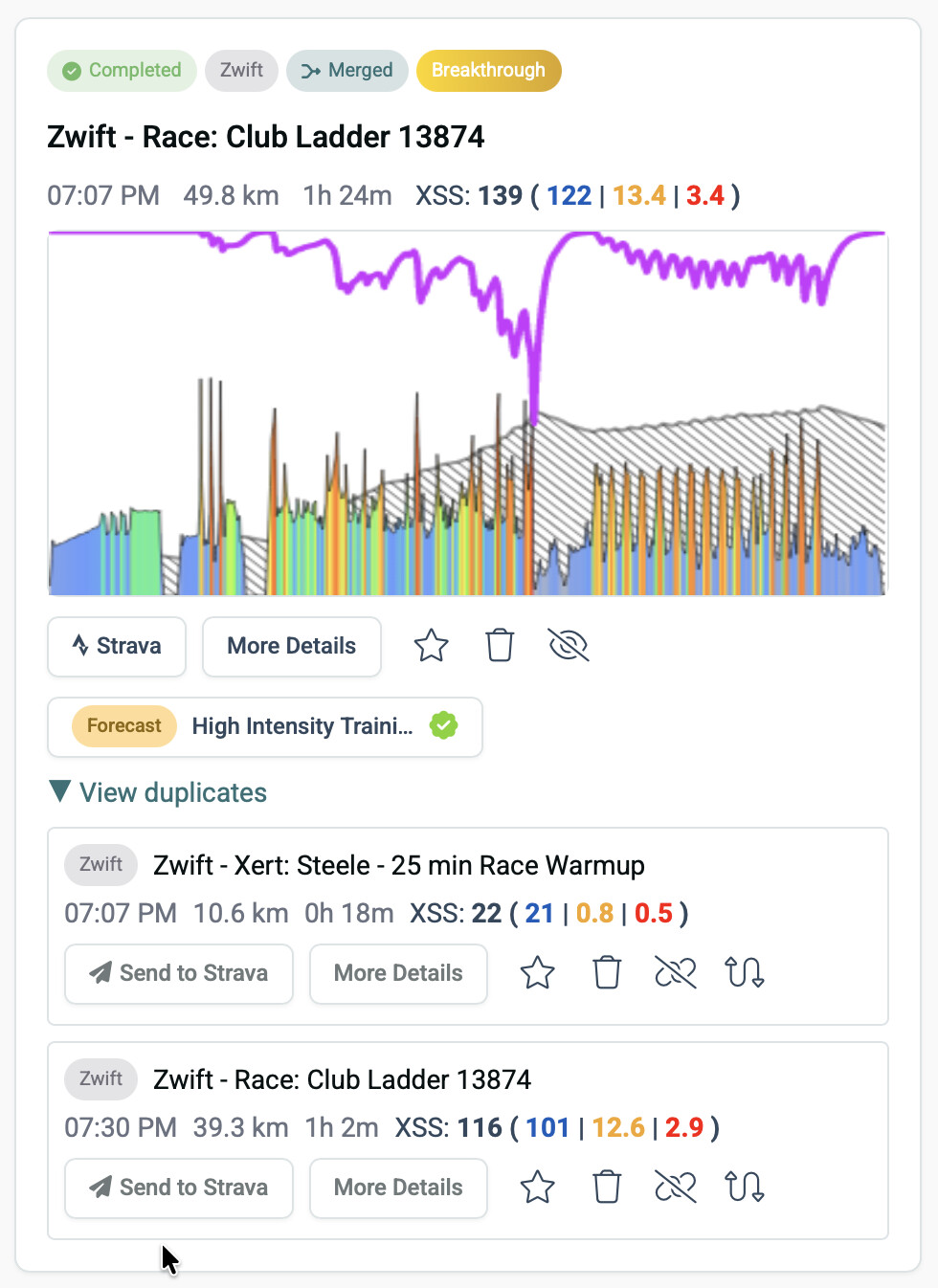

For now, there is likely not a massive net difference between merging or not merging. For me, the primary benefit is tidying the analysis in Xert & on Strava.
Rather than having a Zwift warmup, a race activity, & then a cooldown activity that all partially fill my buckets and clog up my Strava feed, I prefer to ‘gather’ them all in Xert, merge them in to a single file and just push one activity to Strava, like this:
