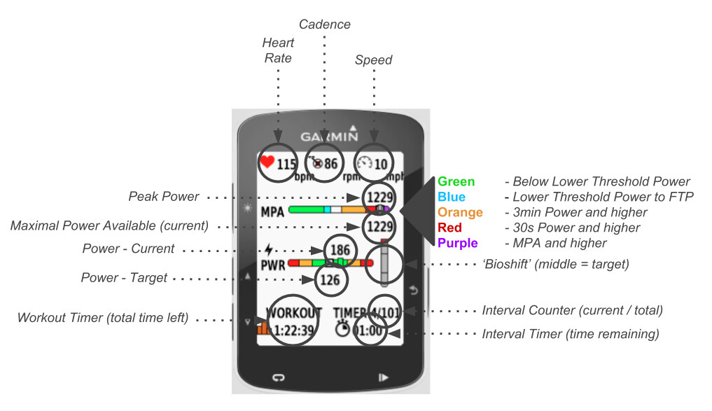

What is the difference between the two numbers that are shown on the MPA meter on the GarminIQ screen? At first I thought one is your max MPA and the other your current MPA as it declines because you are doing a high effort. However then I noticed that both numbers actually change throughout the workout, so neither of them can be the max MPA.

Might be a good idea to add this information to Using the Xert Workout Player for Garmin Connect IQ – Xert @xertedbrain
