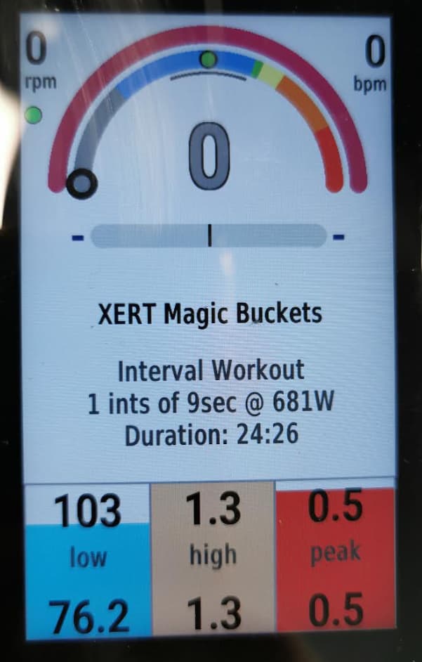

However, for the second session of the day, MB takes whatever you did in the first ride and marks them as “complete”. When the actual completed values do not exactly match the amount filled in the peak or high bucket (for example see photo), the training screen requires you to complete a single interval to correct this rounding error.
The reason this is frustrating is that after completing this single interval, you get the “ride easy” screen on the Magic Buckets interface for the rest of the ride.
Without this rounding error you would get the Magic Endurance screen from the start of the ride, which would match the intended training.
Please could the tolerance on the “completed” buckets be set slightly wider to avoid this happening?
