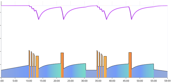

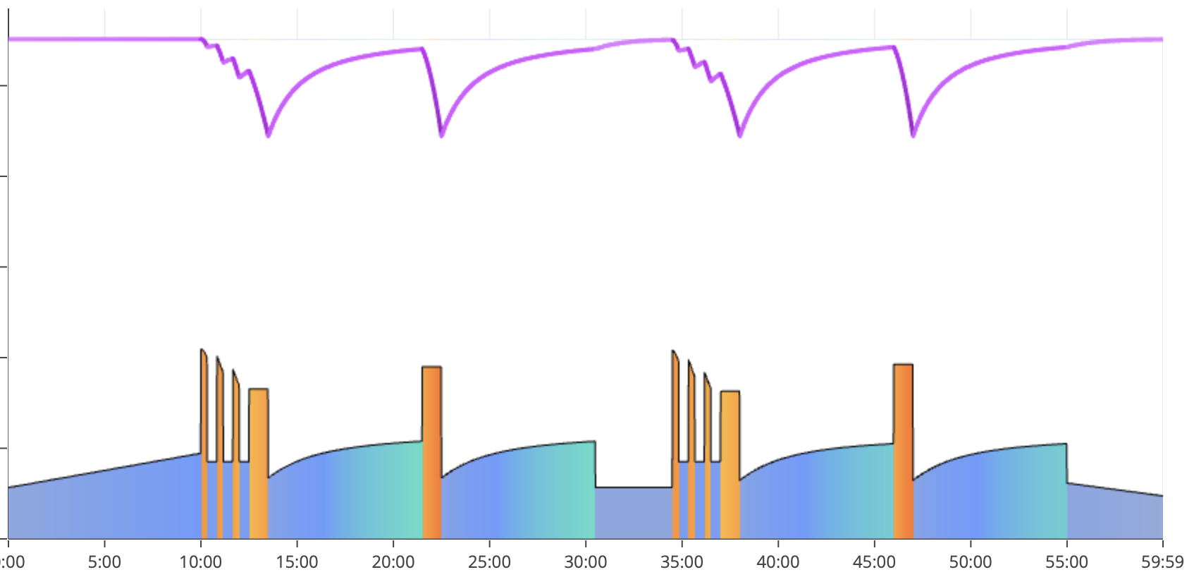

If you have a lot of Low XSS to achieve, you’ll find that Xert uses the high-intensity interval to draw down MPA & cause fatigue, & then the ‘recovery’ interval has you pedal under that fatigue at a moderate effort to accelerate the strain on that system.
You’ll see several structured workouts in our library that use this same principle, such as SMART - Bangarang, which features a hard effort to draw down MPA followed by a longer “sweet spot” effort that generates a great dose of Low XSS in a time-efficient manner:
