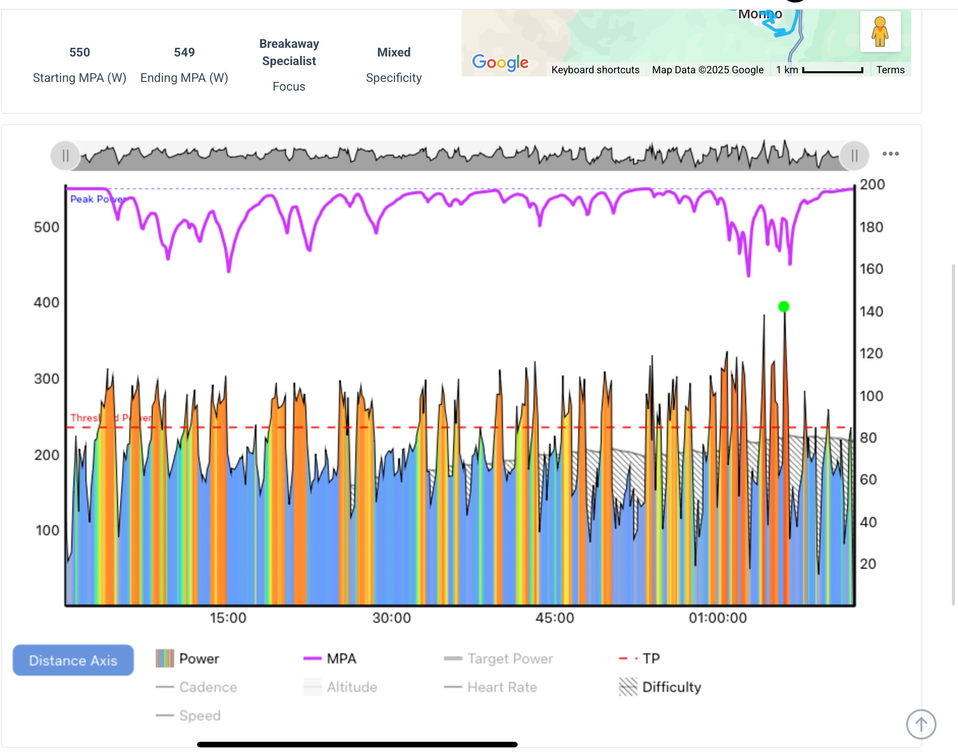

Getting back to a subject I raised in my initial post.
Today I needed 94/6/0.5
Initial intervals was 38 for 58 secs each at 253. TP is 220 so 257 was going to fill high most of the time
After a while I had filled peak and was about 3.5 for high. I had maybe 12 intervals left at 253.
Then I had the same number of intervals left but at 308. As expected that filled peak much quicker than high.
I
I finished up with 94/6/1.5
My question is - why the sudden jump from a target interval of 253 to 308 when peak was already completed. I have seen this before so it was not a one-off.

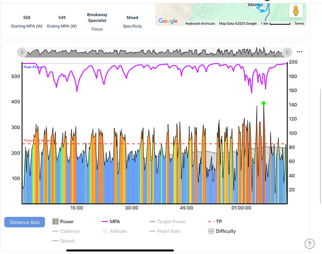

Post the power chart from that activity.
Was Climber the Focus Power target?
On 8 min power plan. The focus was breakaway specialist for that session
Great attention to detail - this behaviour is intentional! We allow athletes to go a little over their High or Peak target without changing the target power too much - this prevented large changes in the target power as you neared completing your high or peak bucket.
However, if you over-fill the High or Peak bucket before the other is filled, the data field defaults the target power to a value that maximizes the strain rate for the remaining system to fill it as efficiently as possible.
  • If Peak is over-filled & High XSS remains, the Target power moves to your 90s power
  • If High is overfilled & Peak XSS remains, the Target Power moves to 20s power
There’s maybe a more sophisticated method that we could use, but we opted for a simpler implementation for now (KISS :slight_smile: ).
