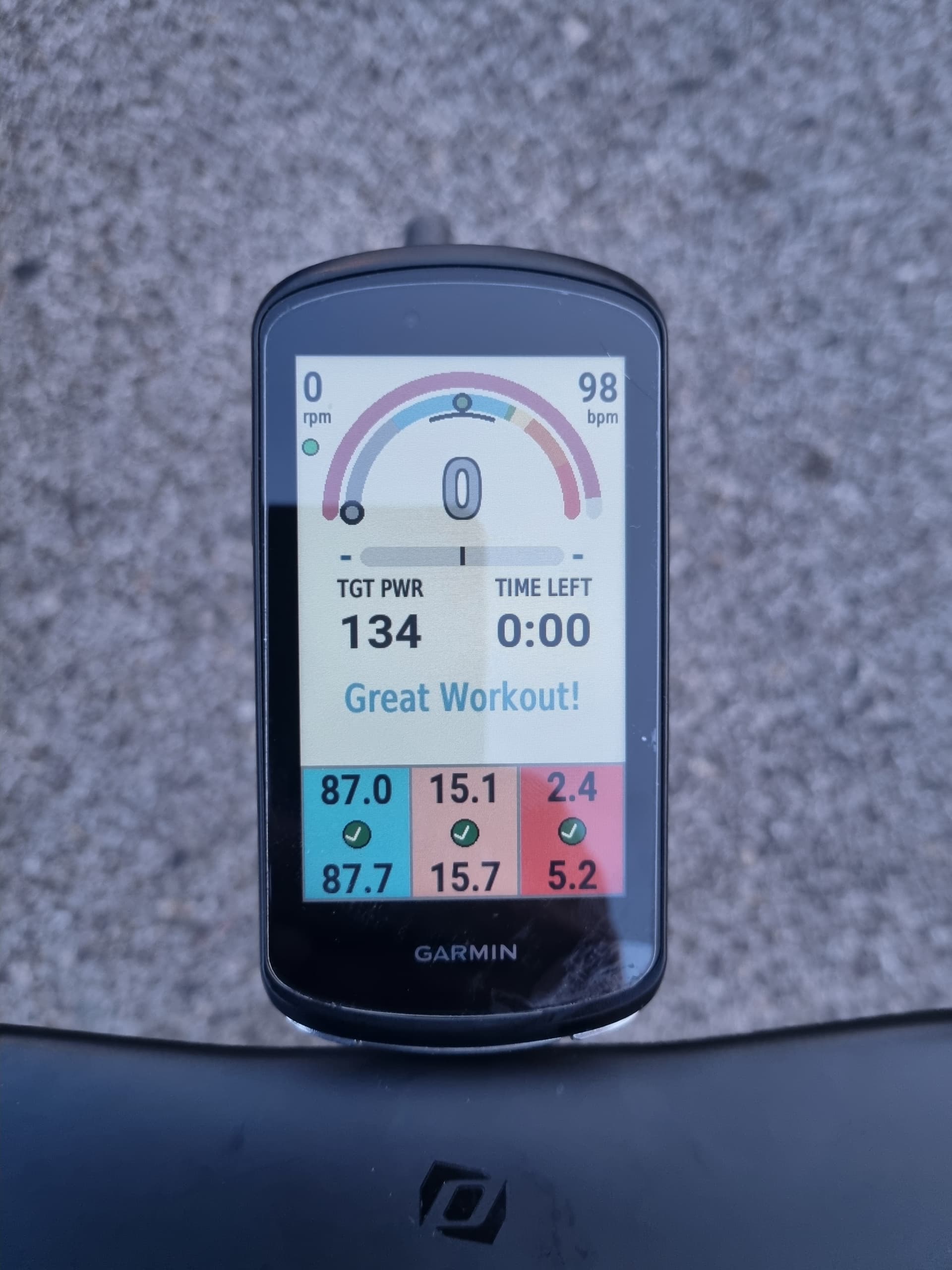

Hi, when I use magic buckets the results shown in the app differ significantly to those shown afterwards on the web. As an example, I am attaching a picture of the completed workout screen in the app, and what the web shows afterward. This is quite frustrating. Is there an explanation to this? Maybe there is something to configure that I am not aware of?

From your screenshot it appears you achieved a Difficult Mixed Pursuiter Ride.

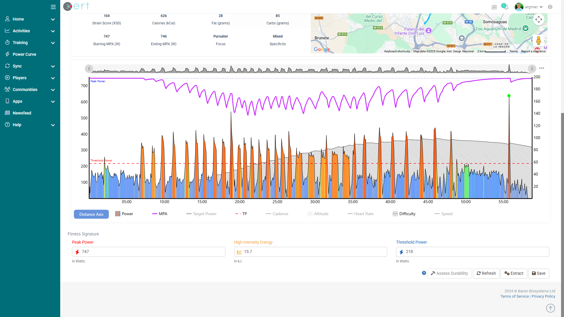

Post two screenshots of your power chart from that activity.
One showing the entire chart and the other zoomed in on 5 or 10 minutes.

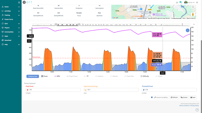

Well, 58 is how Xert’s app counts them. It actually is more or less half that count. It begins with 58 intervals remaining and it starts going down. Normally by two, but not always. I am pasting the graphics, where only the last sprint is a bonus point. The others where all mandated by the app, and the workout is a magic buckets auto-generated workout. Then a zoom in of less than 10 minutes.
