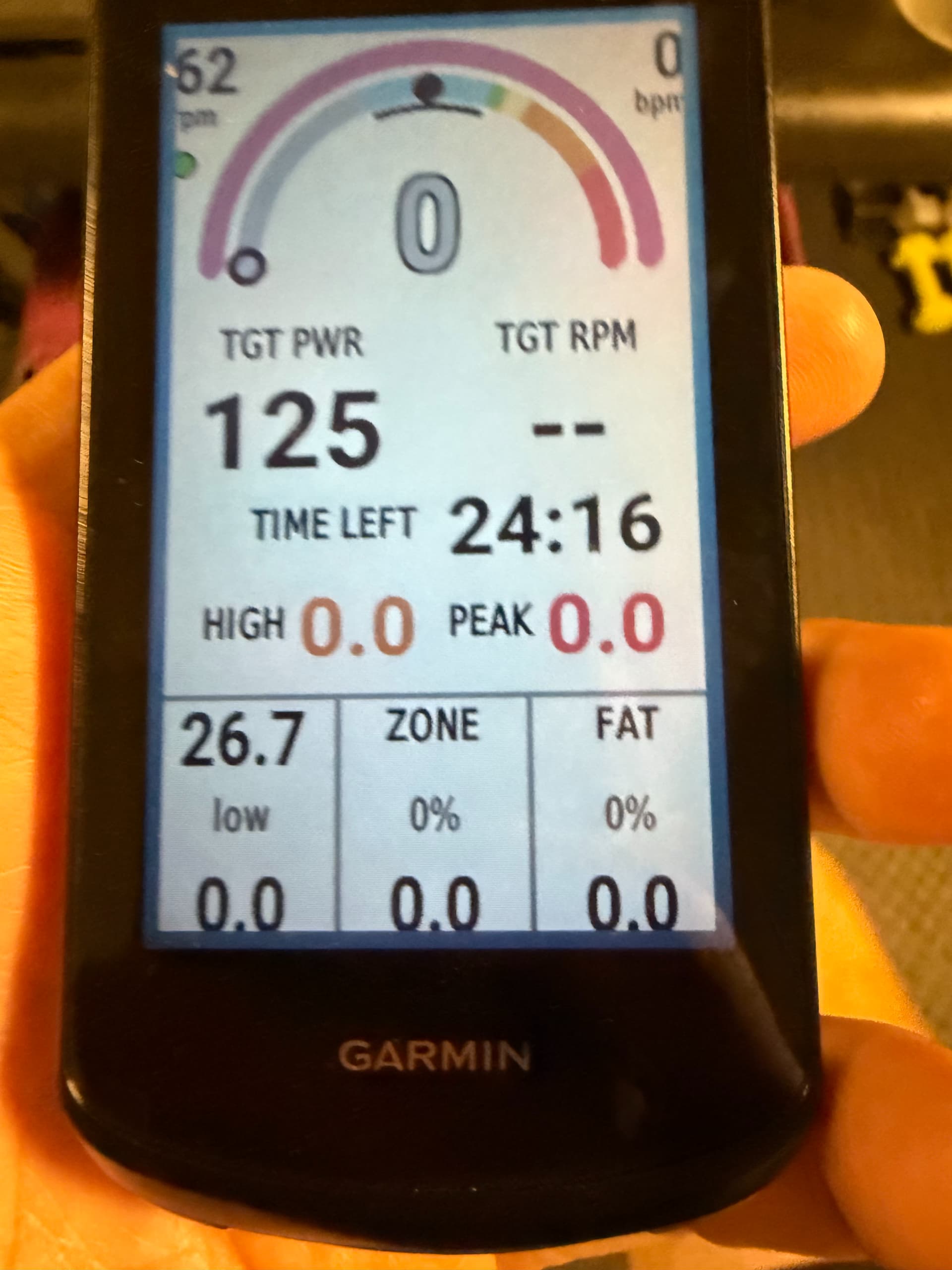

Been using Xert Magic Buckets with my Garmin 1040 for a couple of months and love it. Recently when I look at my planner I see workout numbers “ABC” then when I go for the ride my Garmin magic bucket screen show numbers “XYZ”.
Keeps showing a XSS LOW of 27 at 126W for an Hour. Super chill ride but on any given day I may have actual buckets to fill based on my planner on the website.
Any ideas what I could be doing wrong?

Was out of town and took a few days off the bike. Training status shows fresh, got the the trainer for a hour long planned session that had some buckets to fill. When I powered up my Garmin I got the easy 27XSS workout again. It is basically the only workout my Garmin ever shows now.

Yea it as like 117/5.5/1 for an hour at about 160W. I think I need to log a support case. Thanks

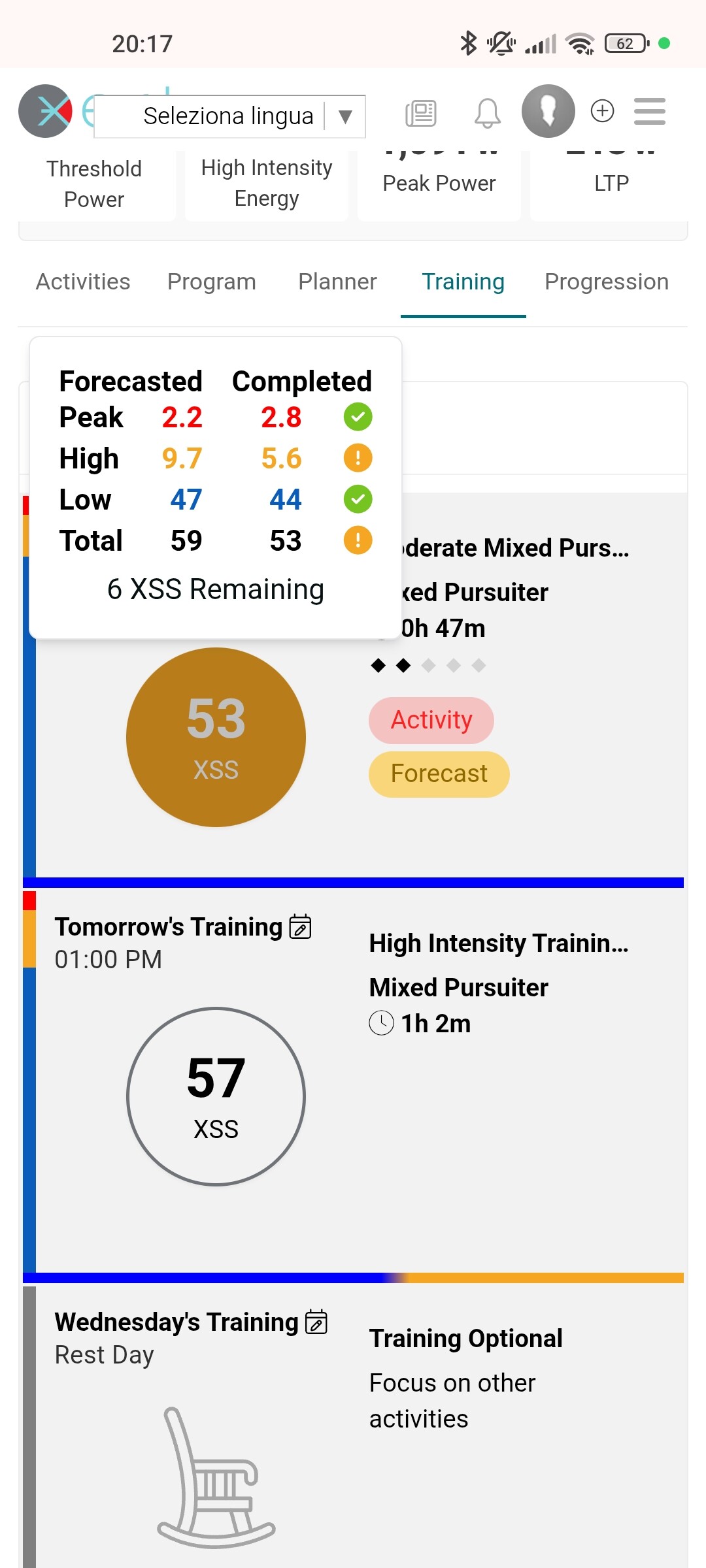

Just went outdoors, filled all the buckets, but in training Page I discovered that I didn’t reach the target :frowning_face:
Did you have a breakthrough? That can cause you to miss targets because Xert calculates on the new signature while MB is using the pre-ride signature.
No BT. I would guess mb target where referred to the automaticallly scheduled wod and not to the forecasted xss of the day.
If you decide you want the top-level XSS target, you should clear the scheduled entry on the Planner before starting XMB.
fair, I planned a mb training but it looks easier as you suggested
