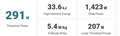

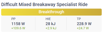

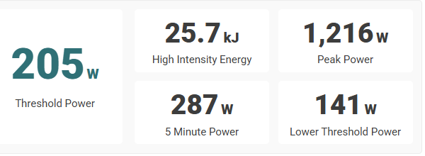

Yes, but there are counterexamples — those incorrect breakthroughs. In the example above, my new TP was supposedly 249 (previously 212), caused solely by a single 10-second sprint at 1200 W. But after I flagged every breakthrough that didn’t involve going to failure and then did a new one — this time actually going to failure — my new signature is only this:
That’s quite a big difference from the previous one, which was clearly wrong (the LTP felt way too high during riding):
So, is it fair to say that “you don’t have to go to failure with Xert for a proper FTP/signature” is more of an ideal — but not always the reality?

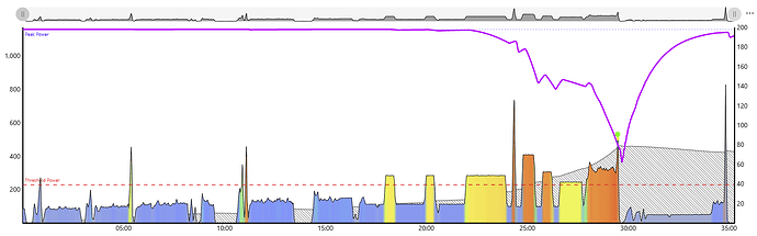

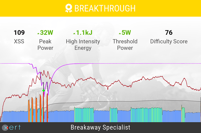

Nothing crazy here, just looked down, saw i had 30 seconds to a breakthrough, and through, ah
 why not give-er

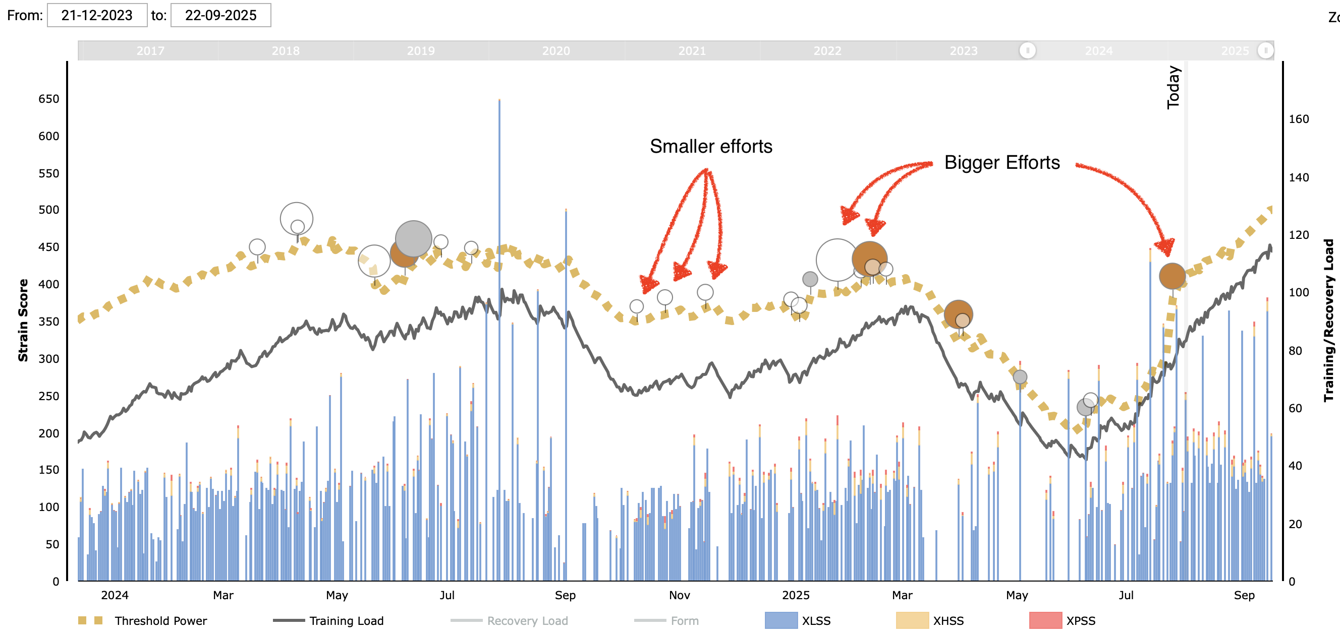

Correct. It’s hard, very hard to extrapolate one’s threshold power from a relatively short sprint effort. Xert also captures what we call Maximal Effort Time, which is how much time you spend very near your MPA. From the glossary post: “Generally speaking, the greater the Maximal Effort Time, the greater the expression of the athlete’s fitness occurred in the activity” For example, a single 10s sprint might not be the best expression of your fitness compared to a hard group ride with many consecutive efforts that push you very close to your limits over the course of many minutes. The latter would be a far better expression of an athlete’s fitness.
In case you didn’t know

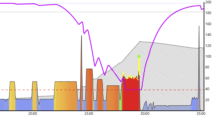

 the size of your breakthrough circles in the XPMC chart correspond to the Max Effort time of that Breakthrough/Near Breakthrough activity. The larger the circle, the deeper you had to go to get that breakthrough (or near-breakthrough) effort. Meanwhile the little “cheeky” breakthroughs where you sprint for a few seconds are seen as relatively smaller blips. Here’s an example from my XPMC:

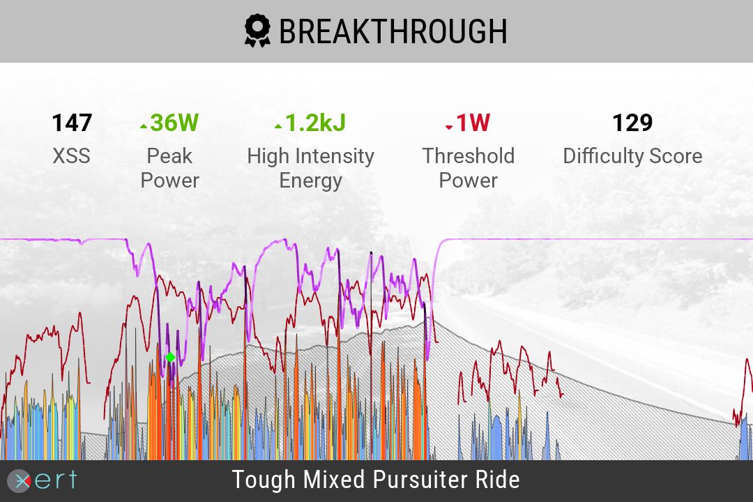

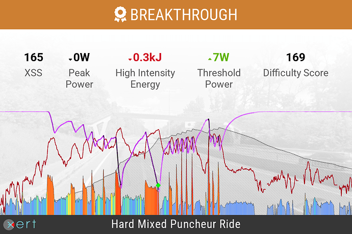

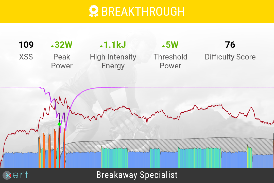

good ride this morning, largest jump in TP so far.
Great job Simon! :slight_smile:
Were you monitoring your MPA during your ride? Or were you just feeling good/pushing hard and it was a surprise Breakthrough once you uploaded the ride?

Thanks, I had the Xert dashboard up on my Garmin, but wasn’t really paying attention to it at the time, just focused on trying to get the top of hill. I did spot the breakthrough icon once I had time to relax and look at the dashboard.

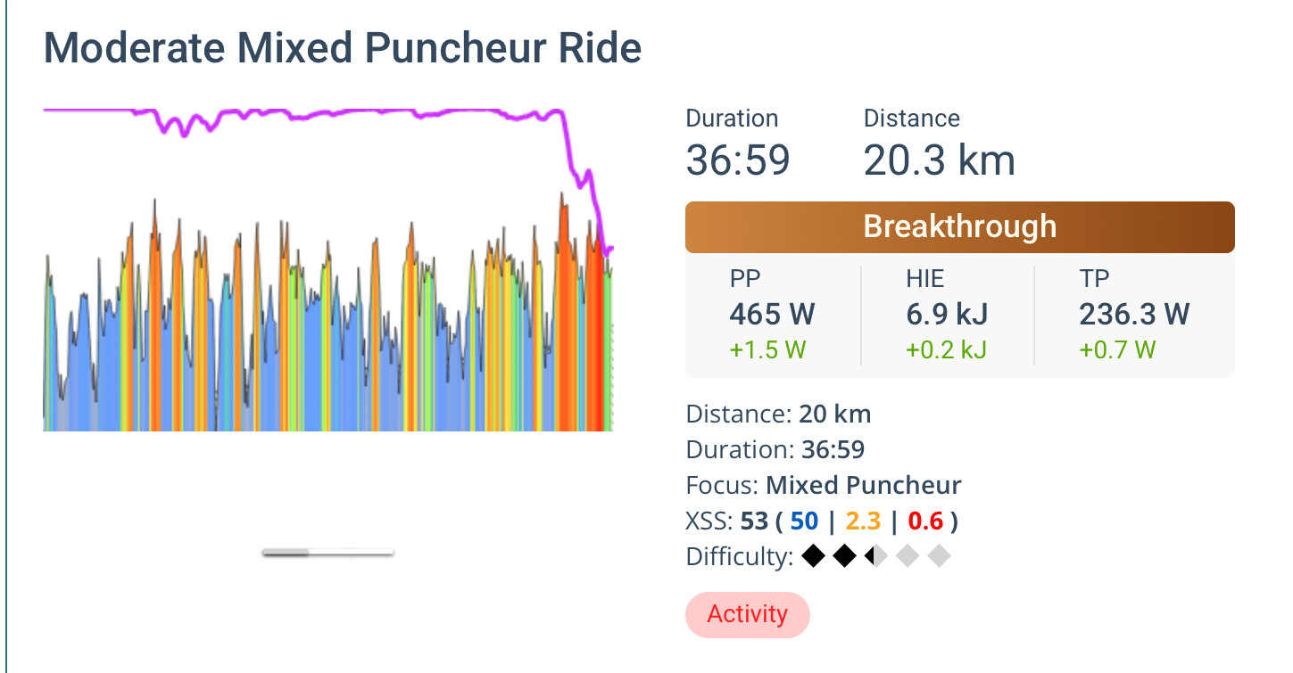

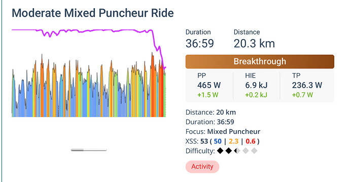

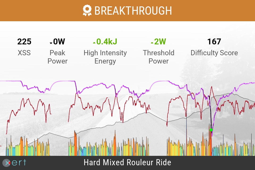

Well that was a total surprise. I was not using XMB so wasn’t watching the Garmin screen. I managed a gold BT without trying !!
Just an easy Rouvy challenge ride and I pushed a bit at the end to catch another rider. The summary told me I had my best 1 minute power in the last month but I thought nothing more of it. Then looking at Xert I saw the BT. By the narrowest of margins on all 3 parameters. 1.5w, 0.2kj, 0.7w.
I would be surprised if there were many gold breakthroughs with more insignificant numbers than mine.

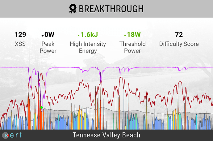

Race in few weeks, today i wanted to check my legs

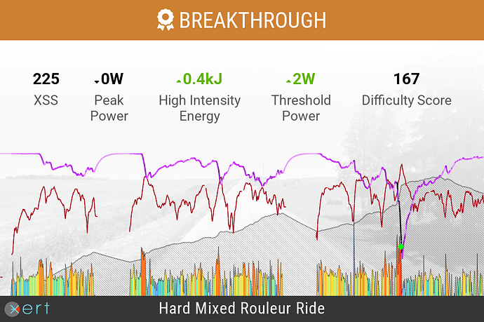

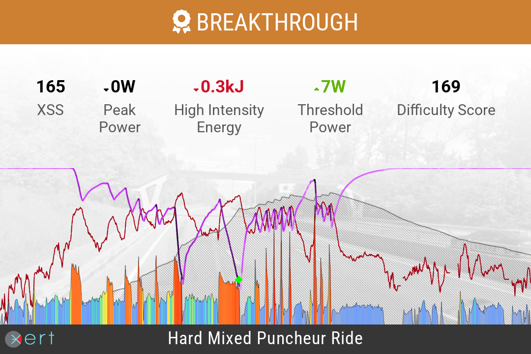

Actually had three break throughs on this ride. a slow draw down up a long hill, then a short respite and attacked again, followed by an all out sprint. So pleased with that as I wasn’t really feeling it at the start of the ride

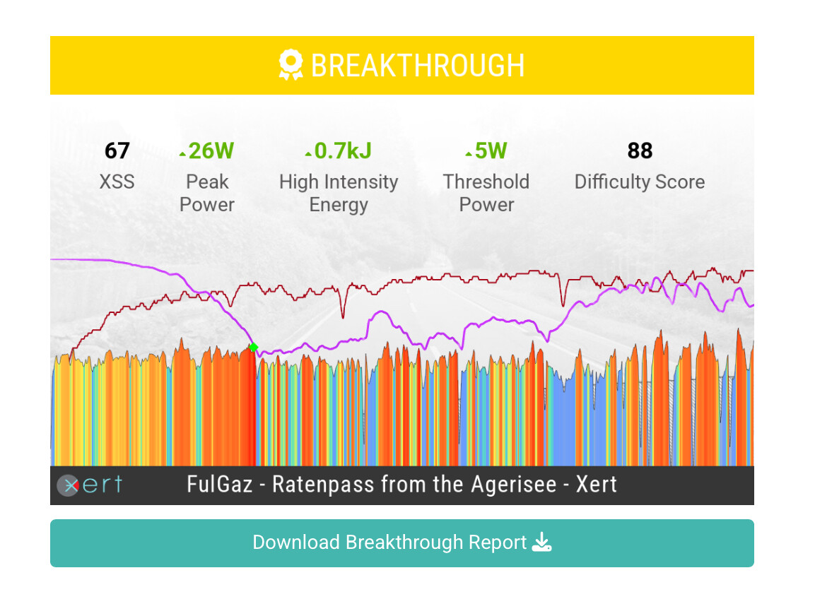

7km ride up Ratenpass in Switzerland using FulGaz.

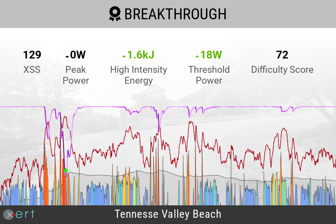

Almost held FTP all the way but cracked in the last km. Still got a gold BT. :grinning_face:

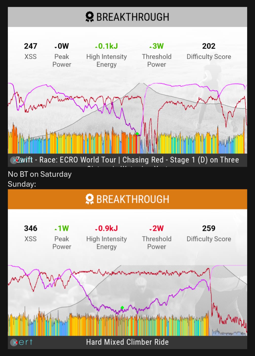

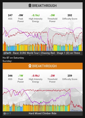

Basically a gold breakthrough spread over a weekend. Especially proud on the bronze one as it was the first time I did the Alpe in less than an hour, and this during a race with already 2 racedays of fatigue in the legs.
Friday:
