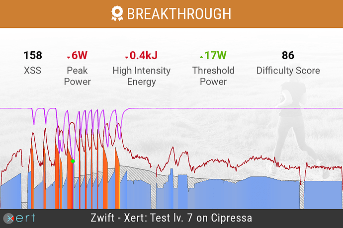

Yesterday I tried the Hardness Test Level 7. Uff it was tough
I have a question, though. For a few intervals, let’s say, half the way through the 3 minutes ones, I have to step off the saddle to handle the power, is that ok, or are all the intervals supposed to be done seated?
Beginner here (3 month into cycling), now with proper power meter.
It was pretty tough, I have to admit. In the last three seconds of the final interval, when I pushed to my absolute limit, I felt like my field of vision was narrowing. Is that still considered normal?

Nice job! This is exactly how the standard fitness test should be executed.
This type of workout is designed to bring you to a breaking point.
Being new to cycling you’re testing your limits and discovering what it feels like. :face_with_spiral_eyes:

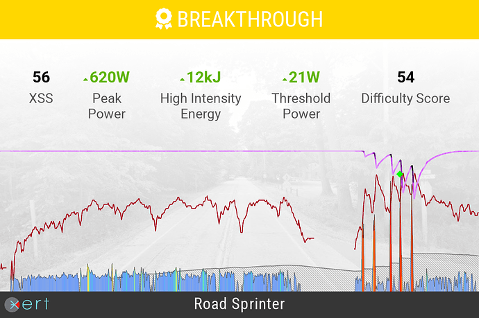

Been on/off (mostly off recently) of cycling for a long time, but starting to get back into it, and remembering that I’m definitely a sprinter and not an endurance cyclist :sweat_smile:
Found a good hill, and wanted to see how well i could accelerate/output (after a good stretch - heavens I’m out of shape) - turns out I’ve been sandbagging a bit maybe in that department :sweat_smile:

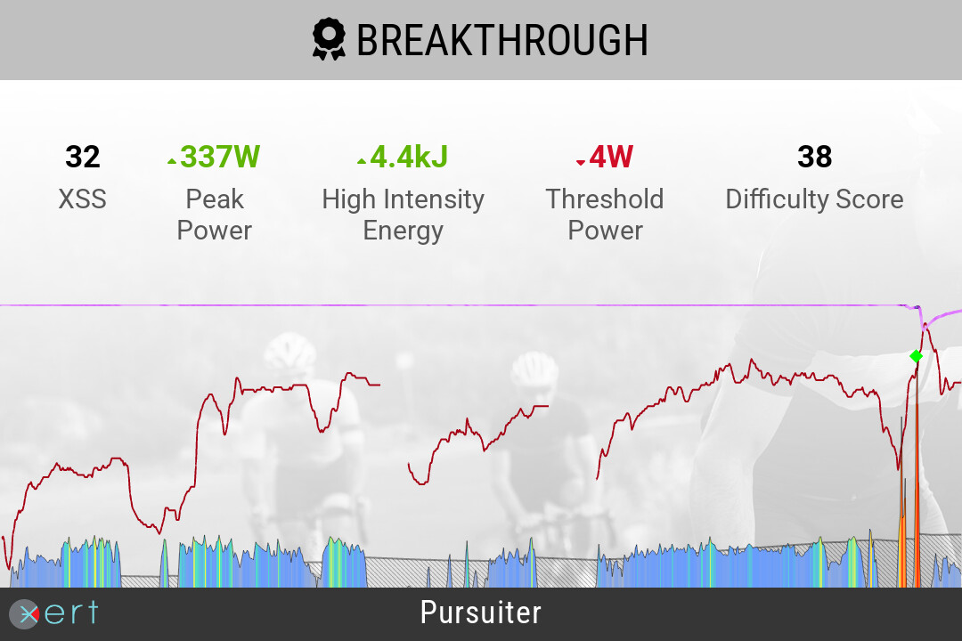

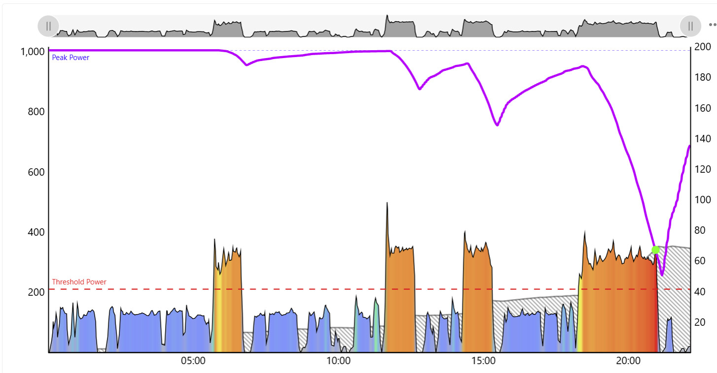

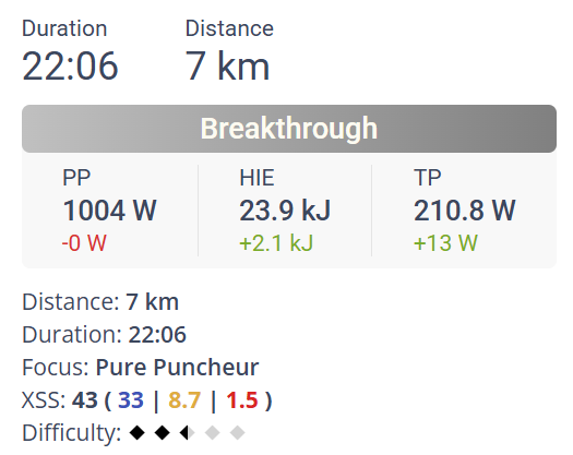

I was doing a recovery ride but I felt like my peak power wasn’t right in Xert (I am still in the trial) so I did a little sprint towards the end and it was very cool to see the app say I had a breakthrough. I like the motivation element there.

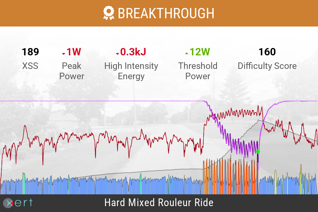

On the way home from work, I was feeling good, so I threw in three sprints at 300 to 350 watts, each lasting 60 seconds. In the last two kilometers, I did another sprint like that—breathing and heart rate were maxed out by the end, but I only stopped because I had arrived home. I think I could have kept going for another 30 seconds.
Does this perhaps mean that Xert underestimates a beginner’s progress, and that accumulating XSS without breakthroughs isn’t sufficient for an accurate TP estimate?
Well done!
To your question: yes, it’s possible that Xert might slightly underestimate your fitness if you’ve been consistently training but haven’t recorded a true Breakthrough in a while. That’s because Xert uses a combination of Signature Decay and Training Responsiveness to estimate how your fitness is evolving behind the scenes - even without breakthroughs.
However, breakthroughs are key signals. The more often Xert sees you expressing your fitness (e.g. when you’re right near your limits), the better it gets at predicting your improvements during periods without maximal efforts.
So keep it up! Maybe next time you’ll push just a little further past the driveway for a bigger breakthrough! :wink:

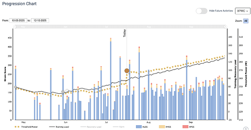

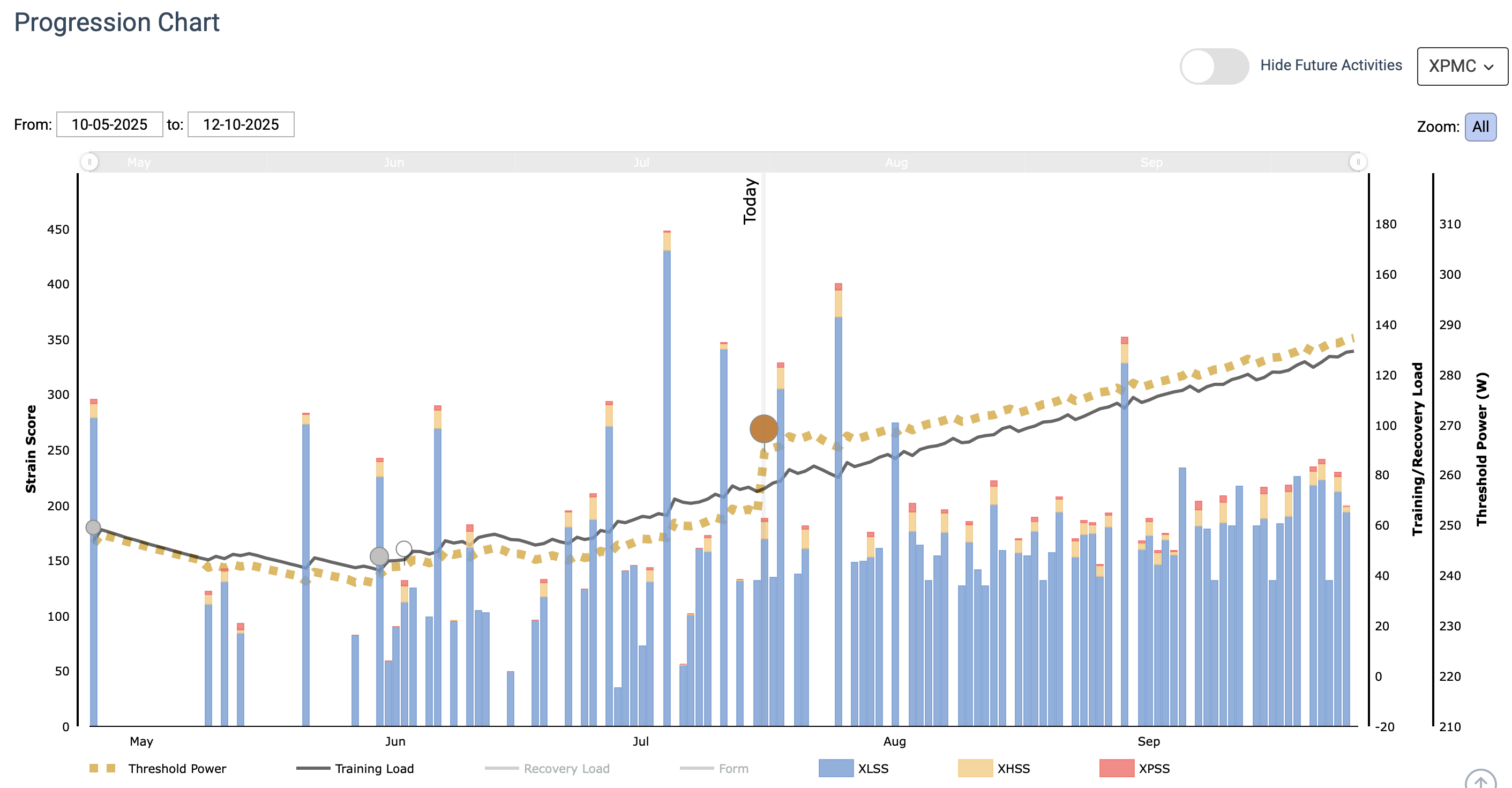

Progression Chart (Last 3 Months)
Still making progress towards my Forecast AI goal of increasing my 8 min power by early October (and hopefully finally reaching 4-star status)! What’s been working for me so far:
:white_check_mark: Getting out consistently for a longer ride on Saturdays
:white_check_mark: Filling XSS targets on HIIT days with Magic Buckets
:white_check_mark: Keeping Low Intensity Days Easy

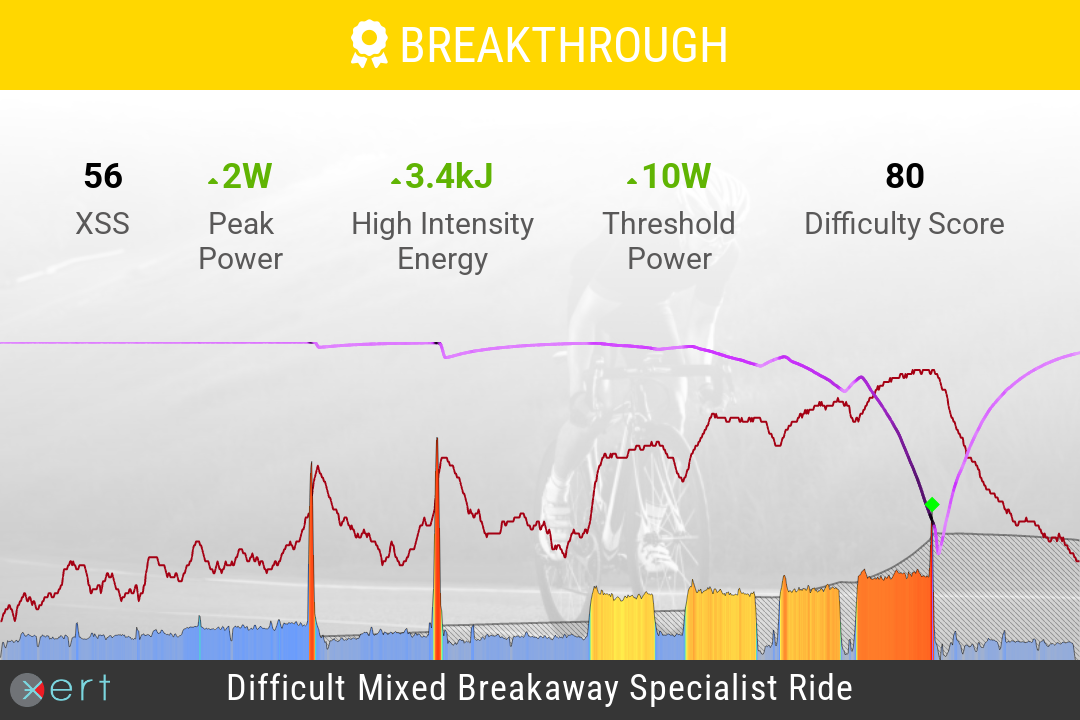

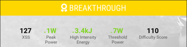

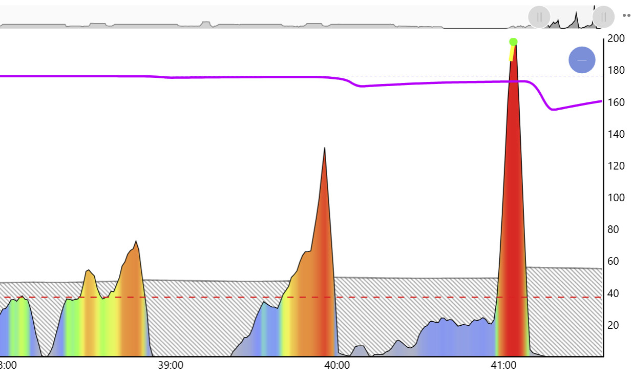

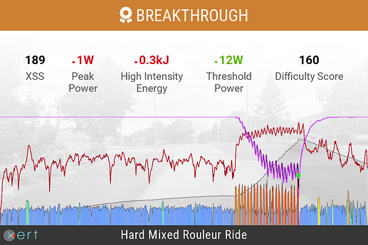

A short max effort that abruptly ends without a natural point of failure can trigger the algorithm to issue a BT.
In your case it was a longer effort that flatlined MPA for the requisite BT (a legit one).
To see that moment in action, view activity details and select Previous button under the chart.
Whenever you feel a bump in a signature value isn’t justified, you can flag the activity.
That removes the BT adjustment while retaining the strain score analysis.

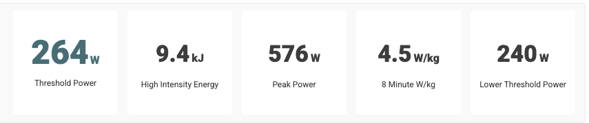

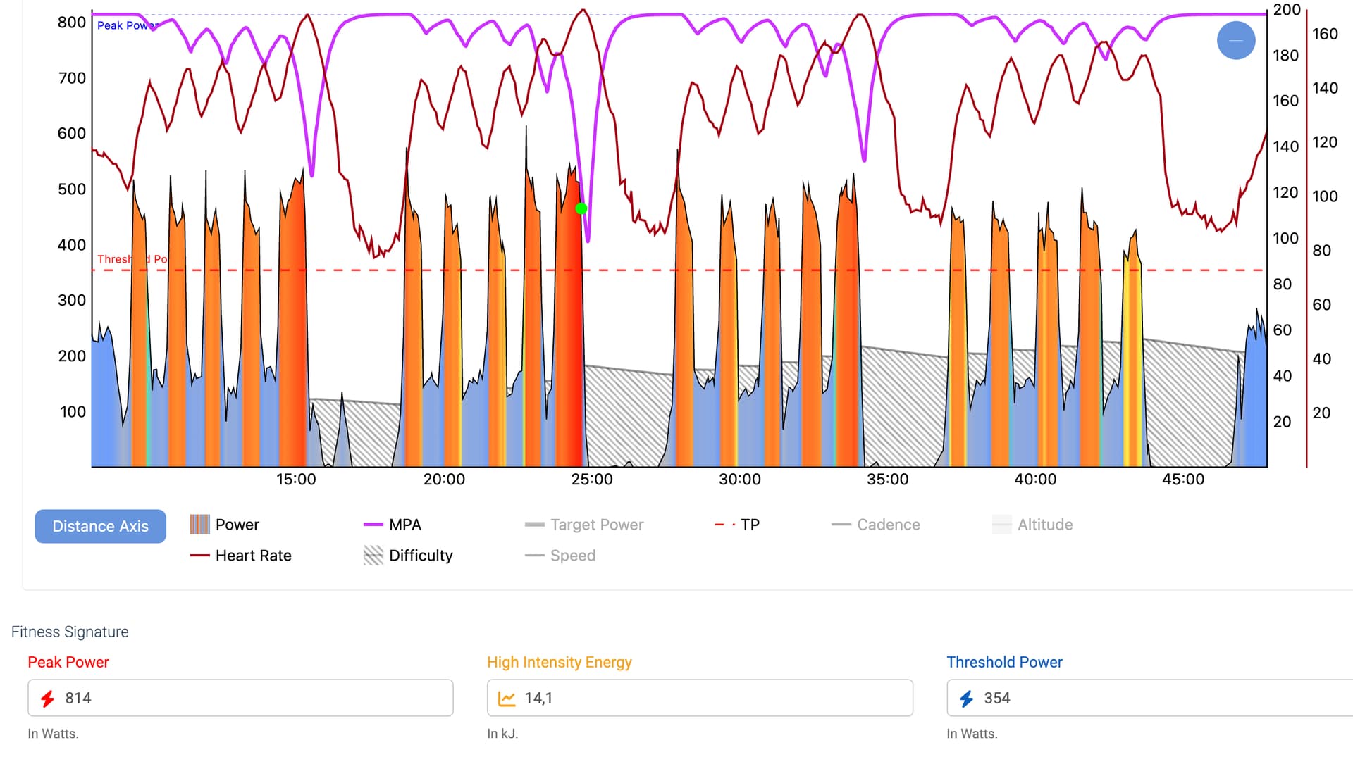

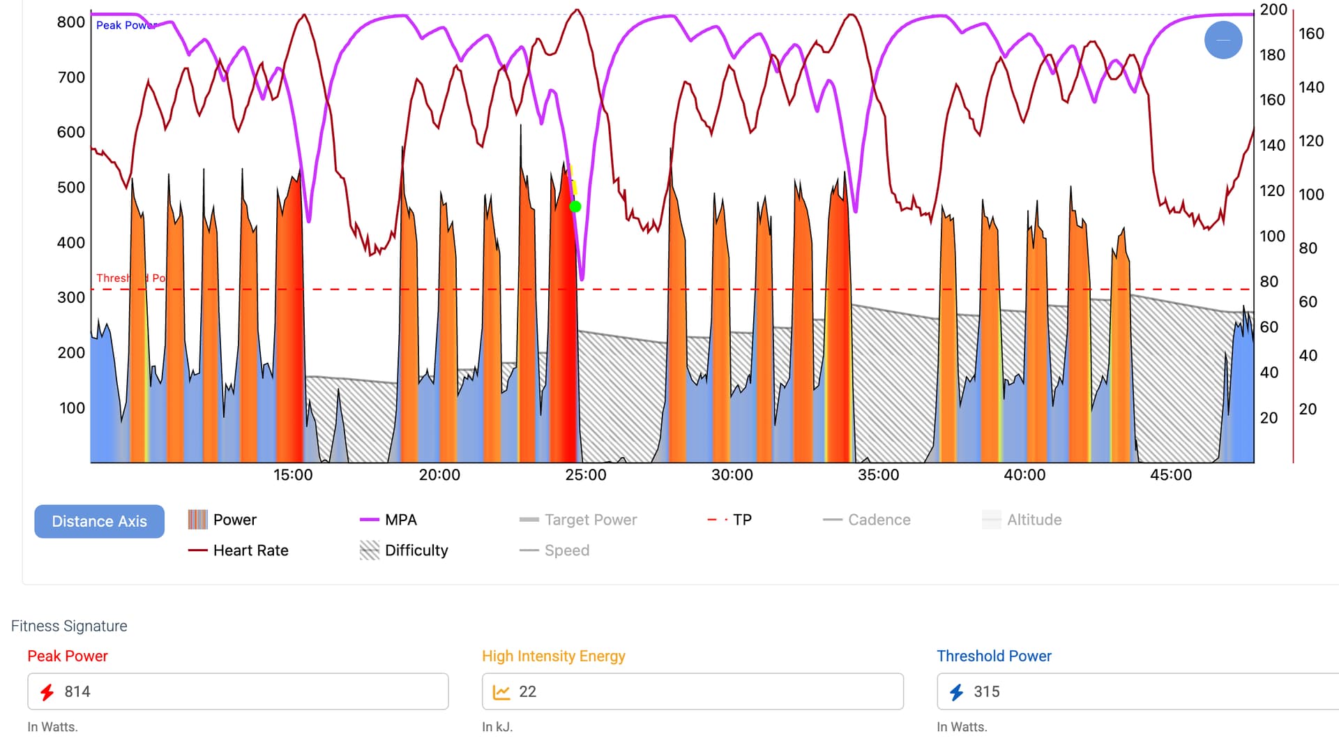

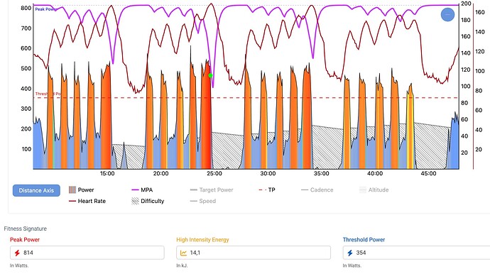

I have been running with a fitness signature at around PP=814 W, HIE=14.1 kJ, and TP=354 W for some time (which is shown in the first image below). This was identified by the algorithm by a breakthrough done outside during magic bucket intervals multiple times on the same hill. I have got similar fitness signatures on breakthroughs inside. 814 W is close to the max power I have ever been able to put out both inside and outside (standing and using the handle bars), so I assume that is accurate enough.
I am however struggling to hold 354 W for longer durations, thus I am wondering if my signature is a bit skewed towards high TP and low HIE. If I adjust the TP to 315 W and HIE to 22 kJ while keeping the PP I guess a reasonable match for the breakthrough activity (second image below).
What is the best test I can do to get the correct ratio between the HIE and TP?

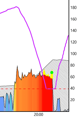

I reached 167 bpm, 169 bpm, 167 bpm, and 157 bpm as max for each of the sets below, so it makes sense that I got the breakthrough on the second set. However, the first and third set should probably not be too far off. It should also be noted that the green dot was at the top of the hill.
On the contrary: I think this BT shows that my FTP is still slightly underestimated. It’s probably closer to around 220 in reality, since I wasn’t yet at my physical limit during the intervals.

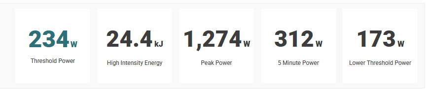

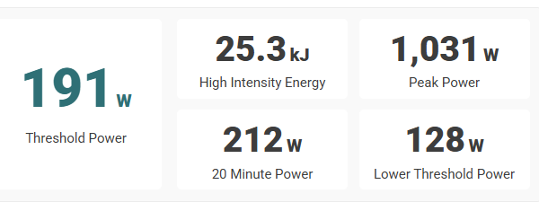

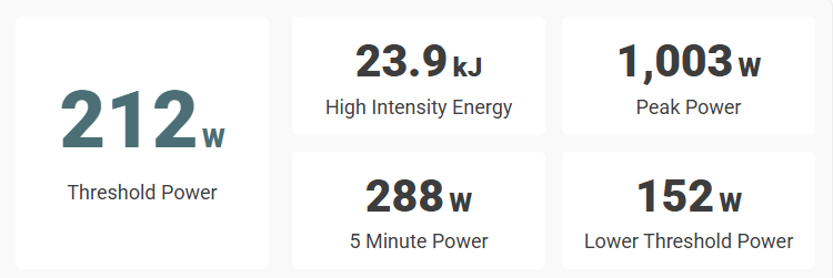

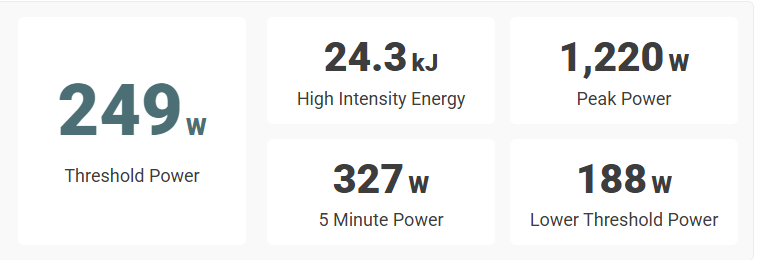

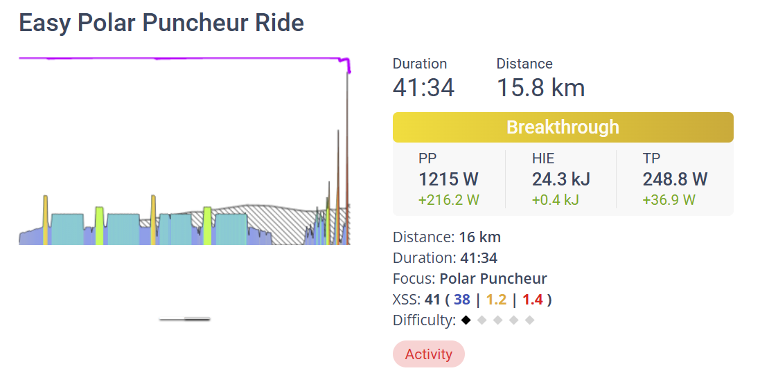

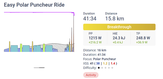

Did a spontaneous short trainer session in Zwift today — everything was properly calibrated, and the power data looks solid. Tough but productive workout. After a quick break, I felt like finally locking in my true peak power in Xert. I’ve known from past tests that it should be around 1200 W, but Xert always down-adjusted it because the sprint wasn’t long enough. This time, it stuck.
Now here’s the unexpected part: Xert not only updated my PP to a realistic value, but it also bumped my TP (and LTP as a result) by nearly 37 watts! I was already pretty sure that my TP was higher than the previously estimated 212 W — but that much higher? The entire breakthrough came from just this one sprint.
Can it really be that my LTP is now 188 W? I know I could flag the activity
 but should I? What would you do in my shoes?
This is the previous graph, before adjusting the signature.
And here ist my signature with this activity flagged:
I’d flag it and adjust PP to the number you want to use and click Save (lock).
Xert will use that signature as the baseline moving forward.
Future BTs (or increase in TL) will raise TP when warranted.
You can check your LTP by riding a “free ride” workout in Slope mode for 30 minutes or more.
Settle into a comfortable pace using gears/cadence.
RPE will confirm what level watts push you past relaxed conversational breathing.
This assumes your trainer setup includes sufficient cooling. :slight_smile:
Thanks. Could you elaborate further on why you would flag this activity? There were no technical issues, incorrect power data, or anything like that. So what would be the objective reasoning here? For me, the fitness signature and the derived workouts are a key feature of Xert, which loses significance if I have to flag breakthroughs even though there were no recording errors.
Would you say I should potentially flag anything where a significant increase is based solely on a peak effort that only lasted a few seconds? Or what’s the general rule of thumb here?
The effort should be to failure. Do a hard sprint and then follow that with a sustained effort, 2-10 minute power would be a good starting point, to failure.
See these links on how to optimise a breakthrough.
Ok, but even if I had continued riding after my 1200-watt sprint — for example, holding 300 watts until failure — it still would have resulted in the same Breakthrough (or perhaps an even bigger one). So how does your comment apply to my original question?
Depending on how long you hold the 300 and how fast you drop off towards the end of the effort you might have a larger increase in HIE and a smaller increase in TP. I don’t remember the exact formula but increasing HIE at constant TP results in a lower LTP.
