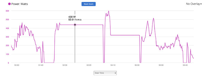

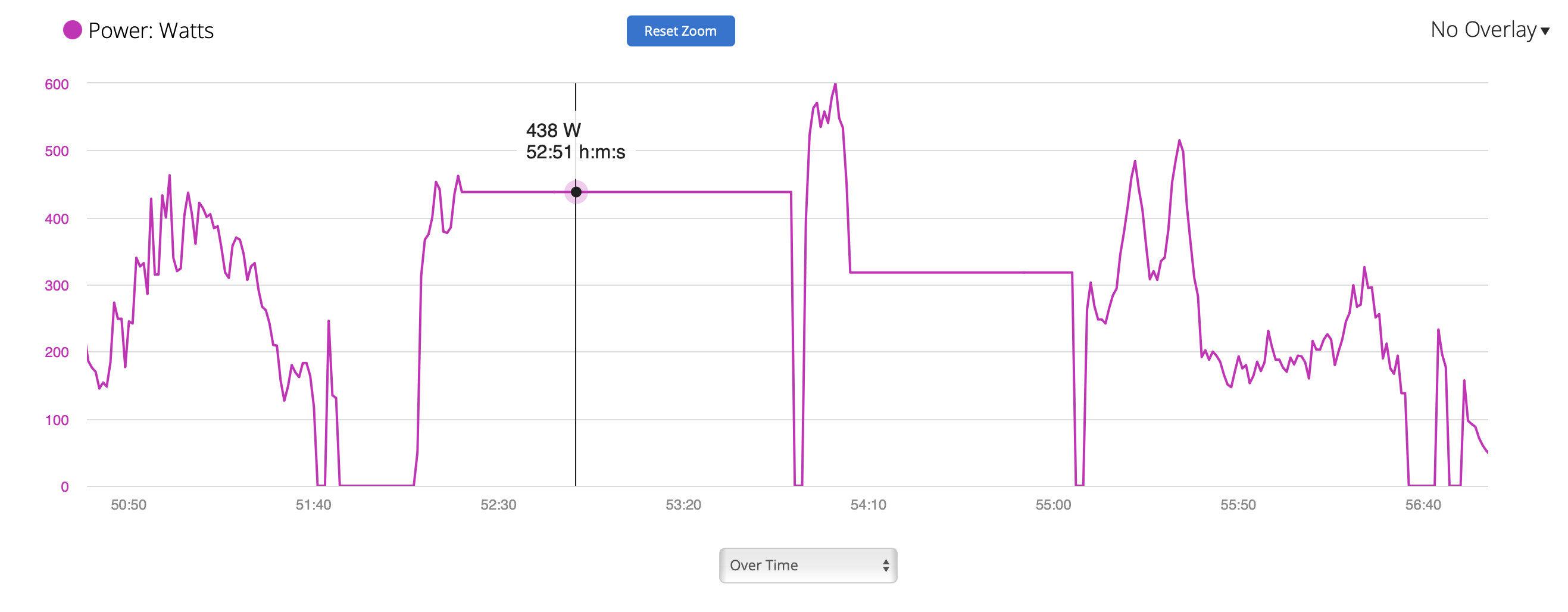

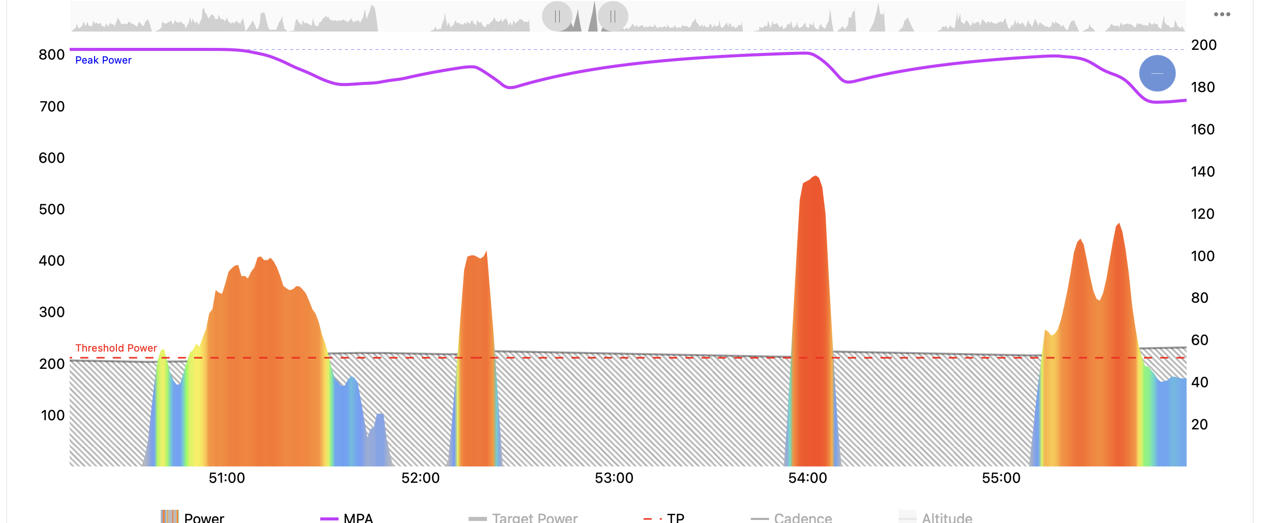

I think I got to the bottom of this. Looking at the data on Garmin I see a ~3 minute period where it looks like the power meter froze, constantly reporting the same value.
But in Xert, it seems like it spotted this was bogus data and dropped it
