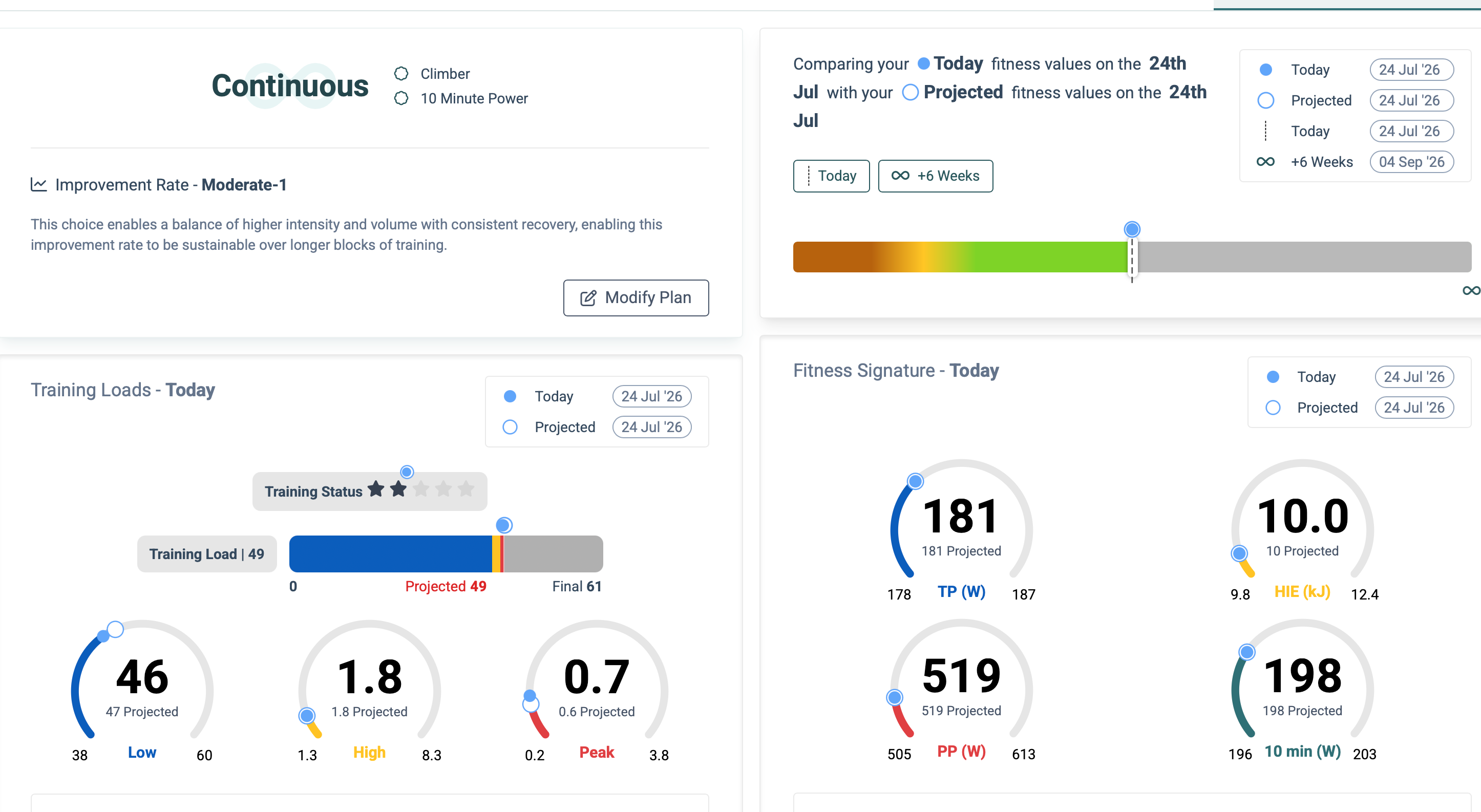

XATA Continuous is a focused progression under your control associated with a Focus Duration (Climber/10-min power), Improvement Rate (Moderate-1), and recommended workouts based on your Training Status (stars count) and calculated form (tired/red to fresh/blue).

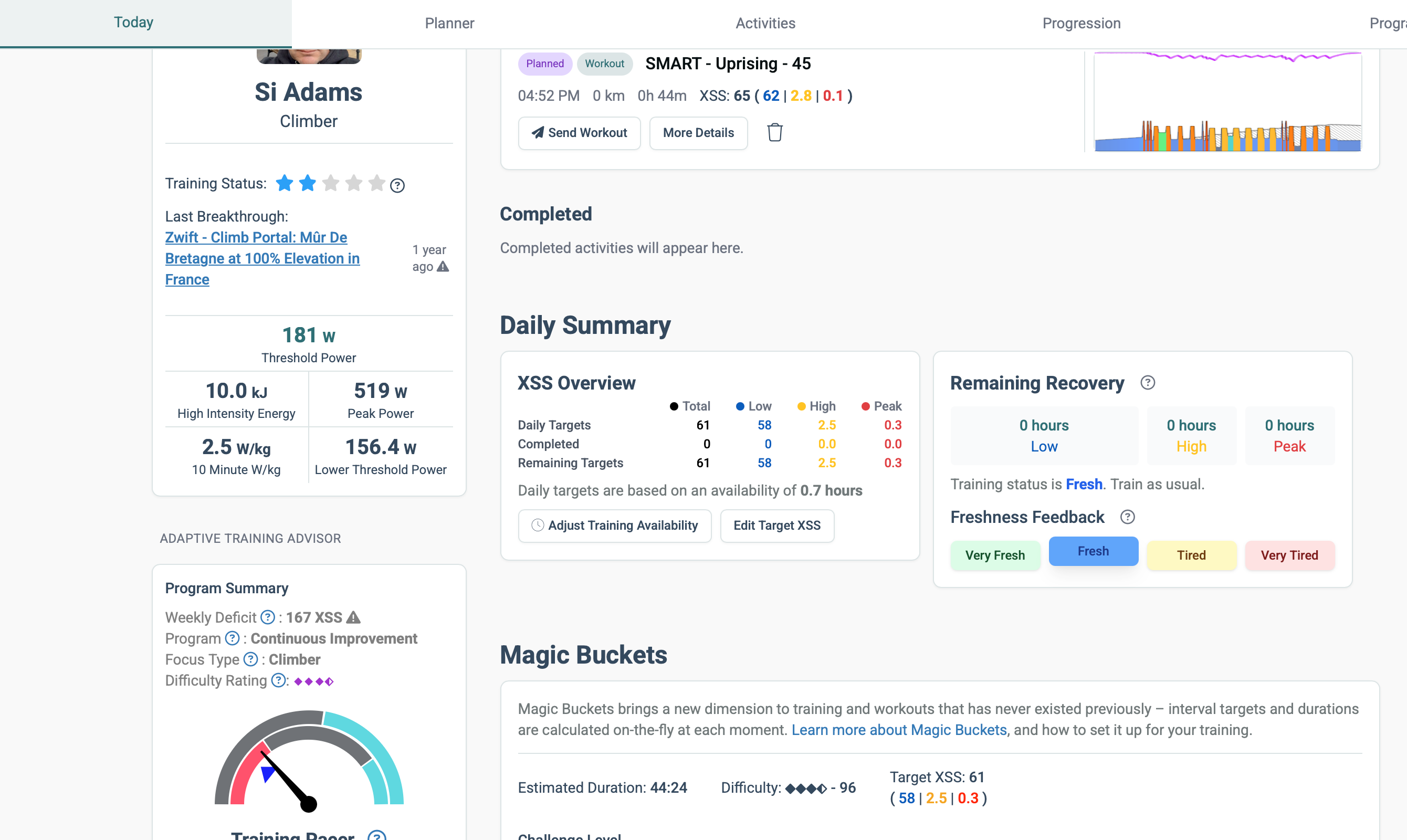

For now, I suggest you disable Automatically Schedule under Planner Settings.
Also set Availability to default settings if currently defined (reset = Available, Use Advisor, Flex).
Ride the daily routine you want to establish for the next two weeks.
Use Filter to select workouts at the duration you prefer that day. Plus, whatever the weekend group ride entails.
XATA will recognize the Training Load (TL) pattern you’ve established and make recommendations moving forward.
Keep the Training Pacer needle within the 11am-1pm position to maintain the ramp rate you’ve set.
The daily deficit/surplus value is relative to Noon (neutral) and does not carry over from one week to the next. No need to clear a deficit each day.
If consistently dipping towards red, lower the ramp rate.
If you need to take a break at any time you can change IR (Improvement Rate) to Maintenance or Taper. Scale back hours or take extra rest days until ready to resume a progression.
Next enable Automatically Schedule if you’d like. That randomly selects from top recommended list entries each day. You can always change your mind and select an alternate if you don’t like the selection. Or ride less or more as your schedule permits.
XATA will adapt to whatever you decide to do. :slight_smile:
