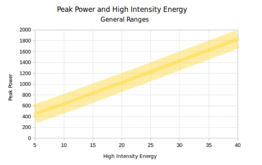

When ready to add HIT, you can jump start your signature validation by riding a fitness test workout in Slope mode.
You can use this chart to plug an HIE value.
