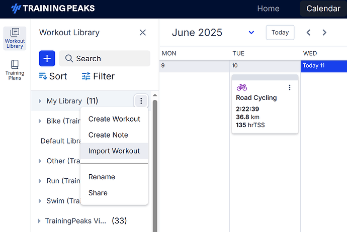

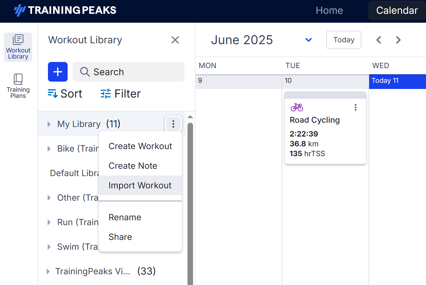

Yes, you can upload .zwo files directly into Training Peaks.
In TP, go to the calendar page. Open the “Workout Library” from the left sidebar. Hover over “My Library” to trigger the “more” vertical ellipses icon then click it. In the context menu that appears, select “Import Workout”.
