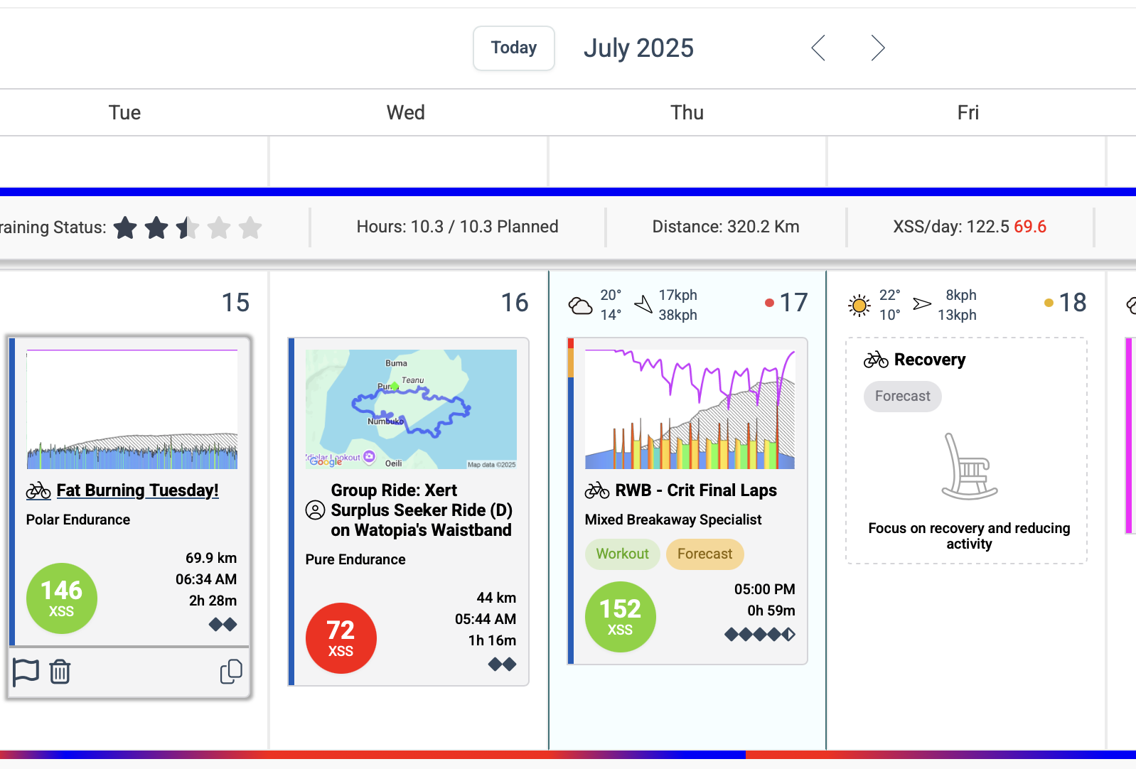

It would be nice to be able to move workouts around within a given week.
For example, the AI is telling me to do a workout today that could be completed easily indoors while tomorrow is over 2hrs and would be preferable outdoors. It’s a beautiful day today but forecasted for high winds tomorrow so i’d like to swap the order of the two workouts without adapting the entire program.
Is there any way to do this?
Yes, more or less. Start by finding a workout for both days using the standard Choose Training dialog. Once you’ve identified suitable workouts for each day, open the dialog again and select the workout recommended for the other day. Afterward, pin both workouts and click Adapt Forecast.
Note that this is not always recommended, so check the predicted training status before each workout. For instance, it might be okay to do 100 XSS today and 300 XSS tomorrow, but if you do the workouts in the opposite order you might start with a red training status on the last day.

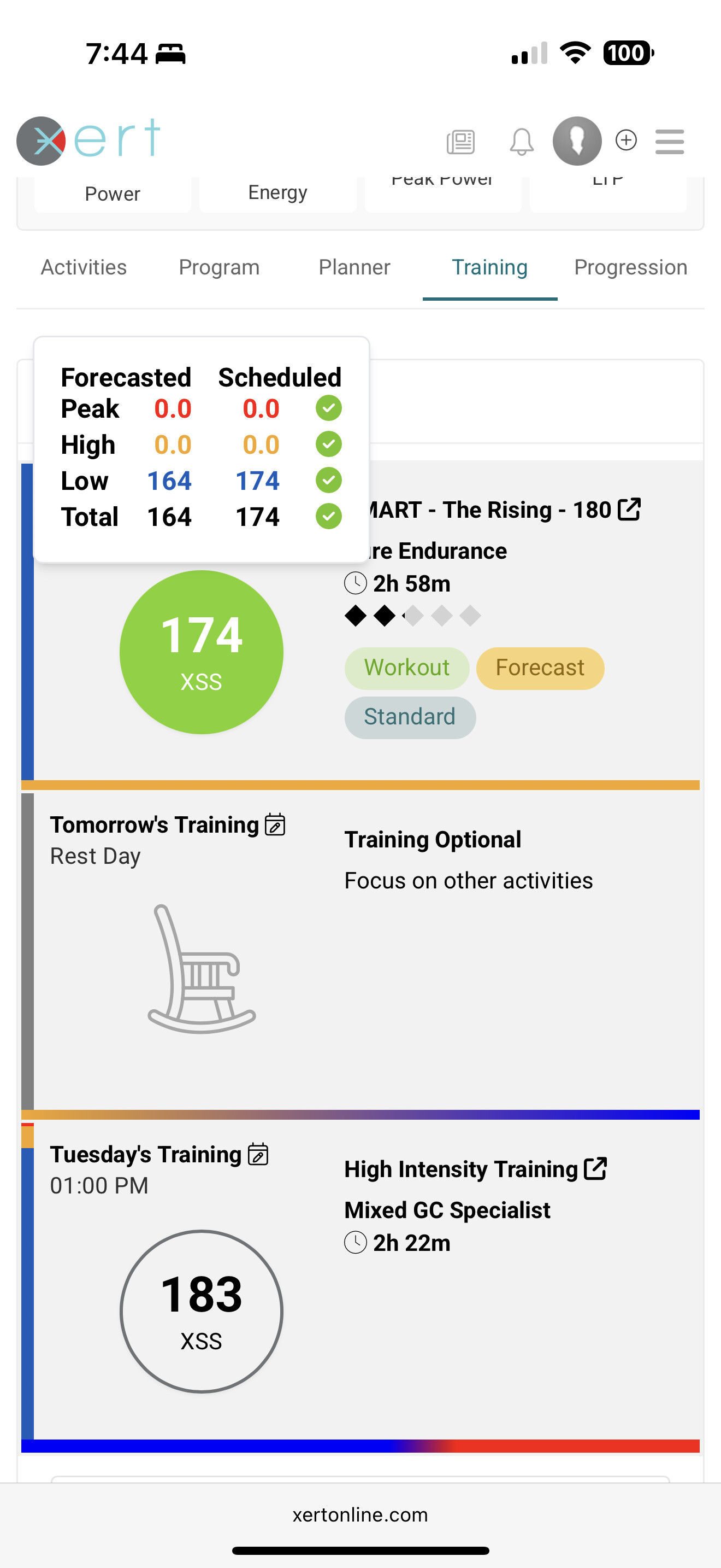

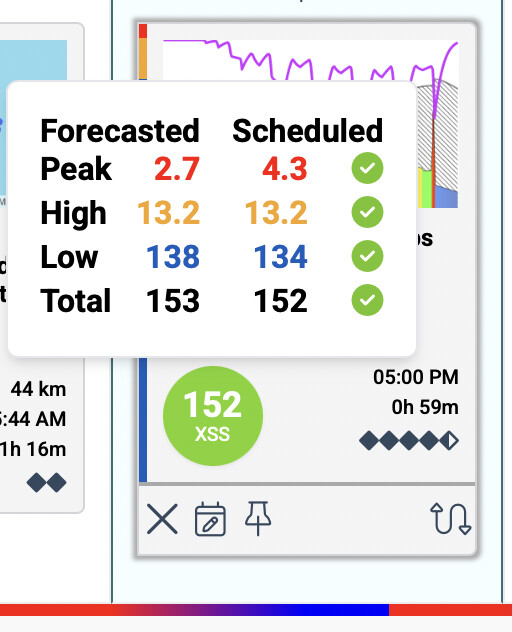

Using FAI plan, I’m confused as to why today’s xss requirement is showing as green when I haven’t worked out today yet. Looks like it has something to do with the “scheduled” without matching the goal. Not sure I get this logic though because I don’t like looking at my training page and getting the sense I’ve already done what I needed. What’s going on here?

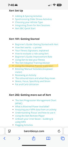

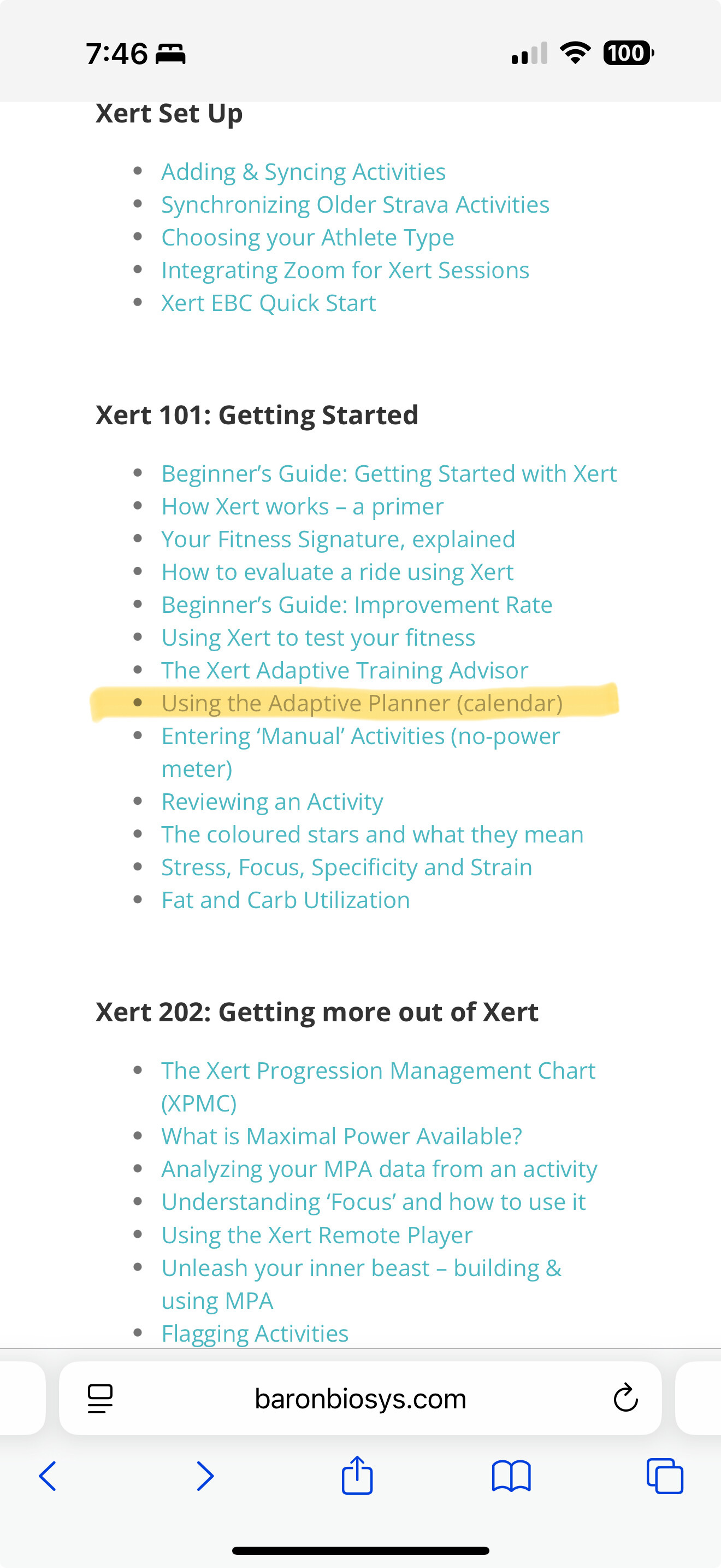

Tried figuring this out myself but having trouble locating documentation in the support pages that covers it…. Is there an article or video that goes over the Training tab when on an FAI plan?

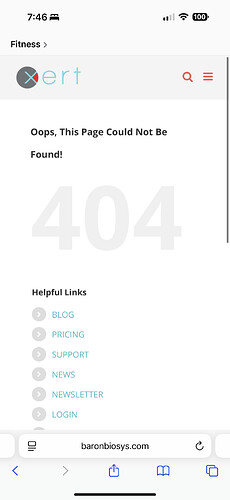

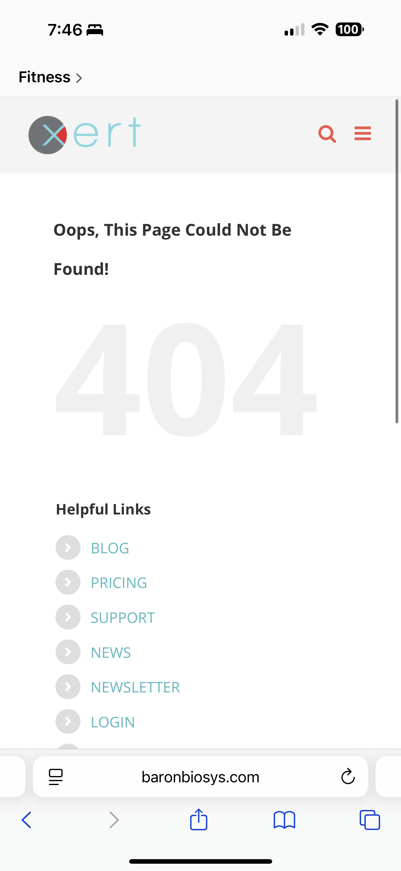

Thought maybe this article would help but it’s a 404:
You have the option for Scheduling Workouts set to ON. This results in what you are seeing. It grabs a workout or prior ride that comes close to what is Forecasted. For me it always resulted in less than the Forecasted XSS vs what you have here, more. If using MB it pushes the scheduled workout metrics which is annoying. I turned this OFF but forgetting where that setting was. :slight_smile:
This is intentional - it allows you to preview and see that your training aligns with the recommendations for the day. Clicking on the XSS circles in the planner will show the Forecasted Low/High/Peak, as well as well as the completed or scheduled Low/High/Peak:
I still need to complete my training today, so it shows as Scheduled for now, but will update to Completed once my completed is uploaded:
Assuming I do everything as planned, I should keep the green circle, but if I do significantly more (or less), then the circle might update to show orange or red.
