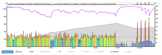

However, I’m struggling to understand how Xert analysed the ZRL TTT I just did. It has a difficulty rating of 238, which is very high, right? Still, no breakthrough (even though my power hit the MPA briefly). I am wondering whether this makes sense: Even though breakthroughs and difficulty do not need to go hand in hand, shouldn’t breakthroughs happen (almost every time?) when difficulty is extremely high (difficulty = 238)?

Activity Link: Xert - Activity | Hard Mixed Climber Ride

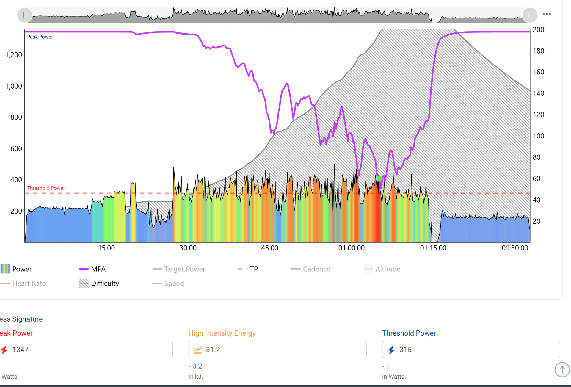

My last BT was 5 days ago. Maybe it’s relevant that I had to pause cycling for 2 weeks in November/December. My Xert TP was 330-ish before. Now it’s at around 315. Yesterday’s effort was 315 avg for 45 minutes, and it was full gas; I got dropped.
If I set the TP to 320, the difficulty is still 188. At 330 (which is definitely above my current FTP), it would be 133.
Above 200 is rare but definitely possible with MPA drawn down on a long all-out effort.
