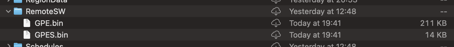

I have been using WindField and it was making issues. I have 2 files in RemoteSW. Don’t have RWSoftware folder
You are correct. The folder on 1040 is called RemoteSW like it is on my 830.
RWSoftware is used on some other Garmin devices.
The two bin files are normal indicating two different satellite data files, so #1 isn’t going to help in your situation.
