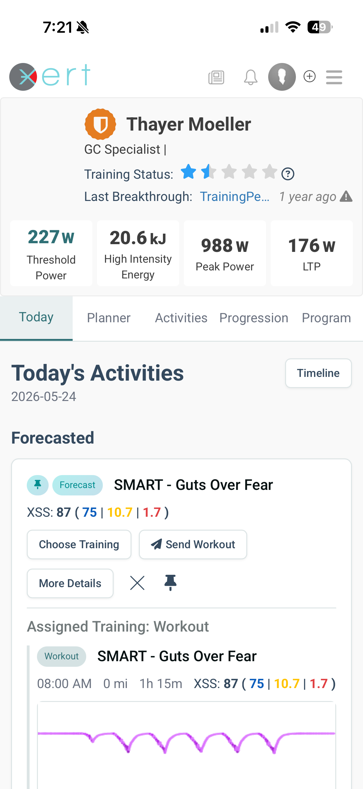

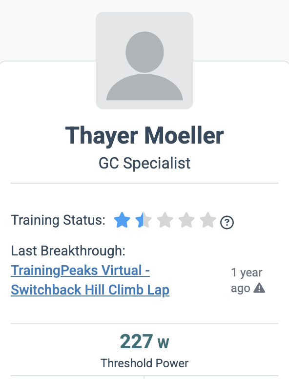

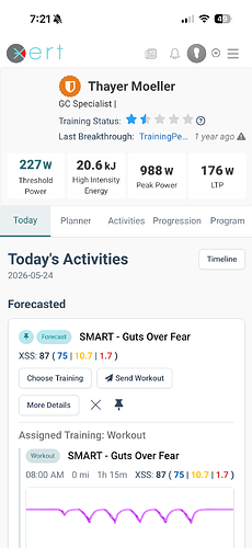

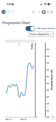

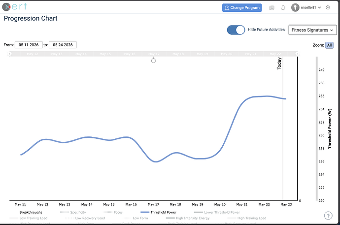

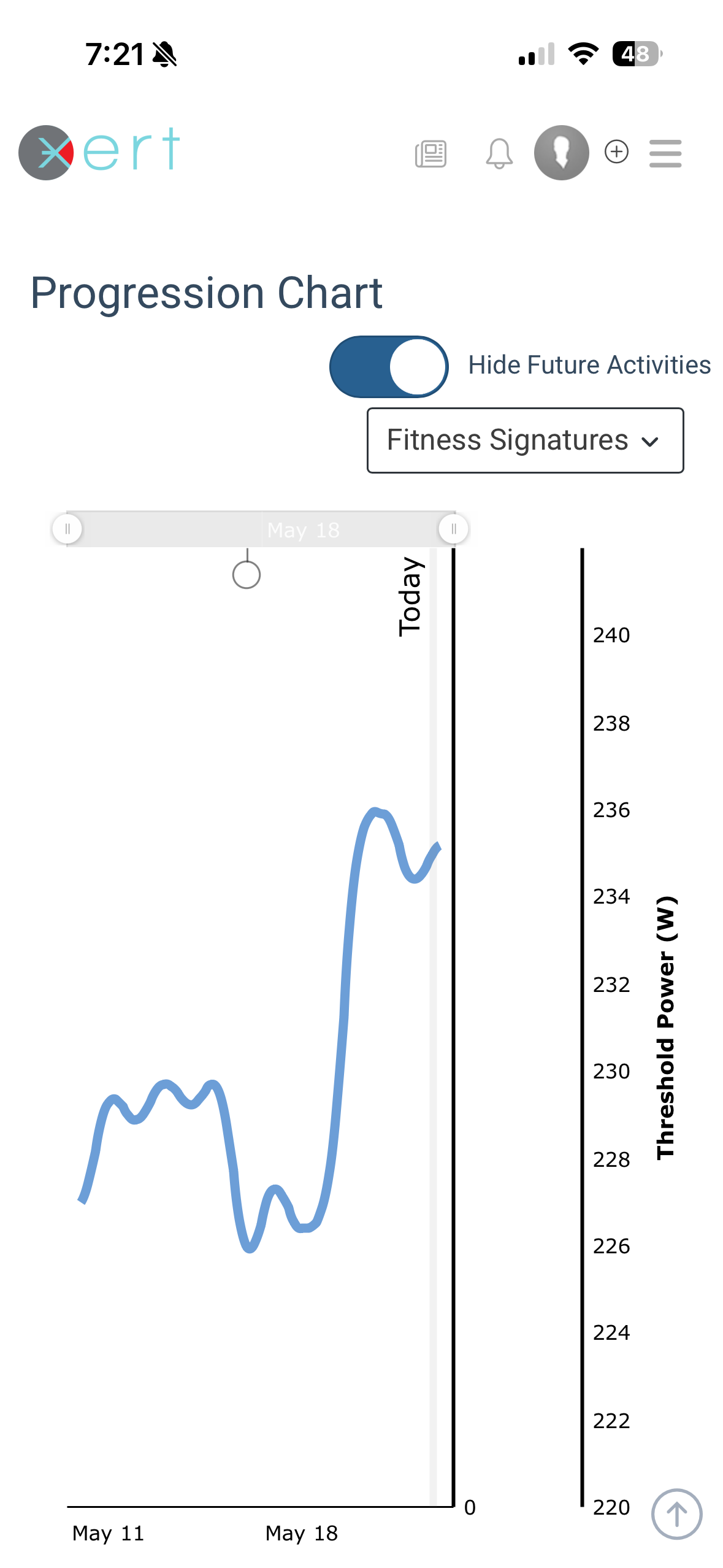

FTP on the Progressions page doesn't match the FTP on the Today page
Perhaps this is by design, but I can’t think of a logical reason why or how I’d interpret two different FTP numbers. You’ll see the Today page has me at 227W versus 236W on the chart on progressions. If it matters, I am currently on a Forecast AI training plan. Any insights?

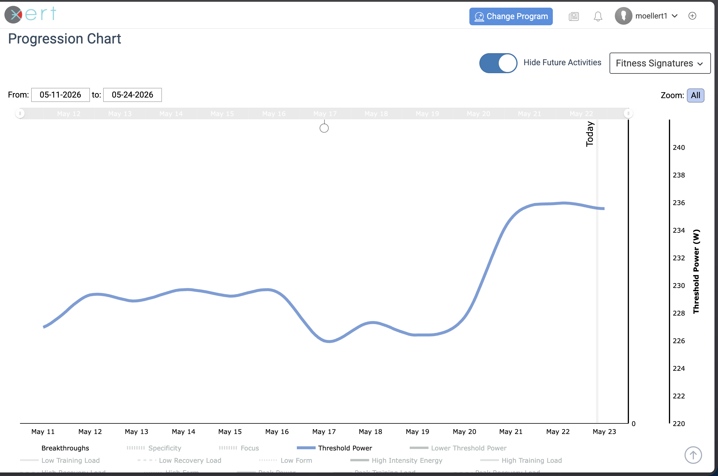

Steps –
  1. View Today page TP value (also shown at top of Progression page).
  2. Select Progression tab.
  3. Set to Past 2 Weeks, enable Hide Future Activities, chart type to Fitness Signature.
  4. Turn off all keys except Threshold Power.
Does TP match the graph line Y-axis value?
Pop-up value should also match when you hover over or tap on the Today line.

It looks like it resolved this morning when I did another workout. The today page jumped up to the correct FTP #. Maybe it was a timing thing. Who knows, but not a big deal. Was more just curious.

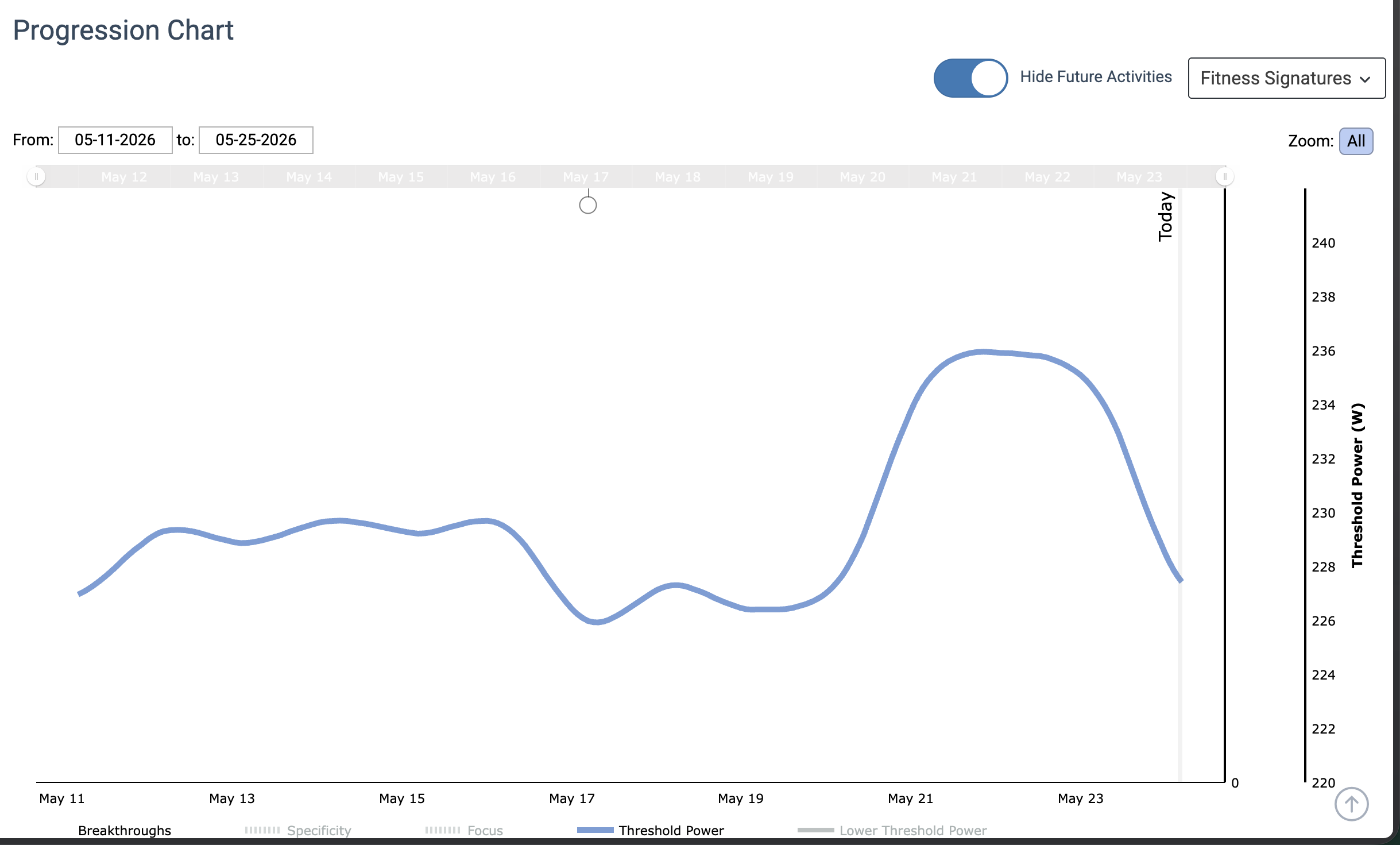

Annnnd, it’s broken again. Shaving 10pts off my FTP on the Today page…
Apparently it is some weird aberration I assume due to the timing. Maybe the “Today” page takes the FTP at a certain hour of the day and for some reason the model was showing my FTP pop up for a period of time each day but not at the exact time the “Today” page calculates the FTP. No idea why the model would show an ~+5% increase in FTP for basically 24hrs only to revert back - all while I’m doing nothing other than the structured training prescribed by Forecast AI.

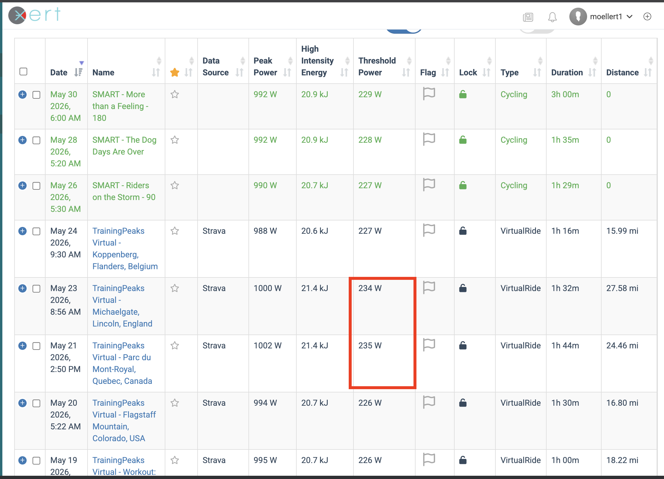

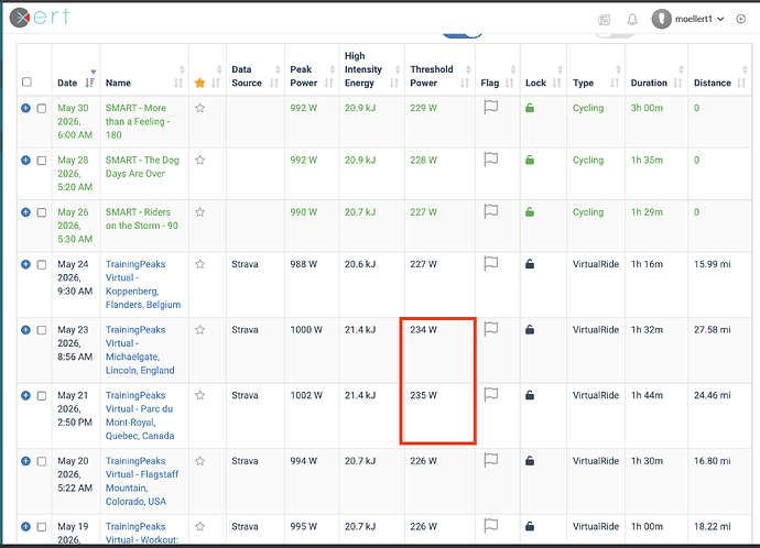

Does the variance show up on the Activities Table view?
What is Decay Method set to?
It does, see attached image. Decay is set to Optimal…
