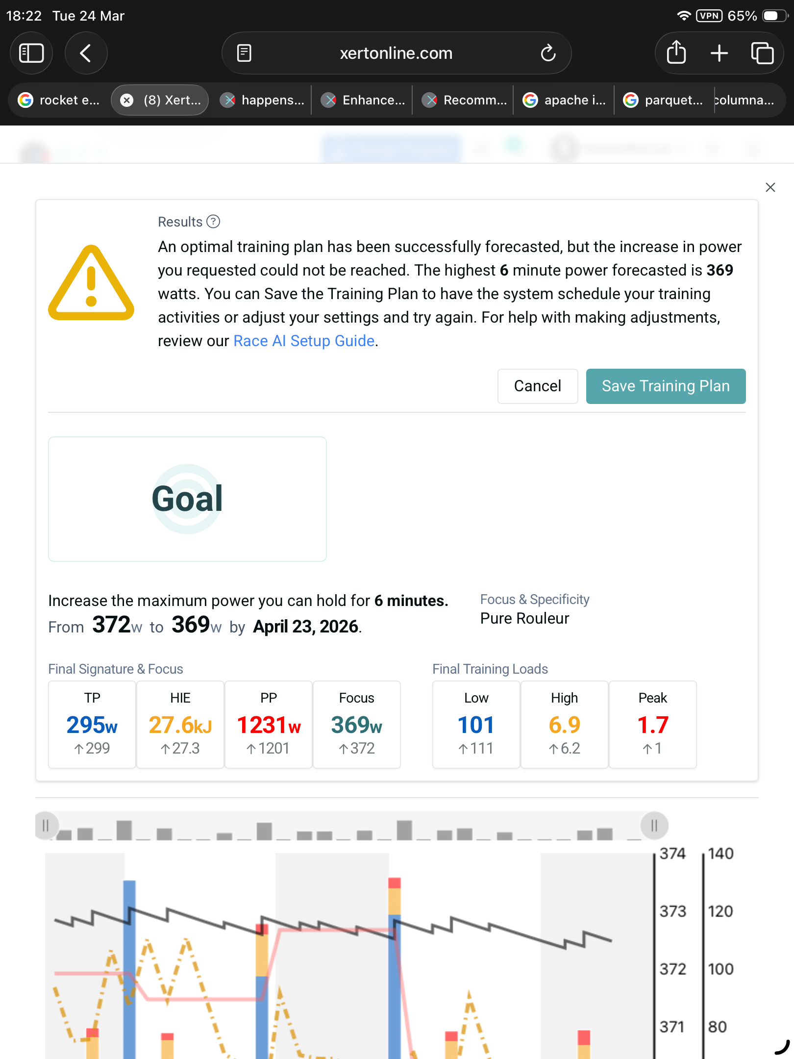

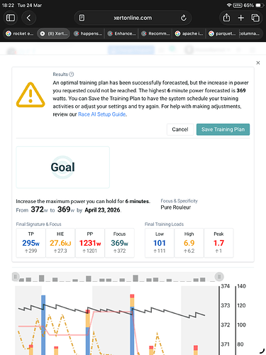

Forecast AI training plan predicts power decrease
Predicts my power will actually go down :grimacing:
Did you request a decrease? Is your availability restricting what you can do?
Give us more details so we can see why.

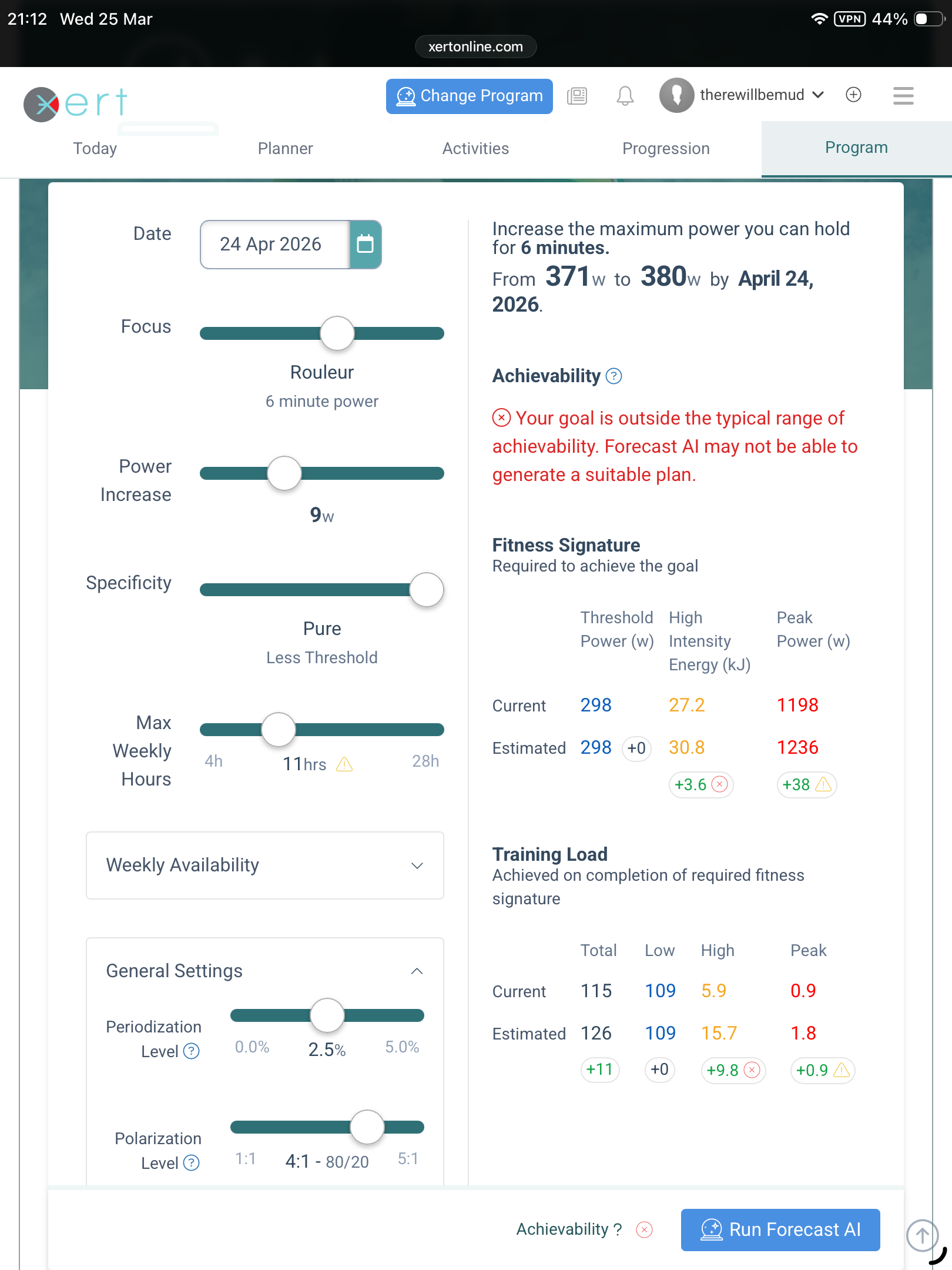

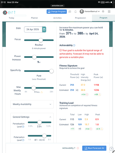

This is what I had set before clicking ‘run forecast AI’
If I set specificity to ‘mixed’, it predicts an increase, of 2w.
Try these two experiments –
  1. Set TED (target event date) to 60 days from now instead of the default 30 days out.
    Run the forecast.
  2. Set TED back to 30 days out and change Specificity to Polar and Periodization to 0.0%
    Run the forecast.
What were the results?
Specifity is the ratio between high and low, focus is the ratio between peak and low.
Specifity “pure” will need a lot more High TL than what you have (+9.8 /+ 200%). To reach that from where you are within 4 weeks, you will be too tired from huge amounts of high intensity work to keep your low TL at 109. This will lead to a decrease in low TL / threshold and 6 min power until you get used to the new ratio. You might build up again after you got adapted to your new specifity / low to high-ratio.
Availability? What happens when you slide your max weekly hours higher? You might be limited by hours.
