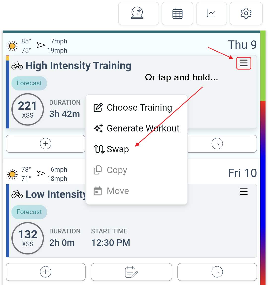

  • How can I swap training days? When I swap them, the forecast dot turns red. Then, when I start the forecast, it swaps the days back.

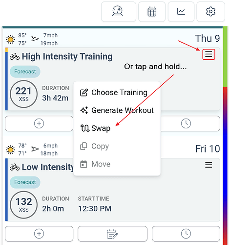

  • How can I swap a training day on my mobile phone? Drag and drop doesn’t work there.

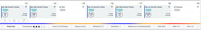

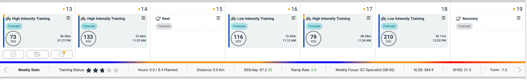

If a swap creates a broken constraint, one or more days will show a magenta matchstick.
Sometimes that is a benign “availability” issue so no need to run Adapt Forecast. The red dot will disappear after the swapped days are completed.
Other times the plan needs to be rebalanced as multiple days are affected, or form is in conflict.
To view why go to the Forecast Chart and hover or tap on any magenta matchsticks to view the warning text.

Tap and hold on the day to view options or tap the hamburger menu icon in upper right to view same, Select Swap, choose a date, and confirm.
