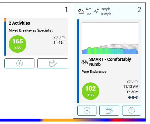

  1. If there are two activities on a day, the planner picks up the first one and ignores the actual workout. It’s common to have recorded a short warm-up or commute. Is there any way to match an activity to the forecasted/prescribed training? (image 1)
  2. Sometimes, if the activity is recorded via e.g. zwift, the planner keeps showing both the one completed and the one prescribed as “Forecast” and I can’t get it to accept that I did it.

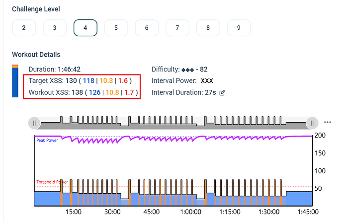

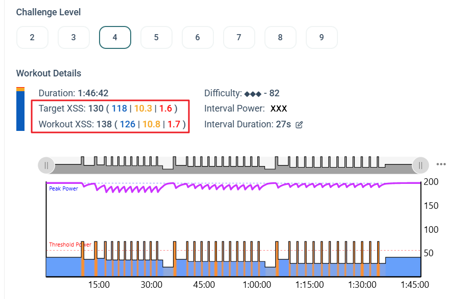

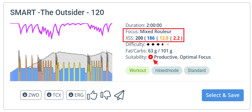

Here is an auto-generated workout has a red x but it is supposed to be optimal. I am not sure what’s wrong.

  2. Do the two entries have overlapping start/end times? (start time + duration)
    Normally a completed activity bumps any other overlapping one.
    If two activities don’t overlap, they’ll both remain on the calendar until the end time of the uncompleted one. This may not be obvious without a screen refresh.

  1. This is consistent so I will report.
  2. Turns out this corrects itself the next day. The screenshot was taken on the same day of the workout and the ride. I suspect the planner is expecting that you may do another workout. It would be nice to have an “assign” button to control this explicitly but it’s a detail.

  5. Thank you! I am still confused by some results there. See image below.
  6. I would suspect it does not which is a good thing. A fakethrough sorted it for me :joy:
Auto-generated workout not matching the goals and getting a red?!

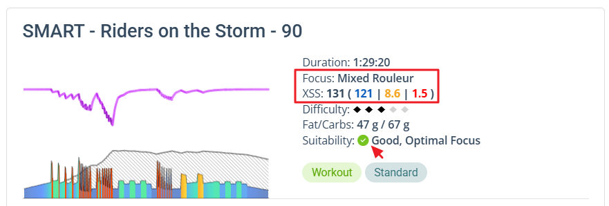

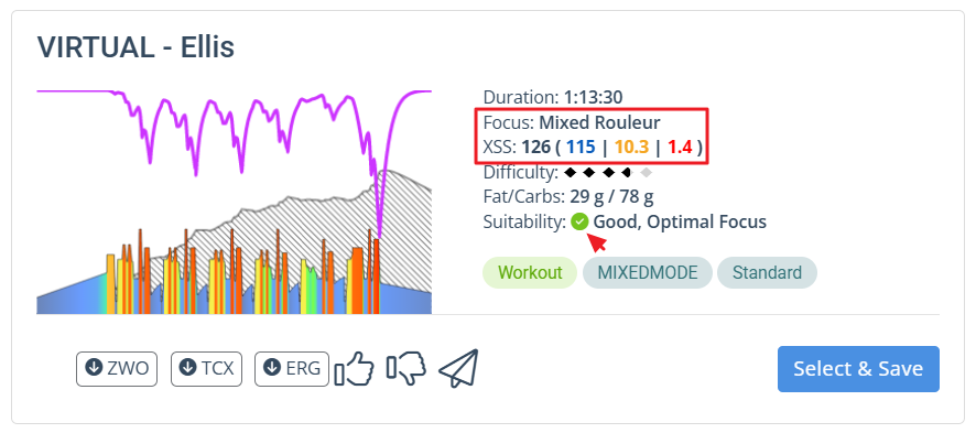

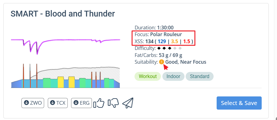

Good but out of focus with a green icon.
Hi Ridgerider2, I have followed the link to the Training suitability page, however there is no reference to the green tick, redd cross or amber exclamation. I have no idea what they mean and how to interpret them to judge which workout is most suitable for me. E.g is a red cross, very production, optimal focus a bad choice compared to a green cross, good or productive, optimal focus? And what causes a transition from a green productive, optimal focus to a amber productive, optimal focus? Any assistance appreciated. Cheers, Mike

  • Fair: Less XSS than prescribed
  • Good: The correct amount of XSS
  • Productive: More XSS than prescribed
Then
  • Optimal focus: As it says, the focus (duration and intensity of efforts) matches the prescribed
  • Near focus: Not a great match but not very far off

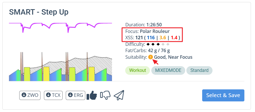

  • Out of focus: Nothing like the prescribed
I have not yet deciphered what the icon means exactly. It may be some other metric such as polarity, duration, difficulty or a combination. I am usually sticking to the green tickbox.
Someone else with better knowledge can tell us about the icon.
On a XATA program the Suitability terms apply as noted.
On an XFAI program the dot icons appear to indicate how closely a workout adheres to today’s goal.
For example, if the day’s goal is 125 XSS with a Mixed GC Specialist Focus then workouts close to that target ratio and total will display a green checkmark dot. Orange is sufficient in XSS total but out of focus. Red cross is short of the XSS goal or out of focus or both. [@ManofSteele – article update needed?]

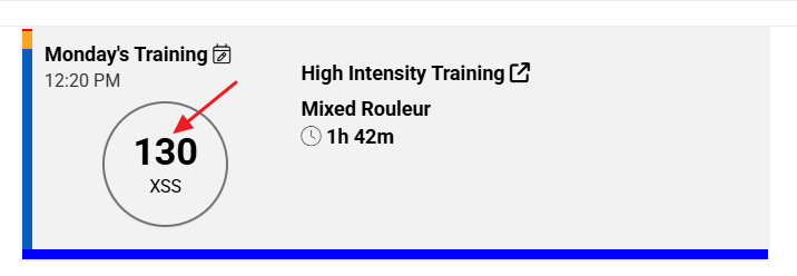

Example of Today’s Goal (tap circle for XSS breakdown) –

Note the red dot workout above is the right Focus (Mixed Rouleur) but significantly more XSS than the day calls for (200 instead of 130).
