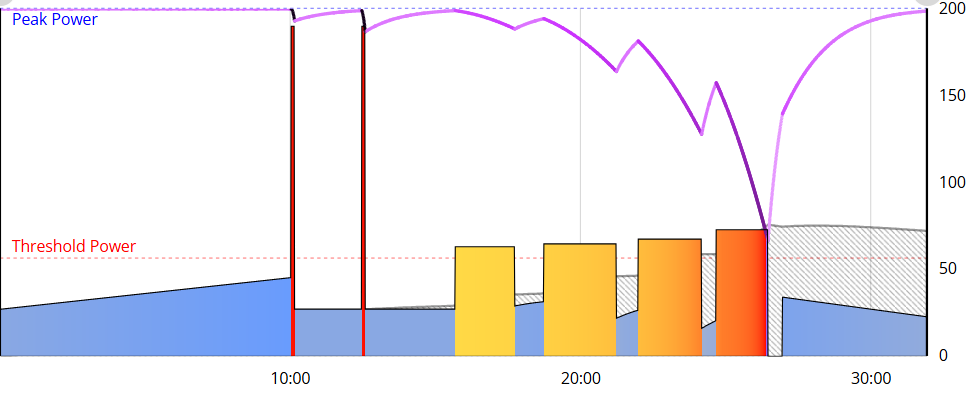

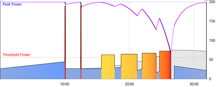

Xert’s signature algorithm analyzes maximal efforts all along your power curve to establish PP, HIE, and TP values.
If your imported history lacked a wide range of max effort data points you can ride the standard Ftiness Test workout indoors in Slope mode to validate your signature. Or generate a simiilar effort outdoors. I.e. two max sprints (7-10 secs) with full rest-in-between (RIB), then four escalating intervals >TP with short RIBs until you reach a complete failure point on the final interval.
For details see: From old trainer to smart trainer. Set FTP - #5 by ridgerider2
Four Breakthrough Types: Breaking Through the Xert Way! – Xert:
Once your signature is dialed in your normal riding activities should suffice for signature adjustments as long as they include occasional maximal efforts at various points on your curve.
There are lots of blog articles that discuss the science behind Xert.
E.g. The Science: The Physiology Behind Focus and Strain, and How To Train The Metabolic Pathways – Xert
At a high level, there is a link between PP and HIE, which is your capacity to do work above threshold (kind of anaerobic capacity even if Xert doesn’t claim to model physiology)… then, for a given max effort, the more Xert assumes you have relied on anaerobic capacity (HIE), the less it assumes you rely on aerobic capacity (TP) and vice versa. Before having an accurate PP, Xert would have been underestimating PP and HIE… I guess your HIE also increased quite a bit? And overestimating TP (which you said in your post)
