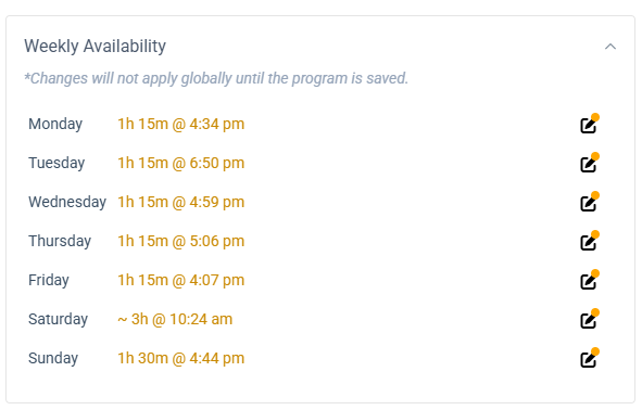

I have my weekly availability set as follows:
I dont have trouble completing punchy HIT workouts. Earlier in the year my TP bumped up to 268 after a breakthrough and I was still able to complete all workouts except those that required sustained threshold, or even within 80-85% of threshold.
FWIW, I get much better recommendations from Xert when I only use the Availability to specify a Rest Day, not any particular times on actual workout days. Whenever I do the latter, it seems to generate more confusion than useful results. YMMV I suppose as this depends on so many things. Just my experience.
Seriously consider the power meter accuracy issue, especially if you train indoors for a block (like winter, duh?) using one power meter, then outdoors using a different power meter for the rest of the time (I think this is most people, by far). Consider that your Fitness Signature is set by your outdoor PM and imagine what happens to your indoor training as a result. You can waste a lot of time and workout energy if they aren’t closely matched!
My goal there is obviously just to let Xert know how much time I have to train that day so it doesn’t suggest a 2 hour ride when I cant do that. The time of day is set to “Use Advisor”. My day off is often necessitated by work and life and therefore changes week to week so I don’t specify it. Not sure if this is better or worse that what you suggest.

Yeah, I’ve tried using the Availability that way for similar reasons - obviously that’s what it’s designed for! I just found Xert works best for me personally when I give it more freedom (doesn’t everything?)! The fewer constraints the better IME. Of course, we don’t all have that luxury so I definitely get it.
Don’t forget that if you do “free” Xert in this manner, it still provides a long list of Recommended Workouts so you can pick and choose whatever works best for you that day. I actually think this is where the real unique and powerful part of Xert lies - structured freedom? Anyway, it’s FAR more flexible than most other platforms at the very least. FWIW, I don’t think other platforms have the underlying training philosophy and metrics needed to pull this off.
