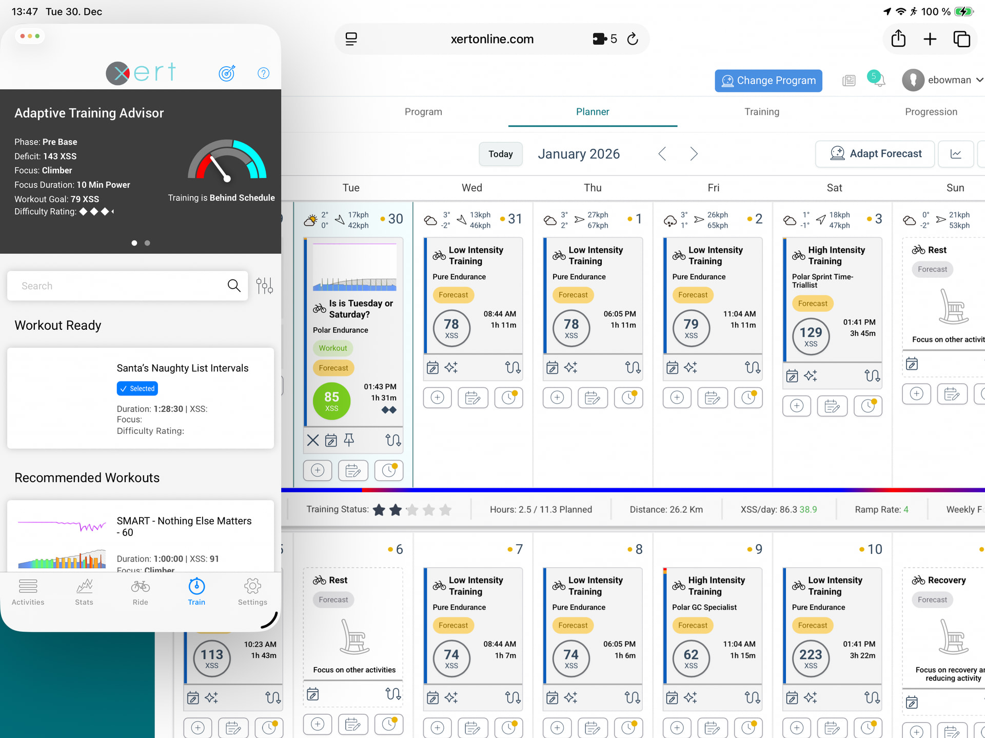

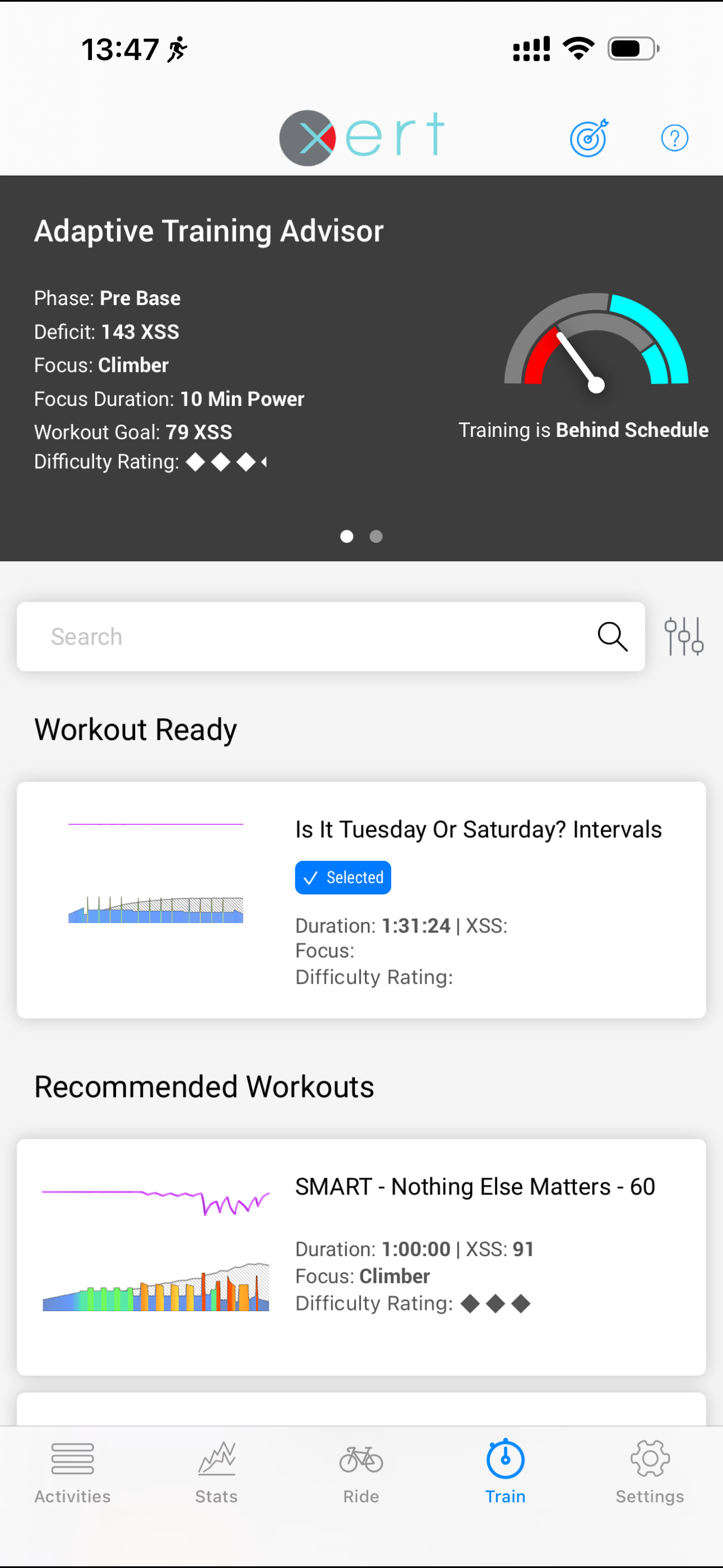

In a nutshell, the EBC app on my iPhone and my iPad sometimes shows different suggested or scheduled trainings. See attached screenshots. The expected training is “Is it Tuesday or Saturday?”, but on the iPad, it’s showing a training from a couple of days before. I killed and restarted the EBC on the iPad, even rebooted it, to no avail. (As a side note, the Magic Buckets app on my Garmin decided it was a rest day, to complicate things, but I haven’t investigated that yet.)

iPhone shows correct workout:
iPad shows correct workout in the browser, but a previous day’s training in the EBC.
Current EBC iOS isn’t recognizing XFAI plans.
An update is in progress that will add XMB and sync properly with XFAI.
Also note that anytime you run EBC (iOS or Android) the Start time of the workout determines whether it’s displayed as the selected top entry on EBC.
E.g. it the workout scheduled Start time is 1pm it won’t be shown on EBC until 12:30pm (30 minutes prior to Start).
When you select a workout on the Planner the Start time defaults to whatever time you normally train on that day of the week unless you change the time before saving.
Something else you can do is verify what’s shown on the Training page on your iPad browser before you start EBC.
There is a reported issue on file where starting EBC will recast the recommended list.
I suspect that will be addressed in the XO update that is also in progress.
Thanks, that helps. I think I wasn’t “selecting” and that seems to resolve it.
