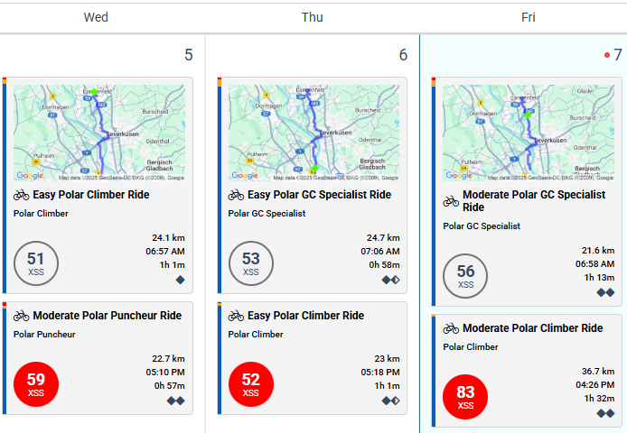

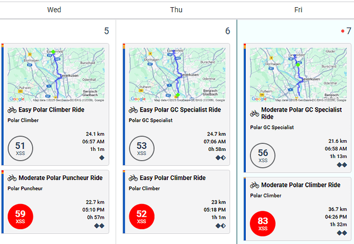

The two first images below illustrate I ride I had now in Februar when I had to stop before I reached by target because it was getting dark and I had some family commitments. The remaining XSS were therefore done on the trainer after dinner. The third image shows an alternative way of visualizing this in the calendar.
So, how does it work today?
Let’s assume I have a target of 200 XSS (ignoring High and Peak XSS for now). If I complete 150 XSS during my first outdoor ride, I’ll see a red or orange circle indicating that I haven’t reached my target for the day. If I then hop on the trainer after dinner and complete the remaining 50 XSS, I get another activity in my calendar, but the red or orange circle remains. However, it would make more sense for the calendar to show a green circle for the day instead.
If you turn on the “Summarize days with multiple activities,” you’ll see a green circle, but the individual activities will be hidden. Of course, this makes this feature less usefull.

If you upload multiple rides to Xert, then the first one will be matched towards the Forecast item. So if the goal was 100 XSS, and you did 50, you will get a red circle. If you do a second ride at the same day, that will give you a new item, but there is not target for this. So even if they total to say 100 XSS, the planner will show a red circle (unless you use the aggregate setting in the calendar).
Good question.
You are correct that it is just cosmetic. Note that the situation is complex since in some cases two activities are to complete the daily forecasted training and in other cases one is for training and the other is for another planned activity such as a commute. Automatically assigning incoming activities to the appropriate forecasted or planned activity isn’t something the system does at the moment

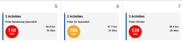

has anything happened on this topic? Or are there already plans to account for multiple activities per day? I complete my workouts during my daily commute to work. Unfortunately, Xert only ever considers one of my two rides.:frowning:
But maybe I’m thinking about it the wrong way, and it simply doesn’t count if I turn a 120-minute workout into two 60-minute sessions

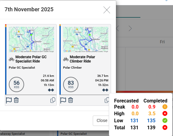

on the Planner page go to settings (wheel picture in top right) and click Summarise days with multiple activities. it will combine the scores to give you a total for the day.
Thanks, that looks better, even though I wasn’t able to reach my daily goals
Xert has finally calculated the summary of both rides, but it still flagged the date in red even though I reached the goal (at least in my opinion).
Was the issue here the peak and high efforts that weren’t forecasted?
Yes
