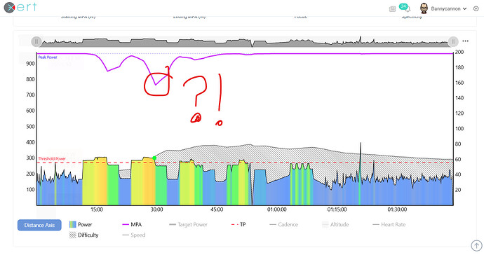

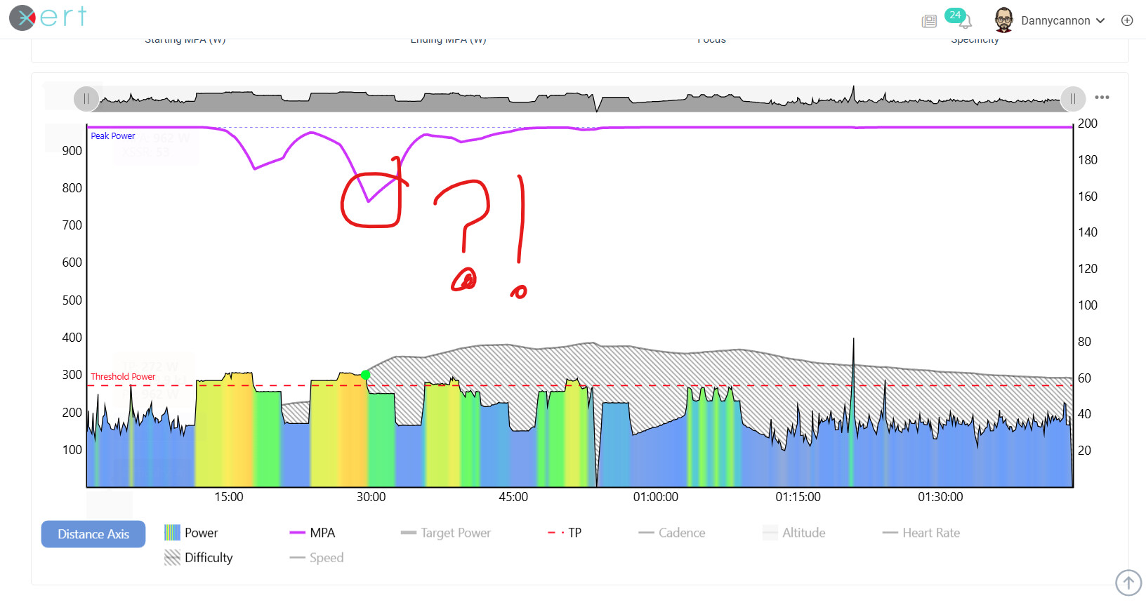

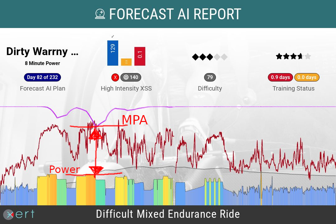

It happened again today. Blasted my MPA for over a minute today, same thing! The Xert MPA line is nowhere near my actual power output!!!
I have a video showing me holding it for over 10s+, of which the two MPA & Power Outputs then come together as the same (250w) for about a minute after. Shae I can’t upload a video.

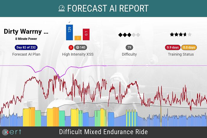

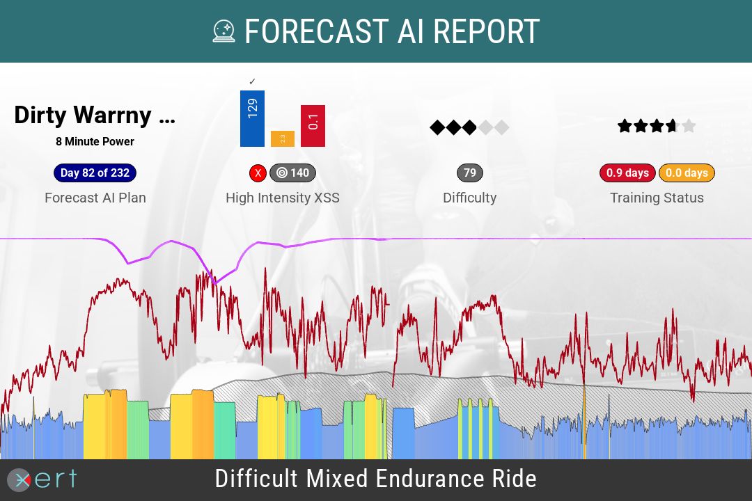

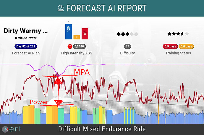

Note the difference in teh MPA line in the first photo, with red markup, compared to the FORECAST AI REPORT (Strava upload). The latter still shows a BT, whilst the former is miles off.
Could someone from Xert kindly review & advise?
Theres nothing in the Forecast AI Report that indicates a breakthrough. It looks exactly the same as the first photo.
Hmm… Something sounds not right with the setup. Are you using the MPA & Power data field for ConnectIQ? Did you enter your Xert user/pass into the ConnectIQ data field settings? If not, the data field will use a generic/default signature with a TP of 250, rather than using your unique fitness signature. Given your TP looks to be higher than 250, I’m guessing that’s the issue.
Check out this support doc and follow the steps under Signing Into the Xert Data Fields

I reckon you’ve hit the nail on the head! I’ll look into this & report back. It was reading 250, so that should hopefully be it. Thank you!

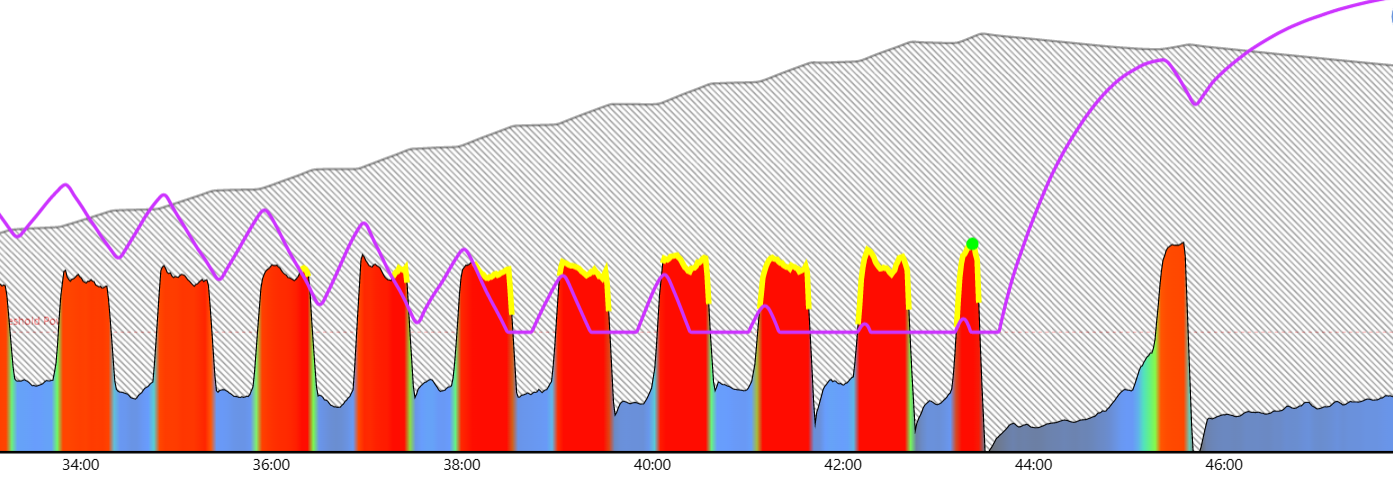

To view your BT details (where MPA was exceeded or flatlined) select the Previous button below the Activity’s power chart. Example:

As you know, for a breakthrough the MPA line need to cross the power graph. That is not the case in your last photo.
