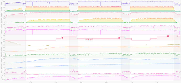

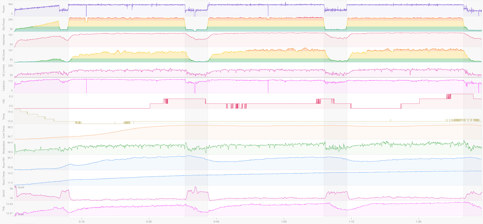

Below is a VT2 3×26 min workout I completed. You can see that VE and BR (respiration) stabilize at the same level in each interval, which suggests that I’m operating right at (or just below) VT2.
