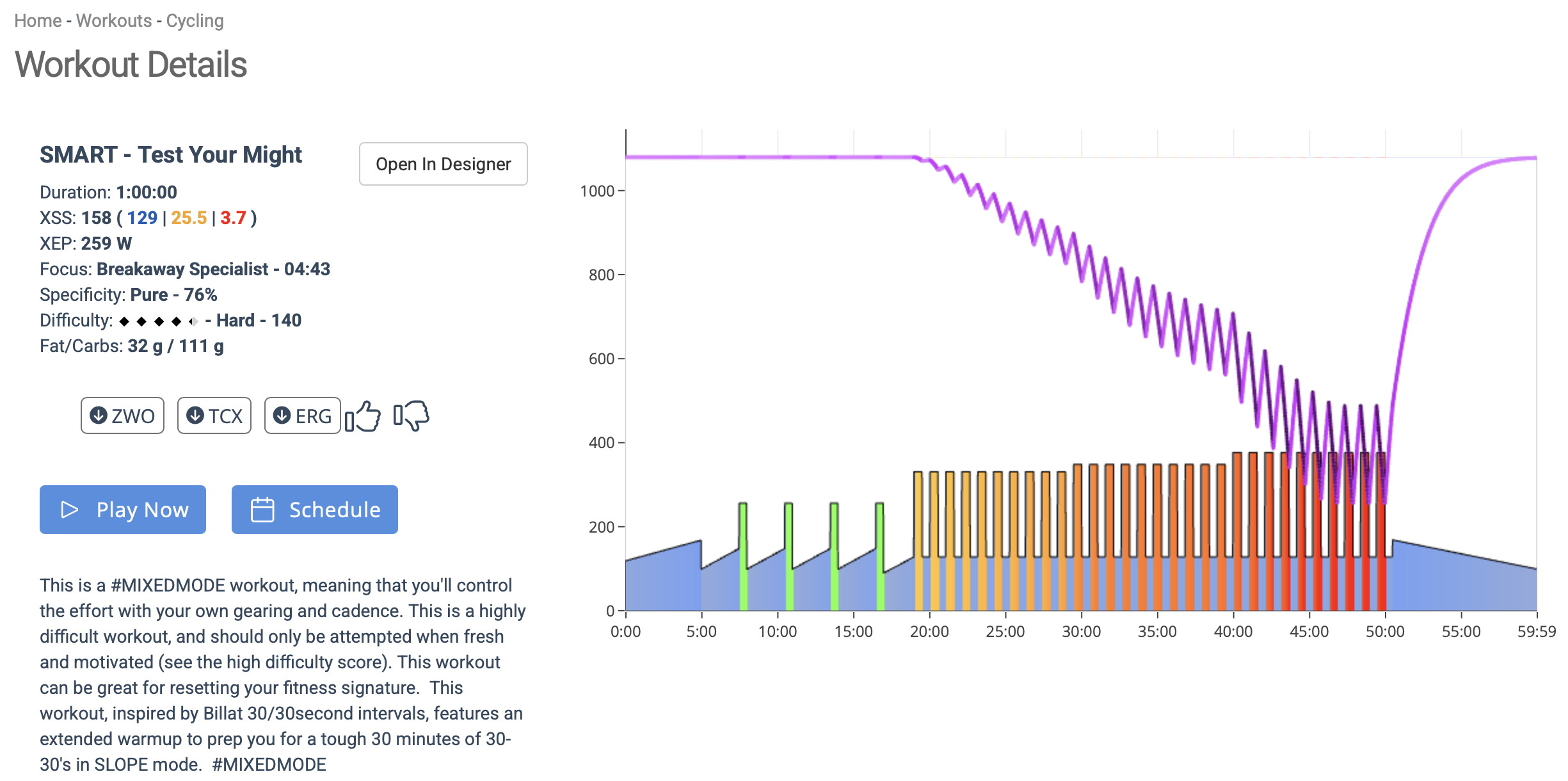

Workout looks right in xert, does not look right when used in zwift
In xert, I scheduled Smart break on through to the other side. I also downloaded it as a .zwo file.

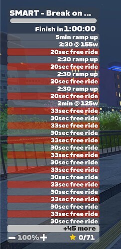

Instead of 30 seconds at 400 watts or whatever, and then a rest interval of 30 watts, I get this inside of zwift. I’m sure there is some esoteric thing I am missing. If anyone has an explanation, please let me know and please don’t use any xert acronyms in the explanation. Thanks

Other apps don’t allow you to set a target power & free ride. Most of these types of workouts include near maximal efforts that aren’t well suited for ERG mode, so they’re exported as Free ride to other platforms (but they don’t include the power target). I’ve tested a few of these in Zwift and found the best way to do them was to disable ERG and use my gears (or virtual gears) to ride hard for the red intervals, ride easy for the grey/recovery intervals.

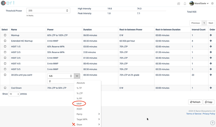

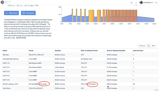

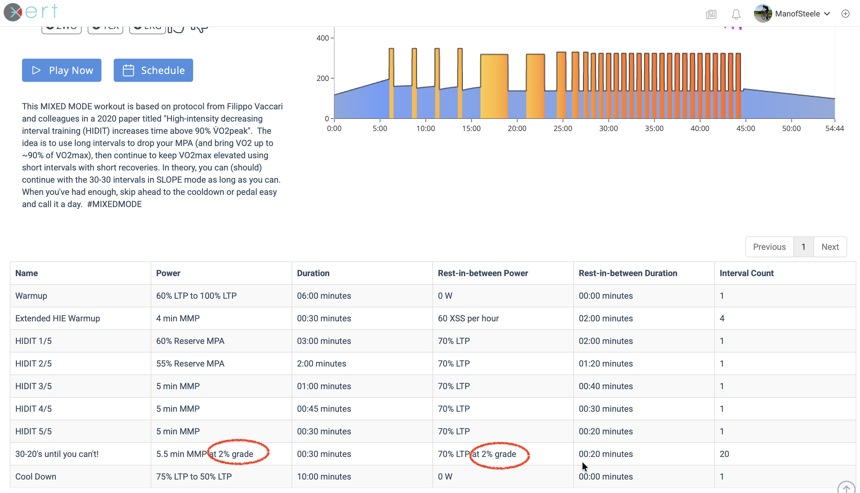

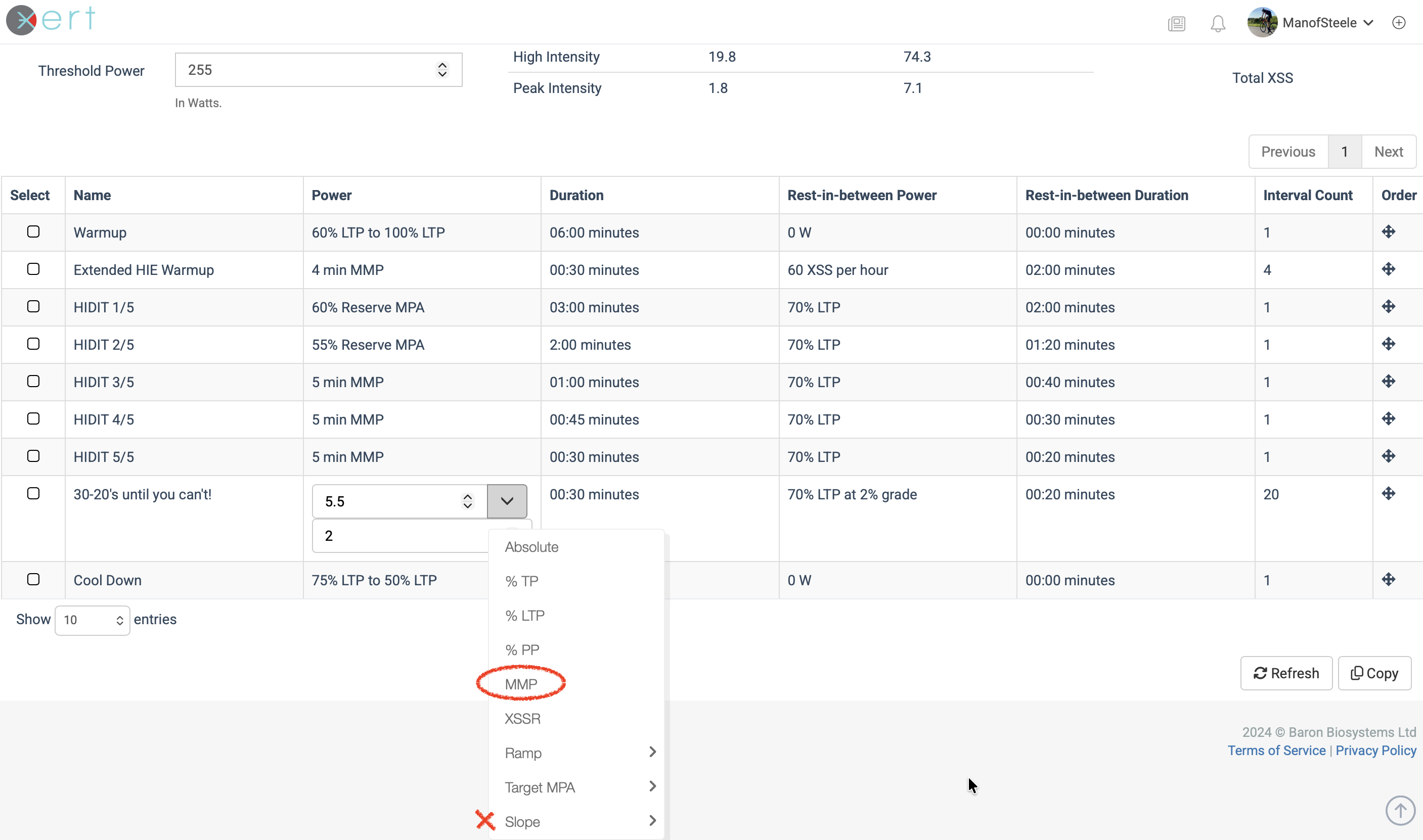

If you’re doing the workouts on rollers anyways (hardcore!), then trainer mode won’t matter for you anyways, so you could make a copy of the workout and modify any intervals that use ‘at _% Slope’ - heres your example:
In this case, modify the circled intervals above to use ‘5.5 MMP’ for work interval and ‘70% LTP’ for recovery interval (the default library uses Slope > MMP & Slope > LTP for this workout):

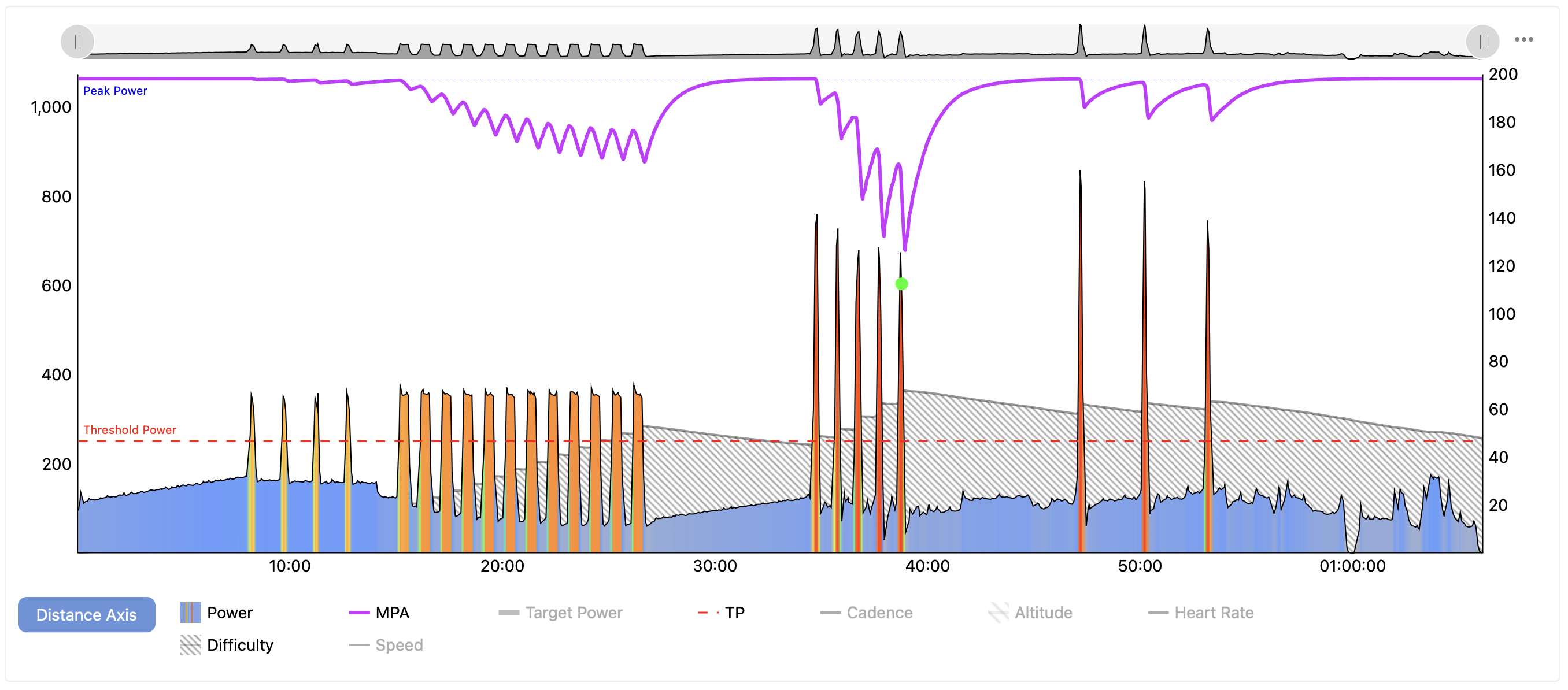

This option worked quite well for me (see below). You can tell where I disabled ERG mode - about ~35 min through this workout, once I got to the sprints.
This was the SMART - Basket Case - 60 workout.
