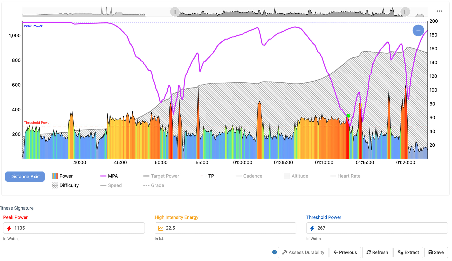

I was thinking back to one of the ZRL races from this past winter that included two ~6-minute climbs up Box Hill (MPA chart below). I never did any dedicated 6-minute intervals all winter.
Instead, I mostly raced on Zwift and used XMB on my high-intensity days. Before the race, I looked at my signature-derived power curve and knew that, starting fresh, I probably couldn’t sustain much more than ~330 W for 6 minutes (assuming my MPA was fully recovered at the start of the climb). So I paced the first climb around 315 W and the second around 310 W, stuck with the lead group over both climbs, and finished with the front group in a sprint finish (admittedly near the back since I’m not a strong sprinter):slight_smile:
Would some dedicated 6-minute intervals beforehand have helped? Maybe.
But I also think this demonstrates something interesting: If your Fitness Signature accurately reflects your capabilities (at least above threshold), you already have a pretty good idea of what you can sustain… even if you haven’t recently trained that exact duration.
Historically, I suspect that athletes & coaches would discover that number by having you do 6-minute intervals to discover it through trial and error. Perhaps this is where you’re coming from? But Xert predicts your performance from your fitness signature. Plus, if you start your ~6 min interval with more fatigue than you thought, the race plane/estimated effort is likely out the window anyways.
What do you all think? Is there still unique value in matching interval duration exactly to race demands, or is accumulating strain on your 3 systems & knowing what you’re already capable of enough?
